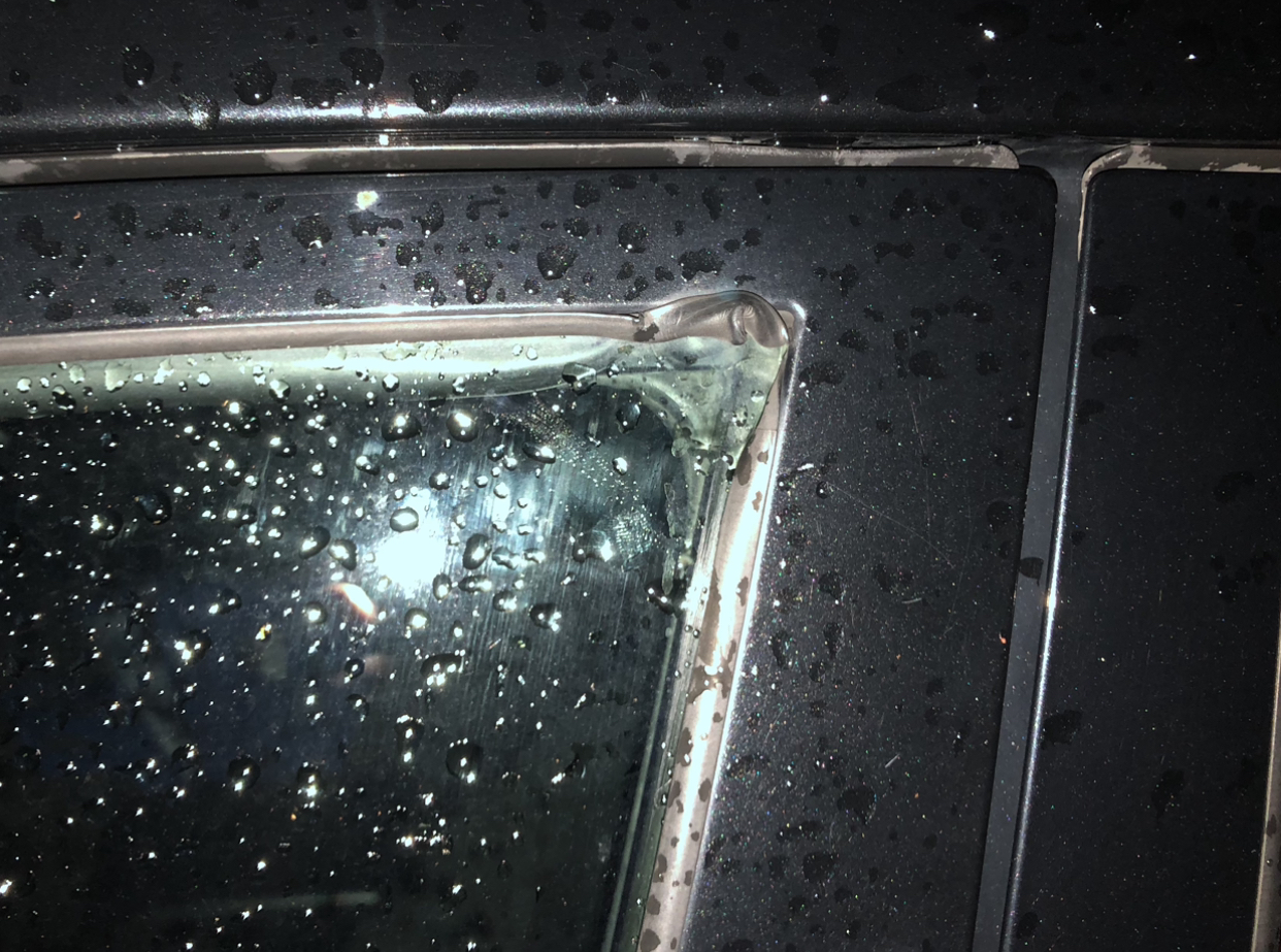

Curious what your seals look like currently? I have a bad drivers side seal also on my 2004 Vibe Gt but just living with the wind noise for now. Don't know how the seal got messed up in the first place (only owned the car for 3 years and came with this damage) . Post pics of yours if possible. Thanks ;)
I only have the corner issue, not the one closer to the mirror, but my corner is quite bad and has been as long as I can remember (at least since 2008 or so, it’s an 04). It really does just whistle in my ear, which finally got a bit too annoying. Here’s a picture (sorry that it’s dark out):
My passenger side has it in the corner too, more similar to the size problem that yours has on the driver side.
If you’re looking, I found my prices at Conicelli Toyota for a total of $155 for both. Not cheap, but I’m hoping it will be worth it!
I’m going to try the “dunk it in a bucket of soapy water and slide it in” trick to install. Though I’m thinking maybe I should open up the door panel and figure out why my window sometimes goes cockeyed when I try to roll it back up...
Edit: not sure what I was thinking, but I do have the wrinkle closer to the mirror too, on both sides. It doesn't seem quite as bad as yours, but it's definitely there.
