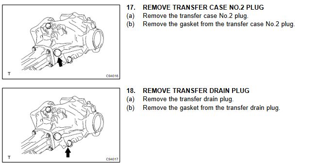

knmens wrote: ↑Fri Jun 30, 2023 7:08 am What pictures?
Here's a portion of the matrix repair manual, out of a very long PDF on transfer case overhaul. However, this shows the location of the two plugs necessary to change the xfer case oil
remove the #2 plug, which is the fill hole. Remove the drain plug and drain the oil. When drained, replace the drain plug. Fill with oil through the # 2 plug till it runs out, (assuming the car is on level ground) then replace the #2 plug

Excellent photo addition joatmon.
Great job!
