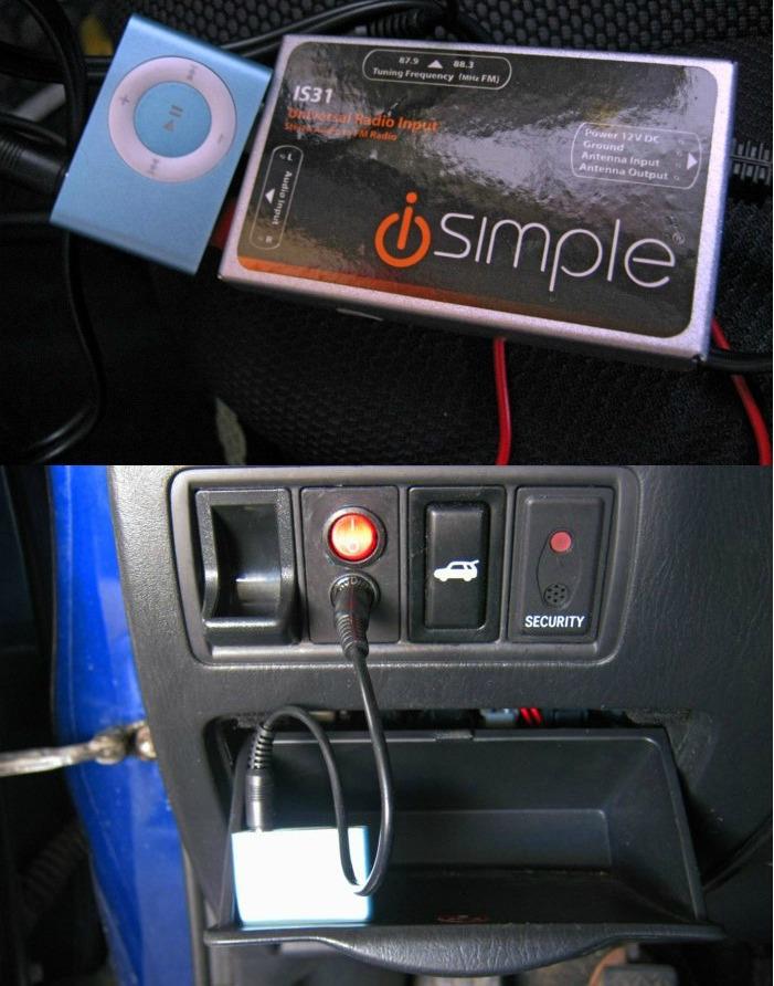

I ended up going with a hardwired FM kit. I had to also get some antenna adapters.Overall it works good enough for me, I will say it's not the best sound quality, but it is one of the easier methods that doesn't require too much skill or take up that much space.
