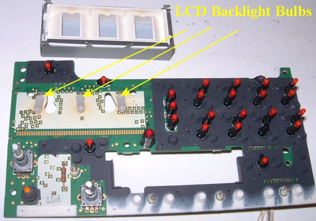

This shows the front of the circuit board with the cover removed. You can see all the lights for each of the buttons, but the LCD backlights are still hidden behind the LCD. (On mine a couple of the little white bulbs along the bottom row are burned out, but I'm not sure what bulb to put in there.)
Re: Radio lights going out (joatmon)
To get to the LCD backlight bulbs, you have to remove the LCD. In the previous picture you can see a metal housing around the LCD, it has six tabs that fit through the circuit board and are bent to lock them in place. In order to remove the LCD to access the backlight bulbs, you have to straighten the six tabs as best as possible. They have to be straight enough to slide through the small slots int he circuit board.Once you have the tabs bent straight, you have to pry the LCD and metal cover off, pulling these six metal tabs through the circuit board, so the better you can straighten them, the easier it will be. I used a pair of needle nose pliers.This pic shows the back of the circuit board small with a red box on it, and below that is a larger view of the area in the red box, with the six tabs indicated

After you get those six tabs straight, then gently pry the LCD up and off from the front. Do it in little steps, working around. This pic shows the front of the circuit board, after the LCD has been removed. There are three bulbs, each soldered to the circuit board. The bulbs themselves are clear glass, but each has a tiny white rubber condom over it. Mine has a small amount of heat discoloration on the circuit board around the bulbs.-
Now, the question is what bulb to use to replace them with. I do not know. There is another thread here that says to use a 12V 100mA bulb. The only place near me to get a solder-in bulb like that is radioshack, and they have a 12V bulb about the same size, but it's specs make me think it would not be bright enough. I did a lot of looking, and so far what I think would be the best match for what is in there is an 8640 bulb. (do a google shopping search for 8640 bulb) I thought about ordering some.
I also thought about ordering some 2162 bulbs, which are rated at 10,000 hours. In the end what I did was go to the local auto parts store and bought two two packs of "74" bulbs. They are a wedge base bulb, but there is enough metal wire in the wedge base to bend it to fit the holes for the stock bulbs. These 74 bulbs are "T 1 3/4" size, a bit bigger than the bulbs I took out, but still fit ok. They were too big to fit the little white rubber bulb condoms on. (I think the 8640 bulbs are the right size, perhaps T1 1/4, the 2162's are the larger T1 3/4 size)
So without embarrassing myself by posting pics of amateur soldering, I'll just say that you can unsolder the failed bulb, and solder in the replacement. You might consider, if one failed, how long till the next one fails. I replaced all three. Then it is a matter of putting it back together, which is -

Thank you for the step by step instructions. Your explanations and posted pictures made tearing apart the radio a lot of fun. It was really not hard to do. My biggest problem was using the soldering iron and electrical solder. It did not look real pretty but it worked. Getting the old bulbs out took a little time. The "74" bulbs work extremely well. I replaced all three bulbs. Thanks again for your help. Without your step by step instructions I don't think I would have tackled a job like this. It really was quite easy.

Used the 12v 60mA bulbs from Radio Shack. Looks great. I cut the old bulbs off right when the wire leave the glass. The old wire is much stronger than the wires on the new bulbs. Made is real easy to locate the new bulbs in the same location as the old.I did create a small jig to hold the bulbs while soldering. A piece of cardboard with 2 parallel toothpicks(used 1 toothpick broken in 2). The 2 glued toothpicks were gapped so that they created a craddle for the bulb so that I could keep the bulb steady and the leads level. I put the bulb between the toothpicks, set the craddle and bulb on the circuit board, put it where the leads were touching the old wires, and soldered without a problem.Thanks for providing the info. Made this radio fix very easy.
