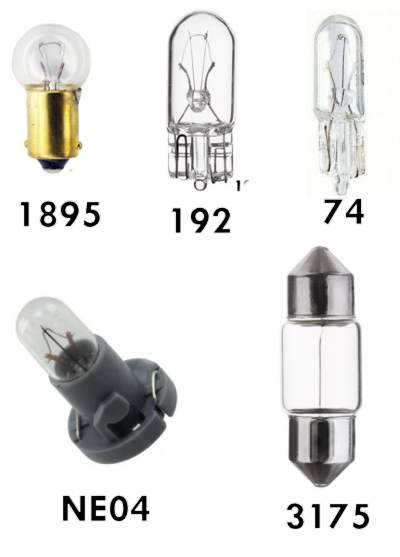

Interior light bulbs for first generation (2003-2008) Vibes
Roof-Mounted Map Light - Moonroof Bulb Style = 1895
Mirror-Mounted Map Lights - No Moonroof Bulb Style = 192
Center Dome Light Bulb Style = 31mm x 10mm Festoon (8W)
Rear Hatch Area Bulb Style = 31mm x 10mm Festoon (8W)
Note: These 31mm x 10mm Festoon seem to cross reference to # 3175 bulb
The bulbs that light up the D-for drive. #74 bulb
The bulbs behind the HVAC controls are a NEO4
This image shows the bulbs, but they are not to scale with respect to each other
