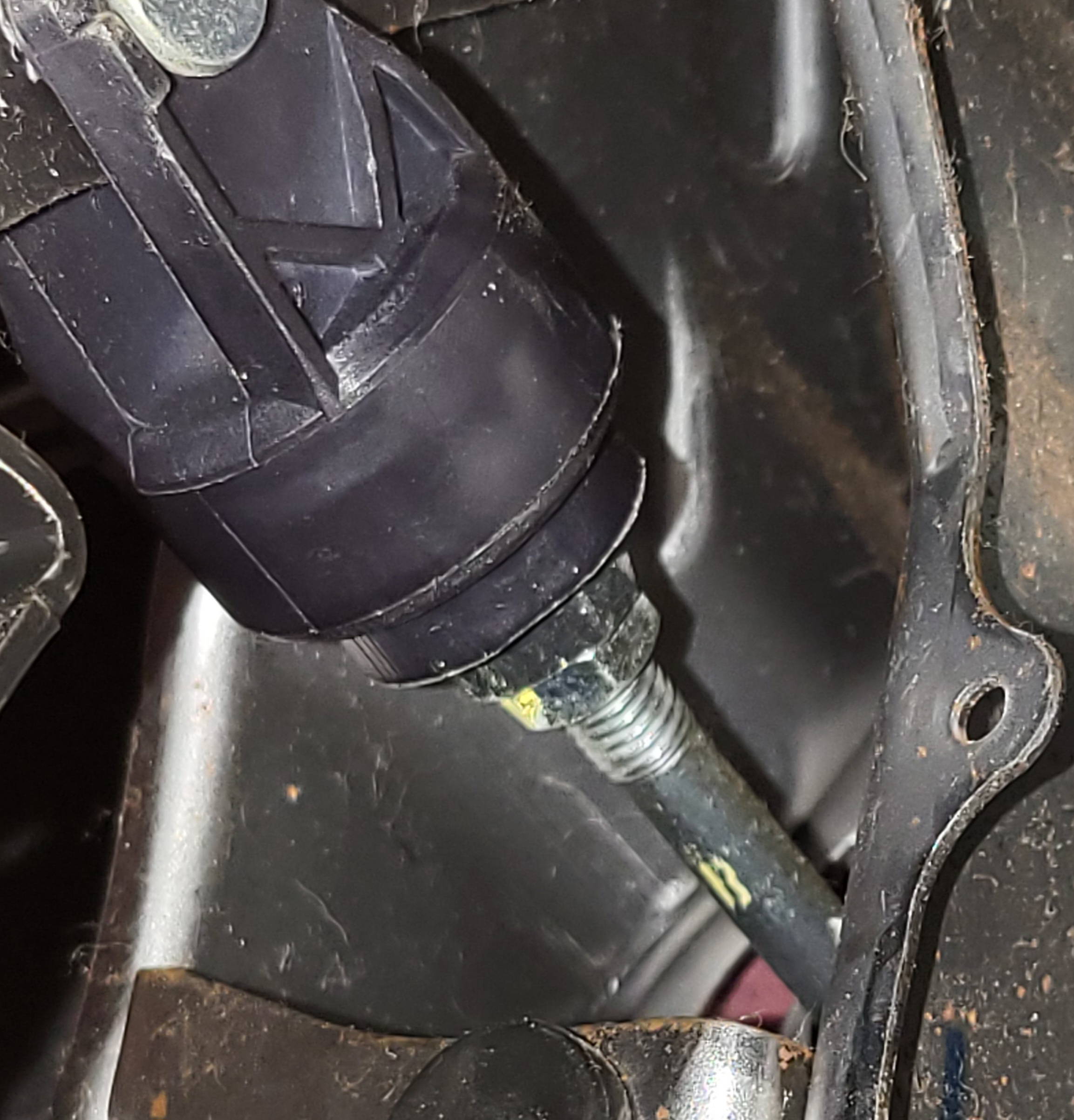

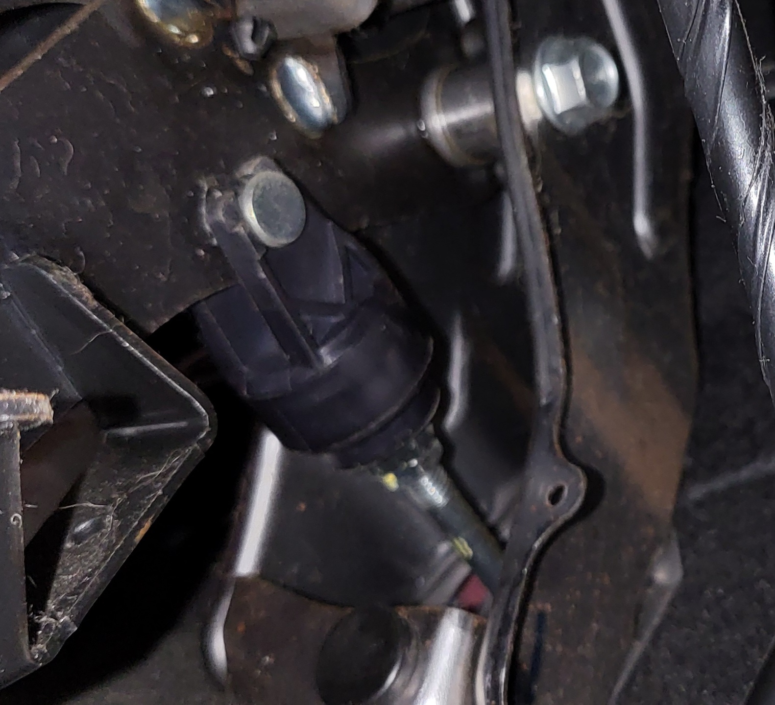

Uhm really old post, but I'm basically having this exact problem. 2009 5 speed vibe, and my clutch doesn't engage until the pedal hits the floor. Starting, 1st gear, and reverse are semi impossible to get into without grinding because the pedal has to be 98% depressed 😤
How the hell did you get the plastic assembly off without cracking the lock nut? I'm 99% sure mine has yellow locktite on it (as do multiple other nuts under the dash), and the plastic coupling is definitely flexing hard even for the quarter turn it will go. I see it's supposed to have a cotter pin bolt on the coupler, but mine seems to have a metal bolt with nothing (I can feel) holding it in on the opposite side facing the wheel. I assume if you could remove the cotter pinned coupler, you could simply twist the cylinder and reattach to the pedal.
Do we even know if it's clockwise or CCW to loosen the lock nut? Mine seems to just stop no matter which way I turn it.
