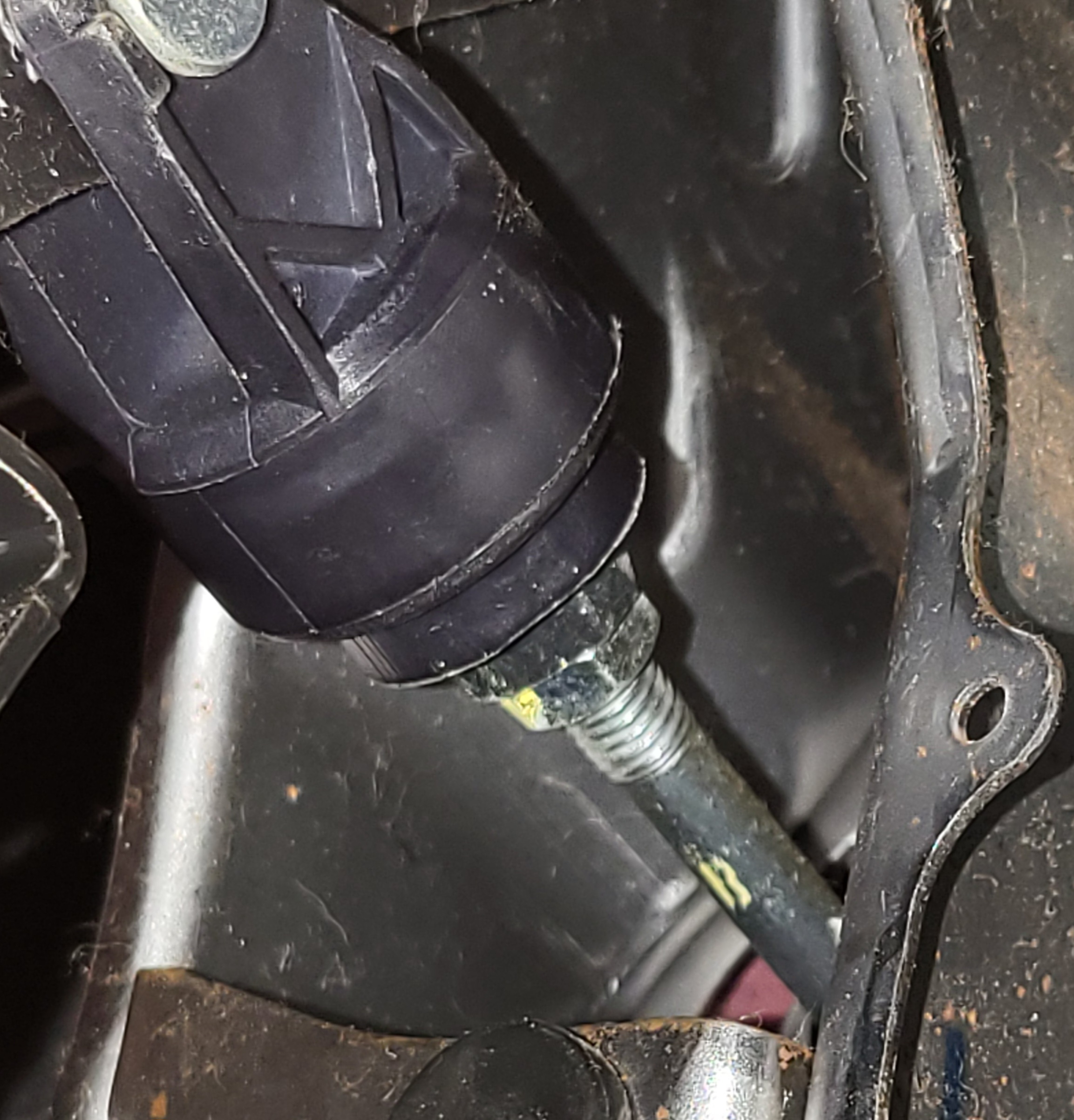

I replaced the clutch with LUK clutch set. Everything went well. Now, the clutch seems to engage as soon as I release the pedal (less than 1" of the floor). I'll bleed the clutch, but any adjustment in the clutch cable for this issue?

It’s a hydraulic clutch, no cable. That being said, if it’s anything like my 03 there’s an adjustment rod up under the dash between the pedal and the master cylinder

If the locknut is so tight, don't force it because you could break the plastic coupling. Detach the master clutch cylinder from the pedal and spin the plastic coupling counter-clockwise by hand then you will able to turn the locknut.
I had the free play reduced by spinning the plastic coupling (on master cylinder) counterclockwise, attach it to the clutch pedal then tighten the locknut. Clutch engagement is OK now.

Uhm really old post, but I'm basically having this exact problem. 2009 5 speed vibe, and my clutch doesn't engage until the pedal hits the floor. Starting, 1st gear, and reverse are semi impossible to get into without grinding because the pedal has to be 98% depressed 😤
How the hell did you get the plastic assembly off without cracking the lock nut? I'm 99% sure mine has yellow locktite on it (as do multiple other nuts under the dash), and the plastic coupling is definitely flexing hard even for the quarter turn it will go. I see it's supposed to have a cotter pin bolt on the coupler, but mine seems to have a metal bolt with nothing (I can feel) holding it in on the opposite side facing the wheel. I assume if you could remove the cotter pinned coupler, you could simply twist the cylinder and reattach to the pedal.
Do we even know if it's clockwise or CCW to loosen the lock nut? Mine seems to just stop no matter which way I turn it.
