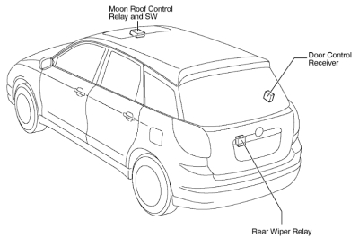

One of those sources was the 03 Matrix service manual, which shows the receiver location in this pic
I can't find any definitive source for the location in a Vibe or Matrix, but given the similarity to other Toyota products, there is this youtube video for an 03-08 Corolla
https://www.youtube.com/watch?v=Sf_SaOyGAGU
If its in the same place, then that would put it behind the trim panel above the one that you removed at the junkyard.

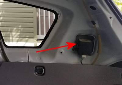

While typing this, I had an idea, and checked:
In viewtopic.php?f=28&t=47447 crispbacon posted a number of excellent photos of his Vibe interior with the trim removed. I grabbed one of them, cropped it, resized it and drew an arrow to what I'd wager is the receiver.
In http://forums.genvibe.com/phpBB3/viewto ... 28&t=47447 crispbacon posted a number of excellent photos of his Vibe interior with the trim removed. I grabbed one of them, cropped it, resized it and drew an arrow to what I'd wager is the receiver.
I got one from a junkyard a while ago from the location you showed in the picture and I took the entire inside of my car apart to do some work and replaced the part and it fixed the issue, I had to get a new fob like a few days after though for some reason it was weird idk if it didn't like the new module or something 😂😂 but my receiver finally receives now
