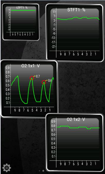

I took some PCM readings with Torque and it seems the second/downstream O2 sensor is reading high when ilding, around 0.75-0.8V. I also have high-ish short term (4-7%) and long term fuel trim (4%). Not sure how to interpret this downstream 02 reading.
When revved to about 3.3k rpm, the second O2 voltage does come down to 0.1, upstream 02 is still changing a lot, the short term trim changes around between what looks like -5 % and +1 %, long term trim is still 4%.

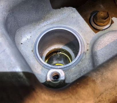

First the spark plugs. Yes, anything I touched in the past is suspect! :) However, I found nothng wrong, torqued to spec (18 ft lb), and noted they all tended be in pretty clean environments. See photo.
spark plug clean.JPG (56.31 KiB) Viewed 5905 times

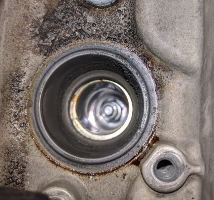

However, I did note they had some oil seeping where I think the valve cover gasket is. Am I right? Would this warrant a change of gasket? I think you can see this in the photo below:
spark plug oil.JPG (33.69 KiB) Viewed 5905 times

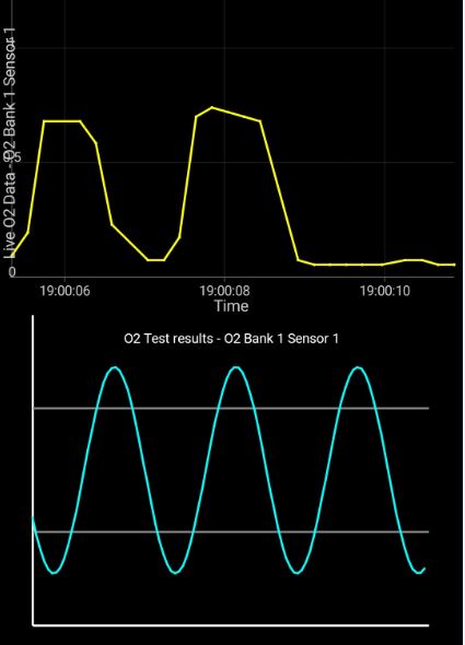

Now, the 02 sensors. There are apparently several ways to log this behaviour with Torque. One is real-time data, then there is a Test mode for 02 sensors, there is a graphing feature, logging feature, and a plugin called realtime charts or something similar. I don't know how accurate these are, seems the highest resolution is 100ms. I think the O2 sensor works but may be "lazy" or "slow" but I don't think any of these are definitive.
Here are two plots. First is from the realtime data
O2 realtime.JPG (41.67 KiB) Viewed 5905 times
this one is from the 02 test:
O2 test.JPG (32.39 KiB) Viewed 5905 times
Does it look like the voltage doesn't go high enough?
Might this be a setup issue with Torque, a question of scaling?
Is it perhaps not fast enough?
I could try to change the O2 sensor, but I don't want to randomly start replacing things.
