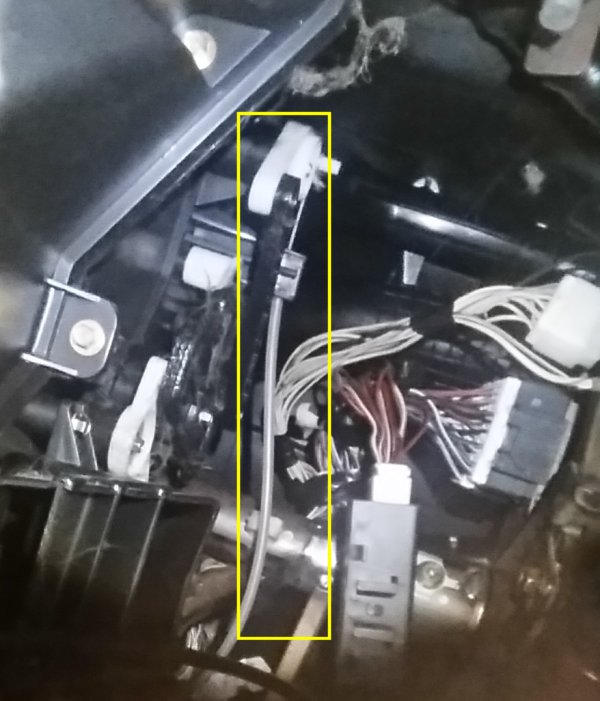

One end of the cable is connected to the back of the HVAC controls. Once I tried and failed to remove the HVAC controls, I couldn't figure out how to disconnect the two cables from the back, and I may have broken part of the one of the two cable retainers. Mine still works, but it might come undone someday. Since you bought the car used, and it seems to have always had the problem, perhaps the previous owner had some work done such as trying to remove that to replace a light and whoever did it was as inept as I.
The other end of the cable is attached to the driver's side of the airbox, roughly straight up from the gas pedal. Here's a pic looking up from around the gas pedal, the yellow box shows the cable attached to the plastic arm of the door.
- modecable.jpg (65.12 KiB) Viewed 3517 times
It's possible to reach up there with one hand and use the other hand to rotate the mode selector knob to verify that the moving the knob causes the plastic arm on the door to move. If it doesn't, then there is a problem with the cable, either broken r disconnected. If the knob moved the arm and it has no effect on the airflow, then there's something unpleasant inside the airbox, a disassembly and repair task that I don't envy
