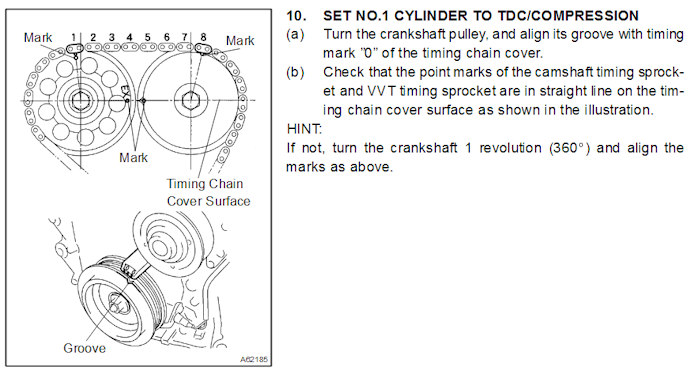

Where the file cip1346.pdf is saying about checking the timing of the camshaft in relation to the crankshaft, here are the timing marks for the 1zz-fe engine.
cam timing 1zz-fe engine .jpg (93.24 KiB) Viewed 5370 times

Ok here is an update. I took the valve cover off and started turning the engine over by hand and the timing chain would up the teeth and would get loose. So there is something wrong in the timing chain. Will the valves and piston hit each other?
