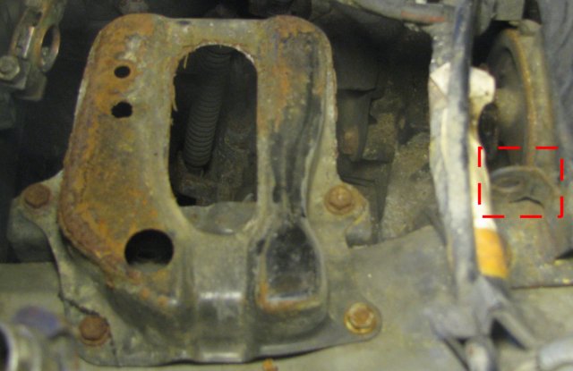

Before you order any more parts, compare your 03 Vibe to this pic of my 03 vibe taken from the front of the vehicle. I have the battery and the plastic battery tray removed to show what's underneath
Notice that the hole where the J-bar hooks on to is actually part of the motor mount (well, technically a transaxle mount) under the air filter box. The bar goes down between the air filter box and that horizontal cable bundle
The battery tray support is fairly minimal, however, if your car doesn't have one, the battery would fall to where it would hang from the cables

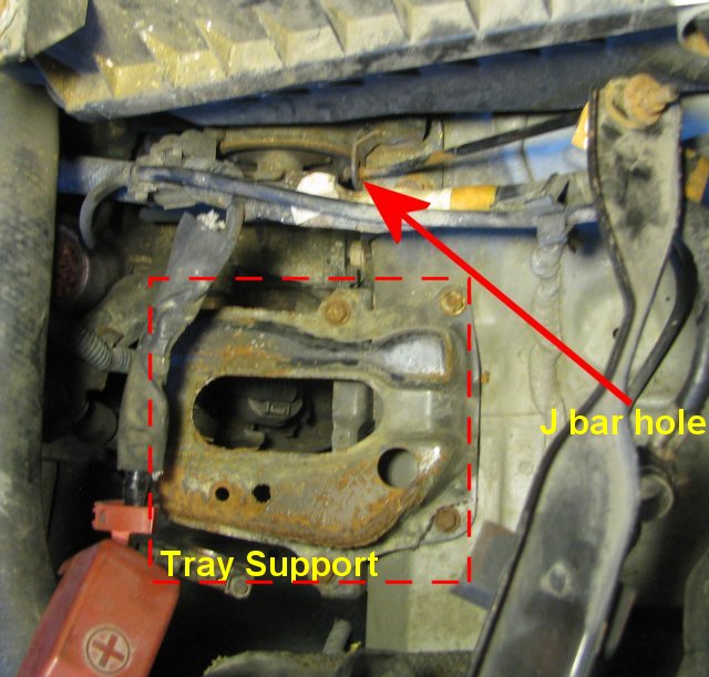

Here's another pic, taken from the side
That hole for the jbar is apparently non-intuitive, as I and a number of other people had significant trouble finding it, so if its there and you didn't notice it, don't feel bad, sucker got me and bunch of others too.

Thanks for responding and with pictures! That helps alot.
When I put the new battery hold down bracket on and tightened it up to the frame, it was approximately 1-1.5" taller than the top of the battery. I looked down behind the battery for a place to put the j-hook and didn't see anything there. I ended up putting the j-hook on the motor / trans axle mount, like you have suggested, as it seemed like the only place I could use. Unfortunately, when I tighten the nut all the way down on the j-hook, I still have that 1-1.5" gap between the battery hold bracket and the top of the battery. The battery and the tray underneath will slide around unless I put a piece of wood on top of the battery. Looks kind of nasty and not sure what it does to the structure of the battery long term.
I will pull the battery and tray out tonight and double check for the battery tray support.
Thanks again for responding and for including the pictures. (BTW - You engine bay is too bad at all. I have seen a LOT of engine bays that were dirtier than yours is over the years. ;) )

Despite the rain last night, I was able to check and I do have an existing battery tray support underneath the battery. Thank you for the picture as the diagram image does differ from the real thing ("Your results may vary" I guess is the operative phrase there).
