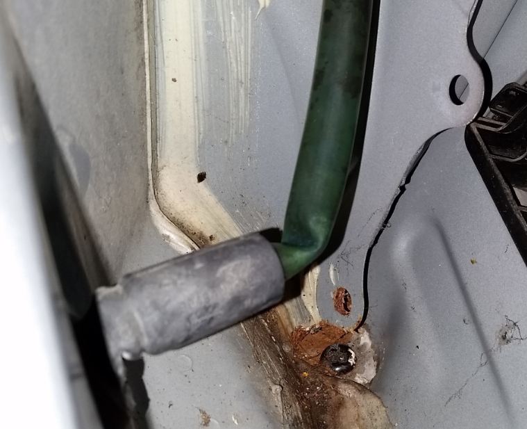

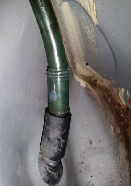

Here's the pics...
This area is accessible once you open the spare tire compartment.
If you have a similar problem to mine, be sure to check and make sure these drains tubes are properly channeling water out the drain port and that there's no kinks in the tube.
Thanks again for the help.

Thanks for the post! I have had this problem for at least 7 years and have been trying to trouble shoot it. I have a 2003 Vibe and we first noticed the back right passenger carpet was wet and sudsy after a car wash. I thought it was from the bottom blast jets in the car wash, and it may have been. When I looked underneath, the rubber plug at the bottom of the floor pan was missing. I went to a junk yard and picked up a couple of rubber plugs from a Vibe that had been totaled. I put it in place and thought I was done. At different times the carpet would get wet again in different situations. My daughter took the car to college so I was unable to watch and monitor it regularly. She would say it got wet on occasion. I looked at it multiple times in the summers when she was home. I was unaware there were 4 drain plugs in the sunroof area. I kept the front two drains open. I was told it was probably water intrusion from failing seams in the floor pan area or wheel well when driving in rain or on wet roads. I recently purchased her Vibe and drove it back from Texas at the end of 2016. Yep, in the 21 hour trip home we hit rain and wet roads and the back right carpet got wet. Thanks for letting me know there are 4 drain holes in the sunroof! Knowing that and looking at your pictures under the spare tire cover tray, the hose on the right was not only kinked but the black rubber drain connector was also bent at a 90 degree angle. The left hose was perfectly aligned, so the left carpet was never wet. Makes sense. I tried to unkink the right hose but the kink had been there so long it had a lot of "memory." I put a hard plastic tube over the kinked area of the hose so it would not ease back to its kinked state. I also rerouted the drain hose to the black connector so it connects vertically (instead of horizontally like it was). To make sure the hose was clear of kinks, I snaked a zip tie up from the drain hose behind the wheel and it had no resistance and I could see it through the clear plastic drain tube. I can't wait to try it in the rain and report back. See attached photos. Kevin
Kinked Sunroof Drain Hose
Vibe Hose Kink.JPG (68.04 KiB) Viewed 7916 times
Sunroof Drain Hose Fixed
Vibe Hose Fix.JPG (38.58 KiB) Viewed 7916 times
Re: Water leak passenger side - 2003 Vibe with Moonroof
Posted: Sun Jan 22, 2017 8:56 pm
by vibrologist
Excellent, Djkevin!
It might be a good idea to remove the carpet from the car for a good washing and drying and a cleaning of the floor pan. Trapped water may have started rust right there. It's not hard to remove the carpet I have done it.
