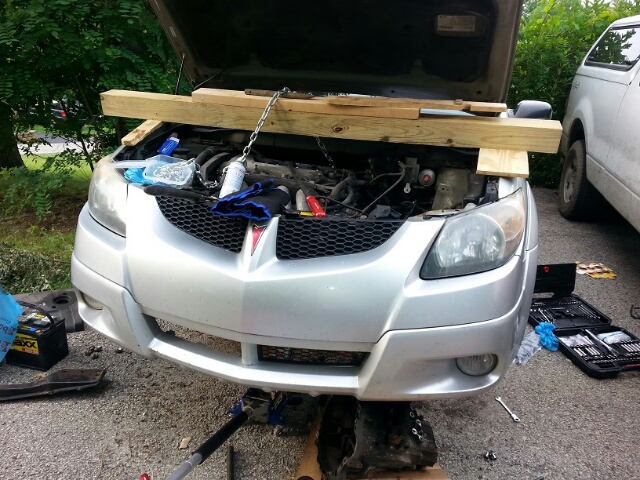

Good luck! I just did this job a few months ago. Take your time, make sure you disconnect everything before dropping the tranny, careful stabbing the tranny back into the engine that you don't tear up the passenger side axle seal. Replace your rear main seal while you're in there. Fel-pro is $10 from advance.
An engine hoist and tranny jack would be very helpful. If you don't have either, this is what I did to hang the engine. You don't want to keep the jack on the oil pan cuz it will cause leaks... I put some cut bicycle tire tube pieces between the fenders and the wood to keep from scratching and sliding.
And just drop the tranny onto your chest so it doesn't break hitting the ground... I put some cardboard on my chest, haha. It's only about 90 pounds.
