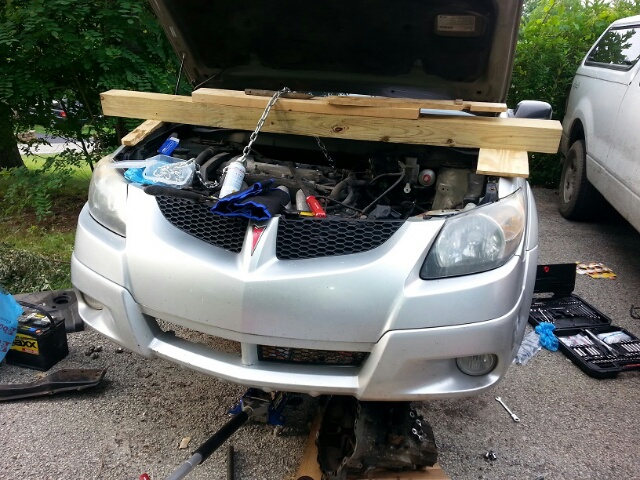

I balked at the 8 hour job time estimate, but it turned out to be pretty spot on. I broke it up between two days cuz the dang parts man ordered me the base model rear main seal even though I told him I needed the one for the gt, the 2zz, the 6sp, the 10%, not the base model, not the 5sp, not the auto, not the 1zz, not the 90%. Parts guys - they just think they know more about your car than you do!
Thanks for the info. I read on Monkey Wrench Racing that they recommend the Pennzoil Synchromesh for street cars, and a Pennzoil/ Redline MT90 blend on street/strip cars. I'm thinking a blend might be best on mine.
http://www.monkeywrenchracing.com/produ ... ts_id=1352" onclick="window.open(this.href);return false;
I'm probably going to do the tear down over 3-4 days after work, and maybe take 2-3 days to re-assemble it unless I get some help this weekend. I could do my Mustang in about 4-5 hours, but that is one of those practice makes perfect situations!

More stuff!

I used the same clutch kit, but just had the flywheel cut.
My old clutch had failed premature too. I bought the car with the transmission "issue". It wouldn't go into gear at all and had to be towed. Turns out the clutch was improperly installed somehow and had broken and one of the springs had popped out. Maybe that'll be your issue too!
Take pictures!

Got it tore apart!
And the reason it failed - totally blown friction material on the pressure plate side:
It is some kind of Korean clutch made by Seco. Probably a cheap POS clutch, that the shop charged $326 for!
I'm going to call the shop that did the work and let them know how this clutch failed after only 12K miles. Not like I expect them to do anything, but they should know how this POS part failed.

Well, the car is back on the road! I borrowed a tranny jack from a friend and got it installed yesterday. Took it for a long drive today, and the front felt weird. It was see sawing back and forth, and moving right on acceleration, left on deceleration. I hit a speed bump and the clunk made me realize that I had not torqued down the passenger side strut bolts!!! :shock: All torqued down now and it runs better. But I still need to get it back on the highway to make sure.
Boy this clutch is touchy! But it grabs quick, for sure. Now to degrease the undercarriage and put the splash shields back on. Total cost was about $275, including the parts, tow dolly, lube, loctite and cleaners. Yay!
