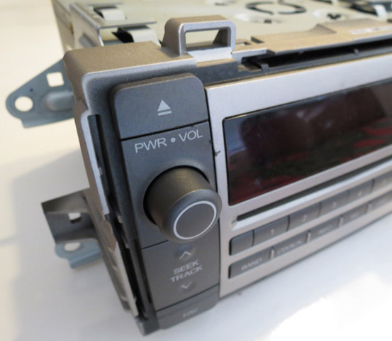

As many 2009-2010 Vibe owners know, the volume/tune knobs on the radios have been a problem. If you are under warranty you can get it fixed (refurbed radio under warranty).However, if your like me you are out of warranty. The knobs do not simply pull off like most cars. The faceplate holds the knobs in place. So, I decided to pick up a cheap used radio from a 2009 vibe off of ebay and try and fix it myself. My original radio was in better shape than the used one hence the reason I didn't just put the used radio in the car. All in all it was far easier than I thought it would be!First, be very careful. The job includes removing a number of small screws on the radio itself and trust me, there tiny! I won't go into detail on removing the radio from the car as it's pretty easy. Pop off the trim panel (there are no screws), unhook the hazard button and the passenger seat belt light (one wire on each. They pop of easy). Then there are four screws holding the radio in. After that there is the antenna wire and two harness sets going in the back of the radio. The antenna lead is a bit of a push in and pull kinda' thing. Do be careful with the top of the trim panel! The top hook is kind of "J" shaped and could break easy. You need to lift up on the bottom of the trim and "lift and pull".Ok, now the fun begins:-) On the sides of the radio there are four screws. Simply remove them. After that there are two clips on the top and two more on the bottom of the front bezel as it attaches to the rest of the radio. Be careful and pry the front face plate off. As you pull the front face off you will see one wire attaching the face to the radio. This just pops off. Now the front face should be free of the rest of the radio. On the back side of the face plate you will see about 12 very tiny screws holding the electrical board in. These are a a pain to remove and you are dealing with the board so take you time and be careful. Once these are out the board (witch is what the knobs are attached to) will simply pop out. At this point you can simply take off the broken knob and replace it with one from a used radio that you take apart in the same fashion. The volume and tune knobs are the same so if you buy a used radio you will have a spare knob. When putting the face plate back together you need to make sure that the four plastic "plungers" on the backside of the seek/scan buttons stay in place. These like to fall out.At this point reverse the process and enjoy your fixed radio! I found the plastic inside the knob was broken causing the knob to just spin. No loose glue as many have speculated. If I can figure out how, I will be attaching a series of photos that I hope explain all of this. It took me about an hour to fix mine. Having now done it once, I could probably do it all again in about a half hour from beginning to end. It sounds harder than it is. If you can get a used radio for cheap ($60 in my case) it sure beats paying a dealer to fix it or buying a brand new radio if your out of warranty. Hope this helps!

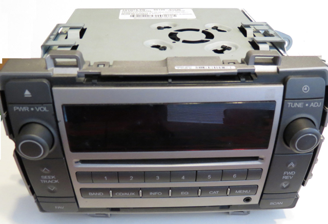

Re: Fixed my 2009 Gt broken radio knob! (DuluthVibe2009)
Posted: Mon Sep 20, 2010 10:09 am
by DuluthVibe2009
Another photo...
Posted: Mon Sep 20, 2010 10:11 am
by DuluthVibe2009
photo 3
Posted: Mon Sep 20, 2010 10:13 am
by DuluthVibe2009
photo 4
Posted: Mon Sep 20, 2010 10:31 am
by vibenvy
Nice writeup ! I have yet to experience this problem, but I know it will help out many others here that have.Just out of curiousity, do you think it would be possible to just put some adhesive on the knobs and get them to work properly? This would obviously be a much cheaper fix than buying a used radio.
Posted: Mon Sep 20, 2010 10:34 am
by DuluthVibe2009
You probably could try glue. My only worry about that would be making a mess out of the pegs the knobs go on to then having an issue down the road. But it could be worth a try.

I just fixed my wife's 2009 Vibe following these instructions. I bought knob GM# 19204643 from my Pontiac dealer. Cost 6.95. Instructions are good. I would add a couple of hints. 1) the 12 screws on the back plate are six sided. I thank it takes a 3mm socket (most sets only go to 4mm) I used pliers to remove when I couldn't find the right socket in my town(small)a mini wrench set similar to the mini screwdriver set would work. When I put back the 12 screws I had computer screws and replaced the 12 screws with philliphead screws, much quicker. 2) When you are pulling the wire off the the face plate (red/black wire) be extremely careful. It did not come off easy; and when I pulled with enough force, it bent the prongs ( the plug slipped on). When I straighten them, they broke off!! Doomed I thought! Soldered them back on; it worked.3) When you put the radio back in, make sure that the to wires that plug to the grey trim are on top of the radio so you can get to them easy. If you don't, you have to take the radio out again to get to the wires. Should be a 30 min job if nothing goes wrong. If not 1/2 a day like me.
