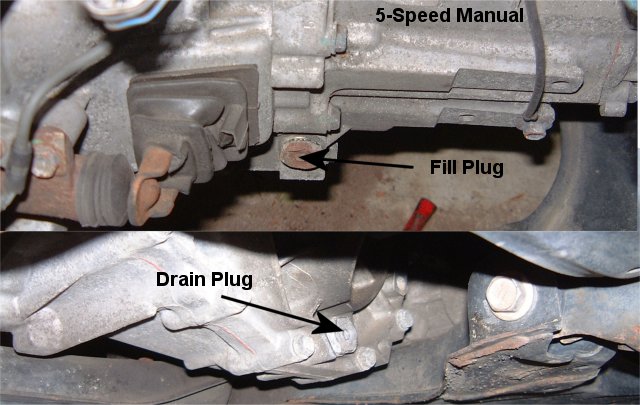

... is there a drain plug?
This pic shows the drain and fill plugs on my 5 speed manual tranny. Perhaps the actual plug bolt may have changed over the years, but the location shouldn't have. On mine, both were a 15/16" (which is perhaps 24 mm, but I didn't have a 24 mm socket) Fill plug shown from above, looking down from the front of the car, the drain plug shown from below, looking up from in front of the front drivers side tire
Supposedly the drain plug is in the same place on the GT's 6 speed, and there is a plug in the same place as the fill plug on both, but the document I have indicates the GT 6 speed fill plug is further to the right, beyond what is shown in the picture, more to the drivers side. probably roughly about the same height.
