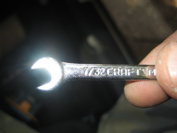

I just recently went through the fix for this part and have the following suggestions.
If you can wedge your hand over the motor and you have a good sense of touch, don't take the dash out. That sounded like a huge task. Luckily I don't have large hands and I am used to working by feel alone.
1 - use a 5.5 or 6 mm wrench to loosen the top screw, bottom seems to work with 1/4 drive ratchet. I used a 6 after my 5.5 disappeared behind the blower motor. a box end would have been great, not sure if those are made.
2 - keep the blower flap closed while you work, so the wrench doesn't fall on your cabin air filter or worse, into your blower fan blades, if you take the filter out like I did.
3 - figure out a way to secure the wrench so you don't loose it. I tried to tie bell wire around the handle, but that didn't work. Maybe a long rubber band string would have been the answer.
4 - mark the position of the white gear from the outside before you disassemble. makes it easier to mate to the flap's shaft when you put back in. You don't have to be perfect. The motor turns until it feels resistance.
5 - check out what is broken inside. I had a broken tooth on my large white gear. rotate 180 degrees worked well. I also had a broken pin holding one of the interal gears. There should be two black plastic pins that are molded into one side (none are loose) and one loose metal shaft. I didn't notice and reinstalled only to notice it didn't fix anything !!! I carefully drilled a hole through the case where the shaft broke and replaced this with a cut 8D nail. I used epoxy to glue the nail head to the outside of the case so it wouldn't move. Shaft and nail were roughly same size.
6 - use a 5.5 mm socket to back out and hand tighten the screws. Only use the wrench or ratchet for the final few turns. Very easy to overtighten bottom (turns forever). I did that but left as is. Not sure if it will back out over time.
I did this replacement by touch only while sitting in the seat. It was possible, although frustrating at times. If I had been uner the dash looking up, I would have noticed that the bottom screw was fully seated and stopped turning the ratchet.

tothebone wrote:Removing the actuator is a problem because the fasteners have tiny little heads and you can't use a screwdriver. Luckily, I had a tiny open end/Box wrench that fit perfectly. DON'T ATTEMPT THIS WITH OUT A WRENCH LIKE THIS! a ratchet probably wouldn't fit in there. Here is what I used:
I had the misfortune of doing it this weekend. Everything I tried to get the upper screw out would not work. This suggestion by tothebone saved the day, the use of a Craftsman 7/32" ignition wrench.
Note that I did not have to take off the dash. The wrench had enough clearance inside the dash to rotate the screw 1/6th turn at a time. Slow but got the job done.
Since the pic he posted no longer exists, I have attached it here.

Baltovibe wrote: Tue Jun 24, 2014 7:42 am
Thanks. I’ve been putting off this repair. Hoping to do this under the glove box.

Thanks. I can feel all the bolts but that top one is going to be tricky. I have a mini 7/32 wrench that might work.
