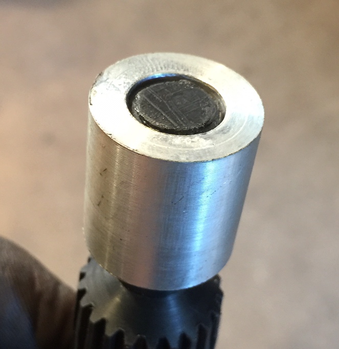

I know this is an old thread but I just did a clutch in a vibe so I assume many people also still are. Plenty of great info here. I ordered a Luk brand clutch because in the pic of the kit it showed two alignment tools. One for a car with a pilot bearing and one that was intended for the vibe with no pilot bearing... however the kit only came with the one that doesn’t work for the vibe. Since I have a small lathe in my garage I was able to make a piece to adapt the alignment tool to work with the vide. I know not everyone has a lathe. But maybe there is another way of doing this. Just thought I’d post what I cam up with. I made it out of aluminum and just glued it to the end of the alignment tool.
