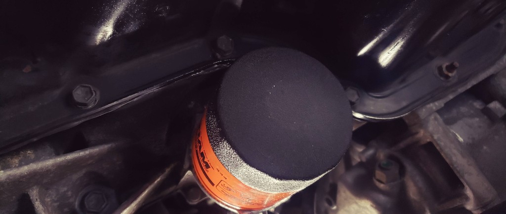

The other day I decided it was spring oil change time. And with winter + pandemic, it was a super short OCI this time. Dumped out ~4 qt of perfectly good Maxlife 5W-30 from October that had a whole 803 miles on it. Yeah, I know I could/should have ran this much, much longer... What can I say, I was bored! :lol:
And ZOMG ORANGE CAN!!!!!!!!!!!!!!!11111
First time I've used one of those in 20+ years. Hey, it was convenient and inexpensive to acquire during these dangerous times. The engine grenaded before I could get it backed off the ramps, amirite? :lol:

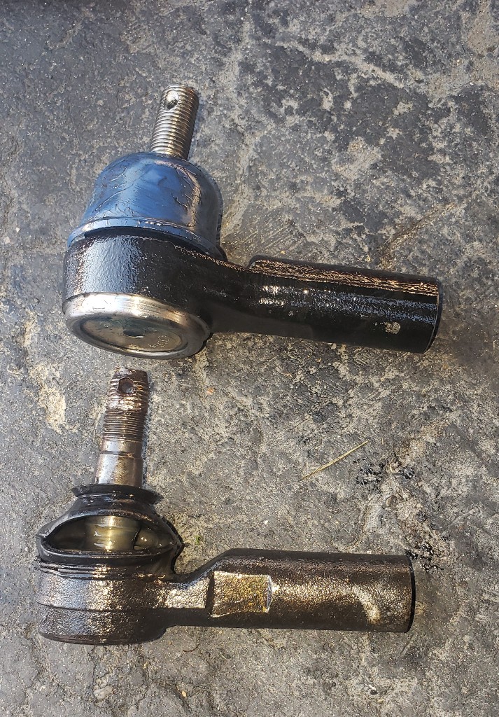

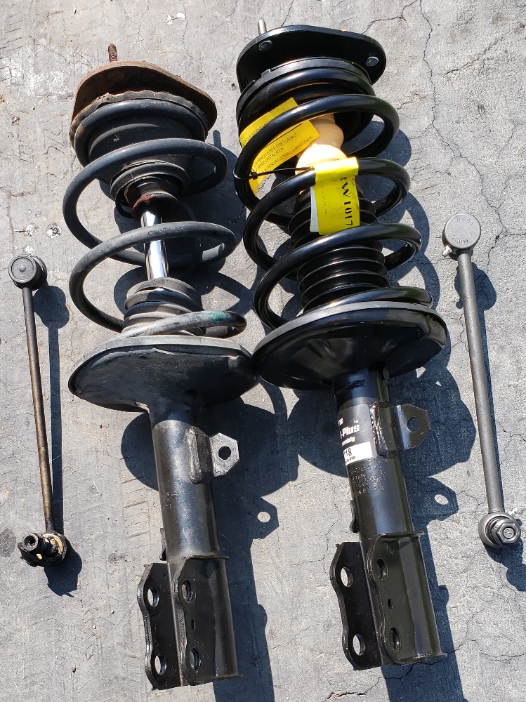

New KYB Strut Plus assemblies, Moog stabilizer bar end links, ACDelco Professional tie rod ends, a pair of inner tie rods picked up locally at Oreilly, one hack job driveway "alignment" followed by one at a shop.
The old stuff was clearly in great shape. :lol:
Had a few surprises along the way - minor stuff, like snapping a stud off the driver's side strut when torquing the nuts down. :roll: Wasn't expecting to have to replace the inner tie rods either, but when I took the ends off it was obvious they were trash too. Found a pair locally, but nobody had the loaner tool to help replace them. Found an adjustable tie rod tool at AutoZone, fought with that thing for a couple hours but never could get them to budge. Had to track down a Harbor Freight that had their tie rod tool set in stock, that worked like a charm.
She drives and rides beautifully now. Quite an amazing transformation. Sure, I spent more than I had originally expected on tools and extra parts. Not to mention spent way too much time out on an asphalt driveway in direct sunlight wrenching on her. But she's worth every bit of it. 8-)

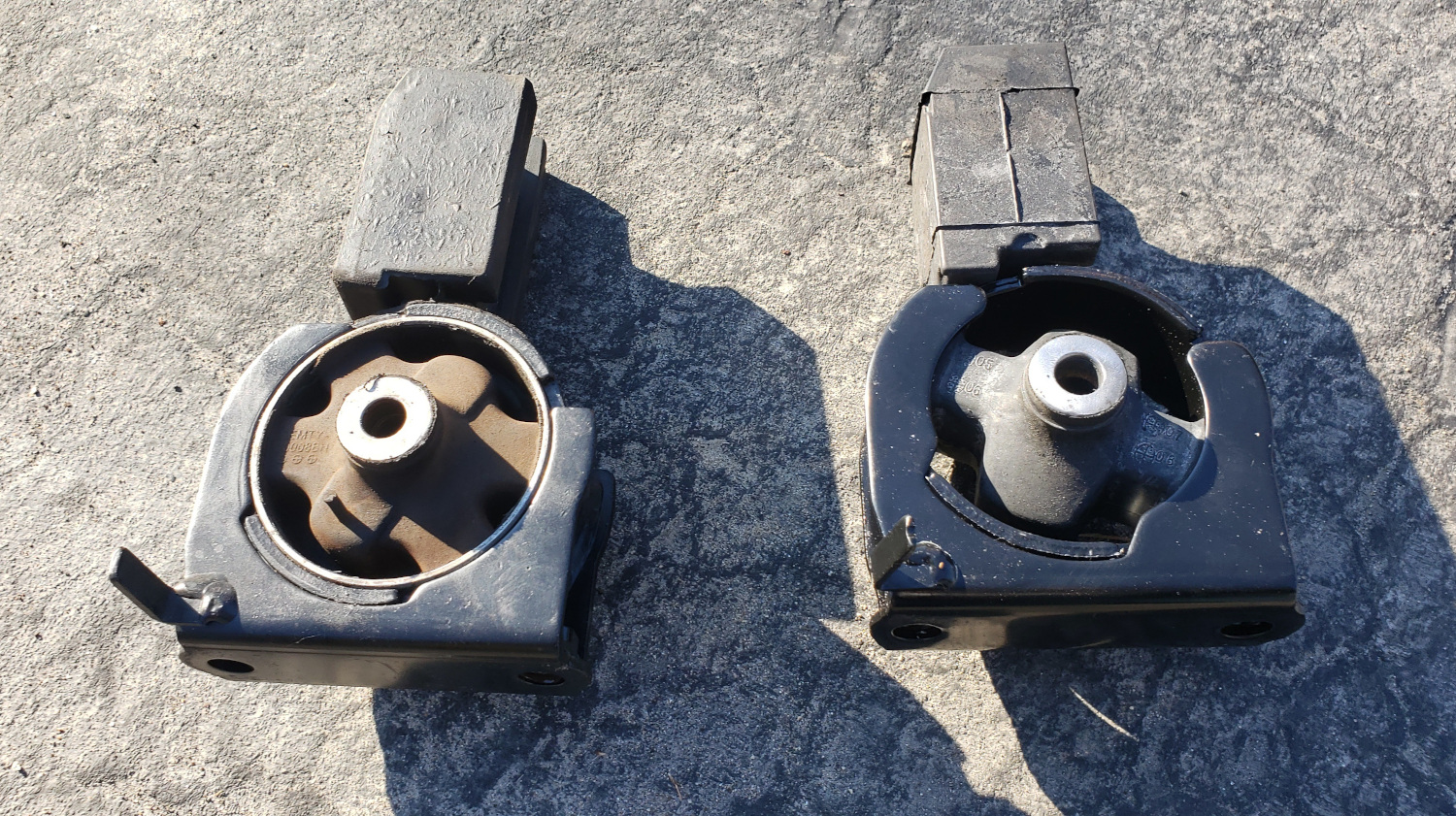

I solved the Vibe's unbearable vibin' at idle today! Not surprise here, it was the aftermarket front transmission mount which actually made things worse when I installed it a year ago. Installed a new OE ACDelco mount (P/N 88969066) and wow, what a difference. In gear/brakes applied/at warm idle speed, the only vibrations noticeable are nothing more than what I'd expect out of this engine (we all know the 1ZZ was hardly a marvel of refinement.) She's such a joy to drive now that I didn't even mind getting stuck at every red light during my test drive. :lol:
Beck Arnley aftermarket mount on left / GM on the right.
I'm no NVH engineer, but it seems the Beck Arnley mount was just far too stiff. The rubber section in the center of the aftermarket mount has hardly any give to it compared to the new OE mount which will flex without too much effort. When I pulled the original mount a year ago I had noticed similar flexing but thought it was because the mount was just worn out. ¯\_(ツ)_/¯ Oh well - I would say it's a bummer that I wasted money on the first mount and that I had to do the job again, but the smoothness more than makes up for that.
In other news, it has been over a year since the tires were rotated (2500 miles ago, LOL) so I took care of that. Greased up the tie rod ends and sway bar links. Sprayed some fluid film on random places.

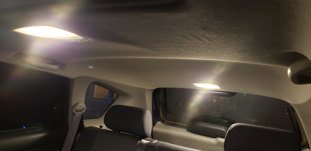

And I switched out the sort-of dim cool white LED's in the dome lights to some warm white ones.

ColonelPanic wrote: ↑Sat Mar 06, 2021 7:22 pm I solved the Vibe's unbearable vibin' at idle today! Not surprise here, it was the aftermarket front transmission mount which actually made things worse when I installed it a year ago. Installed a new OE ACDelco mount (P/N 88969066) and wow, what a difference. In gear/brakes applied/at warm idle speed, the only vibrations noticeable are nothing more than what I'd expect out of this engine (we all know the 1ZZ was hardly a marvel of refinement.) She's such a joy to drive now that I didn't even mind getting stuck at every red light during my test drive. :lol:
Thats good to hear ! Im in the middle of tracing down a vibration at idle as well. I think my problem was a mix of old/new mounts...so I redoing them all. I replaced the sides and front mount and that reduced the vibration dramatically. I still have a bit of vibration left....hoping the rear mount solves the rest. Its been almost 2 months and I have to to replace the rear mount, but Im going to pay someone to do it. Hope I didnt wait too long and ruin the new mounts again :roll: This is driving me nuts. The vibe has never been a smooth idling car, so anything more than that in unbearable. This is actually the first time I wanna get rid of the car and I have owned it for 14 years :(
As a side note how bad was the vibration with that one bad mount ? Its amazing that one mount solved your issue !

cptnsolo77 wrote: As a side note how bad was the vibration with that one bad mount ? Its amazing that one mount solved your issue !
If I had to rate it on a scale from 1-10, probably about 11. :D This month we've put more miles on the car than usual and so far things are still quite smooth. Very happy with the way things have turned out.
