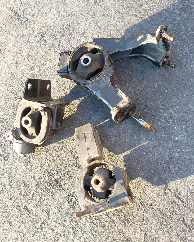

I've been replacing the engine mounts individually as time permits, finally finished that up today.
Bought another mount from Beck-Arnley for the front. Since the left and rear mounts are much more work to replace, I went OEM (chose Toyota for the left, GM for the rear due to the pricing.)
When I replaced the front mount, the vibration in gear at idle actually got *worse.* I don't know how much of that is from where it's idling like crap in general or whether there's something up with the new mount. I'll try to work on the idle next and see if I can get things smoothed out. If all else fails, I'll just have to replace the front mount with an OEM part.
I saved the rear mount for last since I knew I was in for a real treat . Trying to yank the old mount out and drop the new one in was the crappiest game of Tetris I've ever played. I don't recommend it. :lol:

ColonelPanic wrote: ↑Wed Mar 11, 2020 5:07 pm I've been replacing the engine mounts individually as time permits, finally finished that up today.
LOL :lol: Im in the same boat. I replaced all of except that dreaded rear mount. I was HOPING if i replaced 3 the vibration wouldnt be so bad but NOOOOO.....you have to replace that last one ! Actually the vibration got WORSE when I replaced the 3rd one...so I was like....oh looks like I have to change that darn rear mount. It was actually very smooth when I just replaced the side mounts. I need to replace them soon because I have been driving with 3 new mounts for and the old rear one for 2 months and I dont want to wear the new ones prematurely.
Any tips for the rear mount ? I found 2 youtube vids where they did it from up top. Im REALLY considering having a shop do the rear mount....I had a hunch that one would be a nightmare. I DID NOT like what I saw on the vids :lol: You are giving me even more reason for a shop to do it :lol:
How does it drive now ? Im betting it drives very smooth now. I absolutely cannot stand the vibration I have. Especially when cold (removed) :shock:
The #1 tip I saw for the rear mount is to pound out that center stud on the new one, and replace it with an equivalent bolt and nut. Will still serve the same purpose , without the aggravation.

Oh wow....I did some serious research on doing this and never came across that one. I can see how that would be a BIG help THX 8-)

a few folks on the FB page recommend that. ;) I haven't done it myself, but whenever I decide to yank the engine to reseal the timing cover, that may be my plan of attack for that rear mount.

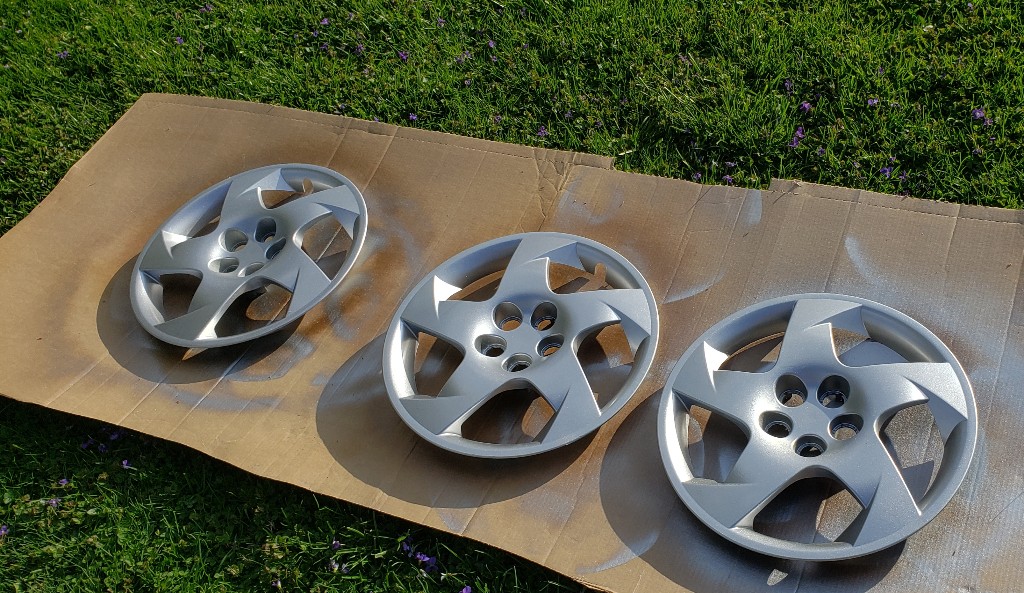

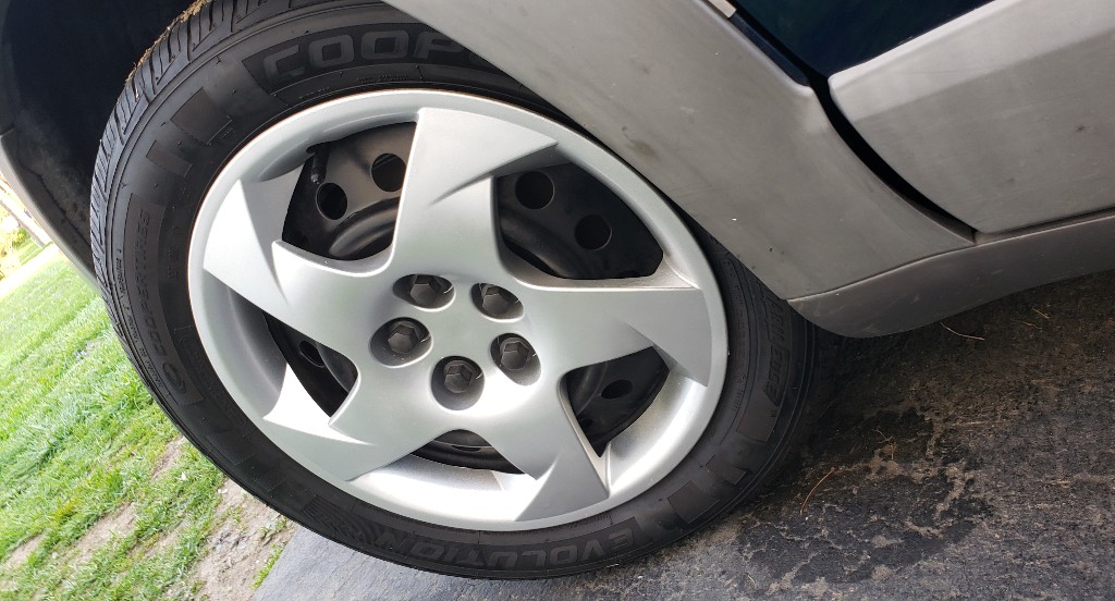

Started into these yesterday.
20200406_185903 - Edited.jpg (247.67 KiB) Viewed 563195 times
Used Rustoleum self-etching primer, followed up with Rustoleum wheel paint ("Steel" color,) and finally a few coats of Rustoleum wheel clearcoat. I really like the color of this paint, it's very sparkly. 8-)
Where's the other one you might ask? When i was trying to get a final coat of the silver, a couple bugs decided to commit suicide. Probably wouldn't have been too noticeable, but I ended up making it worse when I tried to get them out of the paint. Ruined it, had to start over. Paint's drying on that that one, it gets clearcoat tomorrow. :roll:
I suck at painting, so they're far from perfect. But it's better than they were - curb rash, road grime/brake dust permanently etched, not to mention the yellow "accents" from where the paint on them was gone all together. :lol:
