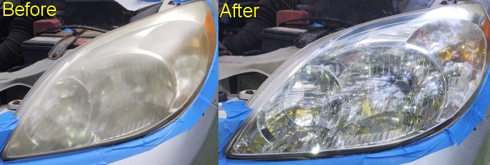

For bulbs, while the Sylvania Xtravision worked quite well, I gave up on them due to the short life. I'm currently using Philips VisionPlus which have a longer rated life. Nice little upgrade over standard halogens but at the end of the day they're still in 19 year old assemblies.
Image Image

just to follow up from a couple of years ago, bar keeper's friend (bkf) really doesn't do much, any effect is really short lived.
Yesterday I worked the headlights on my truck, used the sylvania headlight restoration kit. I picked that one because it came with a UV blocking clear coat, and a lifetime guarantee (more on that later)
It's an entirely manual kit, no drill attachment or support for power tools. It takes wet sanding for 5 minutes for each of the three pieces of sandpaper, and another five minutes rubbing with a wet rubbing compound, then finally wiping on a chemical clear coat. There's a couple of washing/drying steps in there. Took me about an hour and a quarter for the job, which includes the 40 minutes of sanding/rubbing on both headlights and taping the painted areas around the headlights (no tape in kit)
kit includes one thin plastic glove for use on the clear coat step, but I could have used two, spilled some on my other hand opening the little bottle of clear coat, and i dribbled a little on the painted truck bumper, which I hadn't covered, but its only visible up close. The clear coat step is pretty cool, after sanding /rubbing the headlights still have a cloudy haze, but wiping on that clear coat turns it to crystal clear. Feels like magic, and satisfying after the labor.
To me the lifetime warranty is a gimmick. First off, the kit is about $22 on amazon, which isn't very much these days. Also, it takes years for headlights to yellow and haze, which means that if you are using it, then your car is already getting old. If it lasts for a couple of years then the car is that much older, the odds of still having it are reduced, Obviously, here at genvibe where we're dealing with reliable cars that are already at least a dozen years old, this last bit may not apply to us as it would for other vehicles. Still, if I get a couple of years out it it will be worth the $22.
The results were excellent, the headlights look brand new. I only did it yesterday, so I can't say how well it will last
