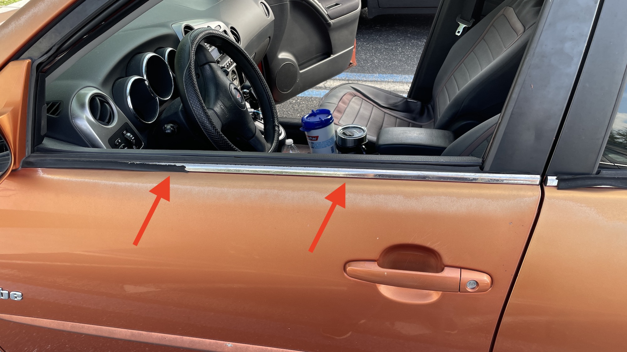

I've searched everywhere for the 4 Window Belt Trim Moulding strips that sit on the the outside of the windows to prevent water from getting into the door. Maybe I have the wrong name for these ellusive parts?
I've seen them called Belt Trim Moulding, Belt Trim Molding, Sealing Strips.
I'm also wondering if these strips are the same strips that are used on the Matrix? If so, maybe you can order the Matrix part numbers.
The one's I have found online for the Vibe are discontinued.
Any leads to get these is greatly appreciated.

For the 2009-10 model Vibe, here are the following Toyota part numbers for the REAR:
Molding Assy, Rear Door Belt, RH
75730-02170
Molding Assy, Rear Door Belt, LH
75740-02170
