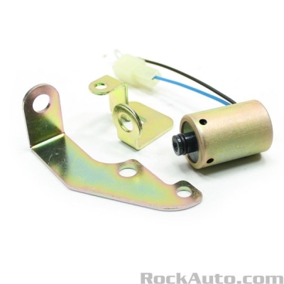

I am currently having my engine replaced with a rebuilt one and would love to address a CEL that has been intermittent. P0741 has been coming on, but no performance issues noted. While the engine is out I was thinking I could have my mechanic replace the solenoid since it is fairly inexpensive. I wasn’t able to determine if it is truly located on the exterior of the transmission but if it is, figured it would be the best time to do it for accessibility reasons. I searched for diagrams but didn’t find one. I haven’t been able to find a service manual online either. If anyone has done this themselves and made a video or taken pics please share. Thanks so much - this forum has been very helpful since buying my Vibe last fall. I was surprised when the engine failed as there had been no warning signs, no overheating, nothing except this one code related to the TCC. Could an ignored TCC malfunction cause my engine to lose all compression?

If your vibe is not AWD, then the auto tranny is model A246E. rockauto.com says a TCC for an A246E tranny looks like
judging only by the look of the part, I'd say that its something inside the tranny, not directly accessible from the outside, but that's not a very authoritative answer.

I found it definitely inside the tranny on a Corolla parts diagram (same tranny). So no, it doesn't need to be done with the engine work.
