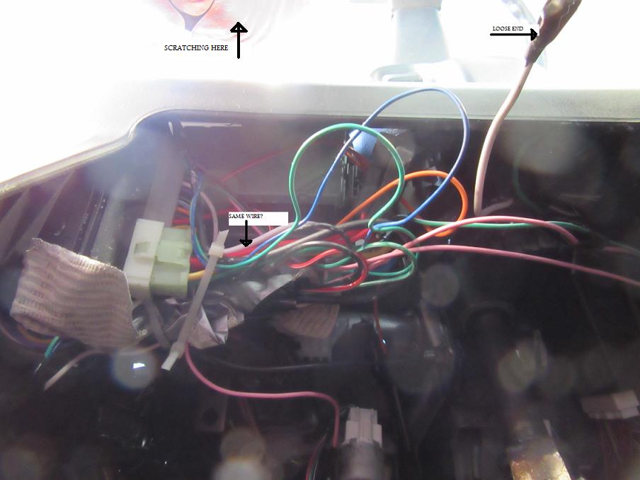

My car has an aftermarket remote start built in. There are no other modifications to the electrical system. My thinking is that the professional installer did what professional installers like to do: get their stuff working and mess up something else. I found a loose white wire that is thicker than the rest of the wires. Maybe some one knows where it belongs. Please have a look at the pictures. We are under the dash by the brake pedal.

Why would they run a power wire colored white :?

It looks to me that the white wire is probably one that someone has pulled in (added) because the gauge of the wire does not match any of the other wires. I take it that this is the wiring schematic you have:

Indeed I have the diagram that jolt posted. It also seems true that the white wire is part of the aftermarket remote starter that was not needed in this application. I had trouble locating the fuse box. It was hidden by the brains of the remote starter. I moved it out of the way and finally found the fuse box. Next thing was finding the relay. It's above the glove box hidden from sight. I can feel the relays by hand. They are different sizes. I jiggled them and made sure they sit properly but that did not result in power at the outlet.
