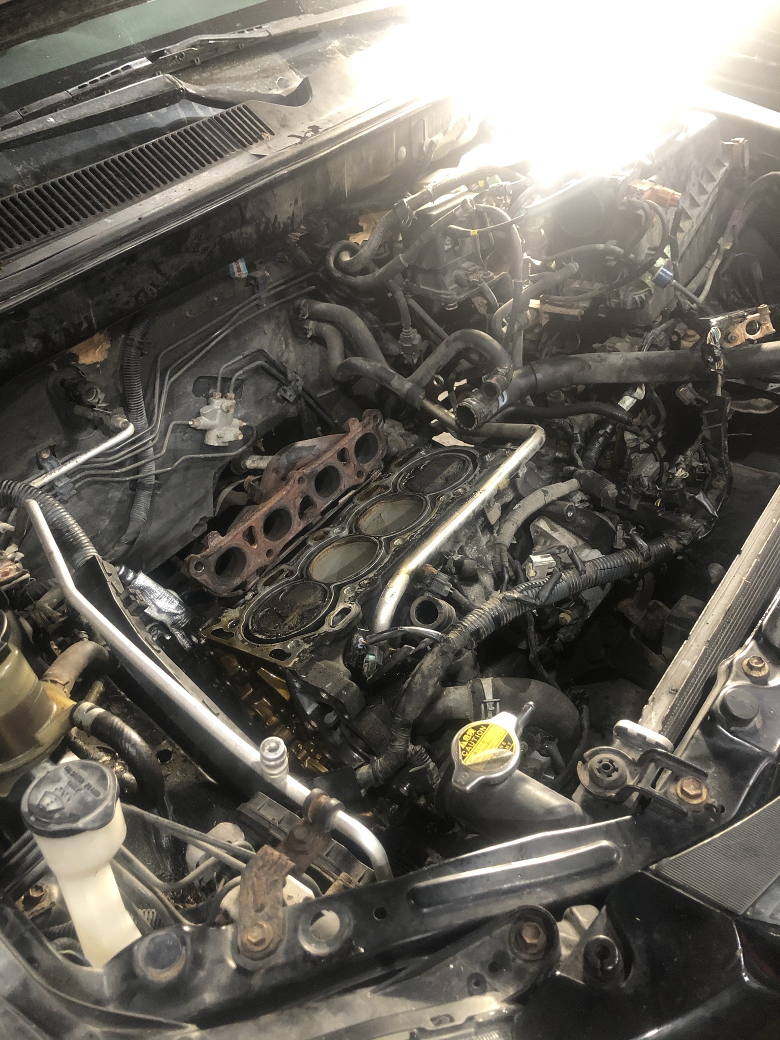

Road trip went great till I was about 15 minutes from home on the return trip. Number 4 rod bearing left the chat. I’ve got a spare engine I will be prepping for install in the coming weeks with only 120-125k on it
Posts: 4196
Re: CraftsmanQuad’s 03 GT
CraftsmanQuad19 wrote: ↑Thu Sep 16, 2021 2:36 pm Number 4 rod bearing left the chat. I’ve got a spare engine I will be prepping for install in the coming weeks with only 120-125k on it
Ouch !!! :o Just when you think you had it running the way you wanted it and then this happens! Keep us posted on repairs.

I’m pretty sure I know what happened…I was driving in my usual fasihion at 7k in 4th gear and I’m pretty sure I sucked the stock oil pan dry. I’ve read on here the oil pumps will flow faster than oil can return. Plus it was the original, non-baffled oil pan…which I’m sure didn’t help. Engine and trans are out of the car, I’m going to go through the spare engine this weekend with all the gaskets, new timing set, and I’ll use whichever head is in better shape.
Old motor had 6,000 miles on the top end, but bearing material ran through the oil when it let go. Don’t know if it made it to the head and damaged the cam bearing surfaces or not. The spare engine was in a wreck and ate a chunk of the #4 intake manifold runner. Worried that may have bent a valve. I’ll use the better parts of the two engines.

Put the new engine together on Sunday. Full gasket set, and timing set. Re used the spark plugs from the old engine since they only had 6k miles on them. Rings and bearings are original. I didn’t touch the rod caps, they’re all still the original Toyota torque.
Drivetrain will be going back in the car tomorrow
