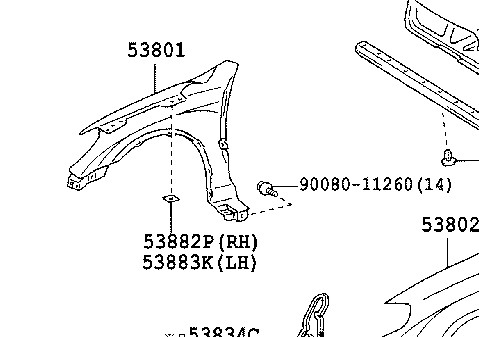

If you can't get a new fender to examine, look at the drawing. It looks like there are seven fasteners (14 shown for both sides).
Those white plastic trip clips are designed to be broken and have to be replaced once removed.

Thanks for the pic, didn't even think to look for something like that. It shows the bolt at the bottom rear I’m talking about, but not the trim panel that covers it.
I had some extra white clips that were good from my old fender, so I swapped them for the broken ones. Saw a video where a guy used a deep 7mm socket to push them out without breaking them. I haven’t tried it myself, but it appeared to work.
Edit: Any idea what that 53882 piece is? I don’t recall anything like that on either vehicle I took apart, but it could be a spacer or something.
Edit 2: Found a pic on this site https://parts.ganleygm.com/a/Pontiac_20 ... 03080.html, calls it a fender seal, and I do remember seeing one, gotta go put that in lol, thanks
Edit 3: Found the piece, can’t figure out where to put it. Opposite fender doesn’t have one that I can see, and I removed the black plastic support that covers the top area of the fender to make sure it wasn’t hiding. Any ideas anyone?
