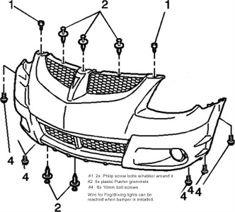

Thought I would add a picture that I modified that work perfect for my vibe for future removal.
pontiac vibe front bumper removal
pontiac vibe front bumper removal.jpg (58.63 KiB) Viewed 27319 times
