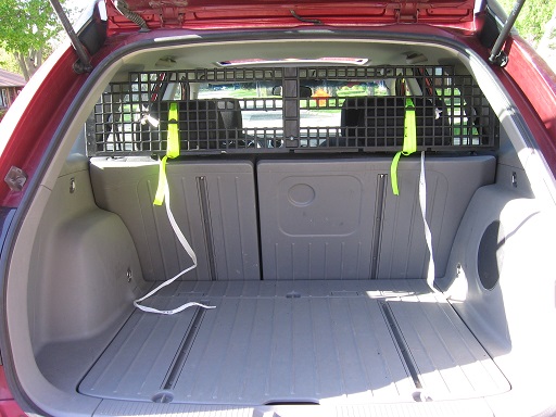

As first modification I made and installed a pet barrier to keep Yogi, the English Springer, in the trunk area. He was the reason why I looked for a wagon rather than a sedan. I was so close to buying a Kia Amanti but I could not imagine having the dog messing up the interior. The dog needs to be confined to his area for safety and cleanliness.
First I looked for a kennel and could not find one that would offer the correct size and convenience features. Then I looked for a universal fit pet barrier in the store and found nothing but junk for too much money. Finally, I found Vers-A-pad panels in a Theisen's farm supply store. I cut one to size and strapped it to the headrests of the rear seats. Bingo! it was cheap, about $20 + some straps. It looks great and is completely rattle free! The dog got used to it in only 2 trips to his favorite run-free areas.

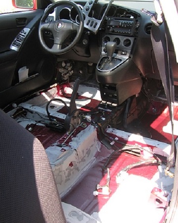

In July I completed the interior clean up and sound deadening. I pulled the carpet out and washed it with the garden hose, Bissell carpet and upholstery cleaner, a scrub brush and the Bissell wet vacuum cleaner. I am very happy with the results. There was a lot of dog hair in the carpet and the floor mats and sand everywhere. The waste water was black. I put more brush on sound deadener on the floor and after everything was dry I put it back together.
the grey material is sound deadener.
05 Vibe Carpet out (2).jpg (91.95 KiB) Viewed 88725 times

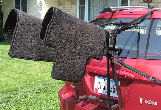

Re: Vibrologist's '05 Vibe
The carpet is hanging out to dry.
05 Vibe Carpet drying (2).jpg (99.17 KiB) Viewed 88729 times
and the floor mats too:
05 Vibe floor mats drying.jpg (131.2 KiB) Viewed 88733 times

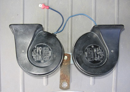

The original horn is too weak to demand respect. I replaced it with a FIAMM 2 tone set.
vibe 2-tone horn front (4).jpg (73.34 KiB) Viewed 88693 times

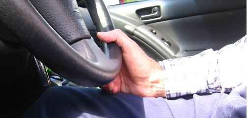

In an old Car and Driver article it was pointed out that the seat was 2" too low in respect to the steering wheel. This prompted me to try shimming the seat in order to achieve a more comfortable position. I purchased 2 bolts 10mmx1.25(fine)-40mm and 2 nuts 1/2-13. These nuts are too large for the bolts so the threads will not catch.
I loosened the bolts in the back and and removed the bolts at the front of the seat. I placed a nut under the seat bracket and inserted the new, longer bolt and tightened everything down.
This is how it looks like:
seat shim.jpg (53.15 KiB) Viewed 88570 times
You can see that the locating pin just behind the bolt is no longer in it's proper position. It could mean that in an accident the seat bolts may shear. I have to assume that a seat shimmed in this way is less safe than the properly mounted seat.
The result is a much more relaxed driving position because the hands can rest on the thighs while they hold the steering wheel:
Vibe after shimming the seat.jpg (32.87 KiB) Viewed 88570 times
Car and Driver exaggerated. Raising the seat by 10mm at the front is all it took. Not only is this more comfortable for the hands and arms,it also added 10mm in distance to the pedals. You cannot achieve the same effect by simply jacking up the seat with the lever. This will raise the rear of the seat and lower the front!

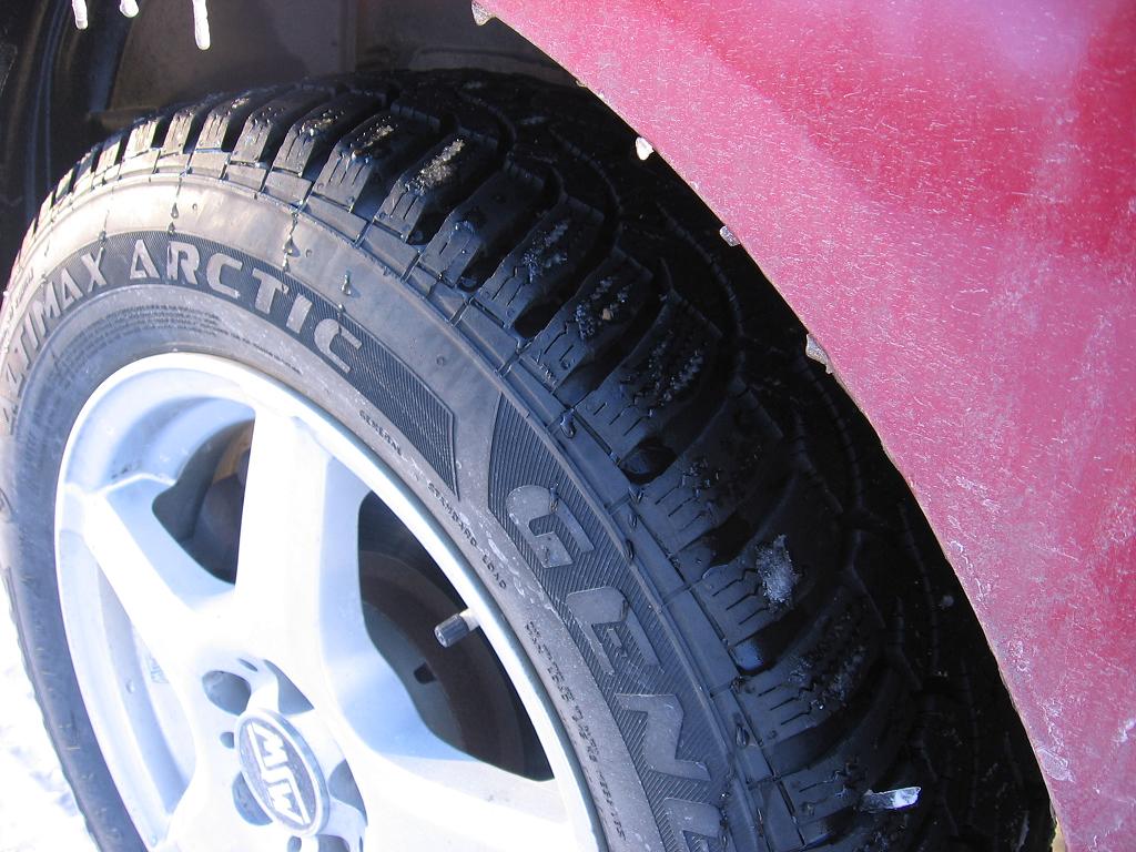

First snow and winter wheels: 15" MSW OZ with General Altimax Arctic that were previously used for 3 winters on a Toyota Prius. I had the wheels balanced, one of them needed a repair because a piece of a wood screw stuck in it.
first snow 2014 cropped.jpg (120.38 KiB) Viewed 88249 times
left front winter wheel.jpg (139.46 KiB) Viewed 88249 times
winter wheels morning hours.jpg (114.43 KiB) Viewed 88215 times

I was also wondering about the ride with the 15 in. rims. I am ready to do just about anything to improve the harsh ride of my Vibe. I already put on Monroe OEspectrum shocks and the ride is the same if not worse.
crashbandit wrote:I was also wondering about the ride with the 15 in. rims. I am ready to do just about anything to improve the harsh ride of my Vibe. I already put on Monroe OEspectrum shocks and the ride is the same if not worse.
Crashbandit: The Vibe's ride is harsh. The tires with more sidewall hardly help. If you want to go that route anyway consider 15" rims and tires with a larger diameter than the originals; narrower than original should help as well. But you will give up some of the good cornering.
Unless you find softer springs and struts with more travel you will not be satisfied with the ride comfort of the Vibe. I researched and found that the rear struts provide only about 5" of travel. Our Ford Contour has about 9" of travel. It also has a multi-link rear suspension and the Vibe has a torsion beam rear suspension. Travel on the front is comparable with other cars of that weight.
The Chevy Cavalier has a torsion beam rear suspension and struts with a little more travel, about 6 3/8". Of course by adapting a strut that was not intended for the Vibe you and I would go into experimentation. Experiments can go wrong. Unless somebody tries it no one will know if the softer springs and struts will compromise the ride height and the road holding. Who knows, the brake lines may be to short to handle the longer travel, or the beam gets twisted to much in corners. Considering the money and time involved I am not ready to do this experiment.
There are also Tokico struts. The problem is I cannot find any hard data on the ride they provide. Only opinions. Some found them way to soft which makes me think they could be a step in the right direction. But then a lot of people combine them with lowering springs. I do not know how this affects the available travel. If they provide the same amount of travel then there will be more negative travel which allows the wheel to drop further into a pot hole but it will have less positive travel to soak up a speed bump for example. For comfort it is also important how fast the struts react to road imperfections. I think this is were the Tokico may help.
It is not what you wanted to hear: in terms of ride comfort we bought the wrong car. On some roads I cringe and live with it. I hope my wife's Contour or my son's Mazda Protege conk out. That way the Vibe can stay in the family and I can get something more comfy. Actually, I may succumb to the pressure and get a Stupid Useless Vehicle. A Mazda6 wagon would be cool, but they have Ford 6 cylinder engines and a host of other issues. Oh well.

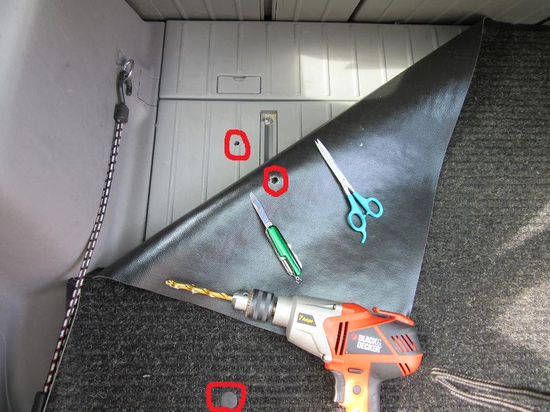

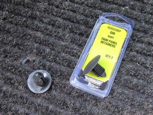

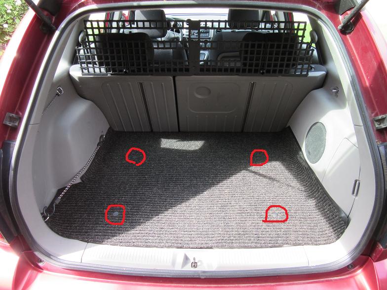

I copied nerdydaddyo's idea for adding a cargo mat that does not slide around. I bought a 3'x5' mat at Lowe's for about $15 and trimmed it with scissors to fit. I also bought 2 packs of 2 GM trim retainers for about $5. After lifting the cargo floor I drilled 4 holes of 3/8" diameter, laid down the mat and located each hole to make a matching hole through the mat. I pushed a retainer in each and was done.
cargo carpet job details.jpg (104.99 KiB) Viewed 87516 times
GM trim panel retainers.jpg (108.21 KiB) Viewed 87516 times
Now that's better:
cargo carpet and pet barrier.jpg (102.94 KiB) Viewed 87516 times

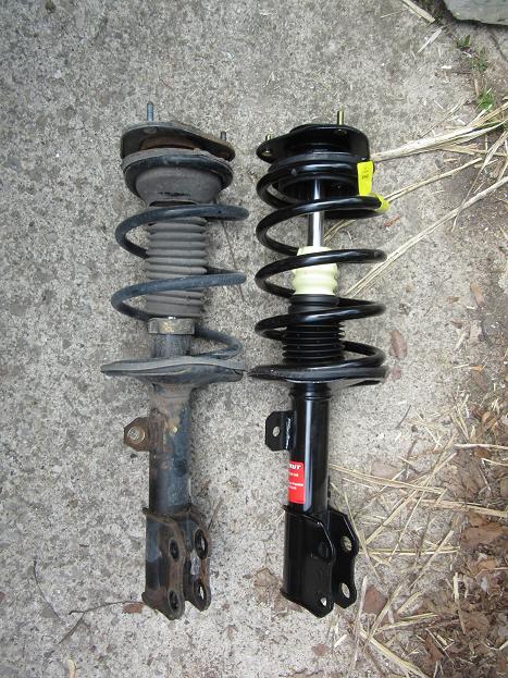

It is time to update this thread.

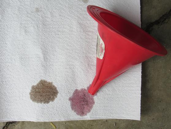

Recently my vibe received a new rear wiper, wash and wax, new spark plugs and -just today -a fresh fill of Toyota ATF T-IV. It needed it.
The old stuff came out black. The job was very easy because it does not require removing any splash guards. Everything is very accessible. I jacked up the car and supported it with 2 jack stands. I drained the fluid using the drain plug (14mm), then I removed the bolts (10mm) except for one in the front. That allowed more old fluid to drain as I turned the one bolt out a bit. Finally, I removed that as well. I hardly spilled a drop! I cleaned the magnets with a rag and the pan with a non chlorinated brake cleaner. Then I put it all back with a new pan gasket and tightened it down with a torque wrench (47inch-pound for the FWD Vibe). I filled in 3 and 1/2 qts of fresh type T-IV ATF. I drove it to warm up and checked the level. All is good. I will do a drain and fill again in a few weeks.

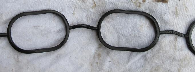

The Toyota dealer gave me 2 different gaskets to save me a way. I will return the other tomorrow.
old vs. new after at 107000 miles
T-4 ATF, old and new.jpg (52.07 KiB) Viewed 87207 times
This is the gasket I needed:
gasket parts number for the '05 base Vibe

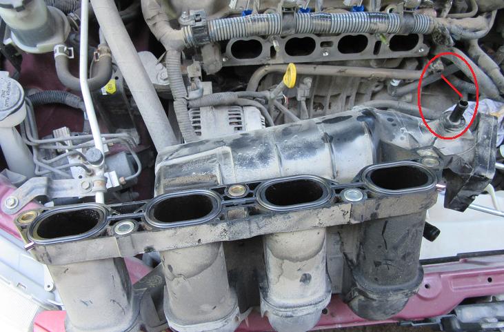

The Vibe recieved an new intake manifold gasket. Last winter I experienced some rough idle in really cold weather while the engine was warming up. It went away when the engine was at operating temperature. I got the gasket from Toyota and I expected it to be orange. It was black, though.
The old gasket was deformed. I am sure it leaked.
Intake manifold gasket.jpg (46.7 KiB) Viewed 86968 times
Here is the new gasket in it's channel. You see the intake with cleaned up mounting surface. In the red circle you see the brake booster hose and the nipple for it on the IM. I forgot to reconnect it on assembly. It makes for really rough idle, lousy brakes and a CEL.
clean intake and brake booster hose.jpg (89.05 KiB) Viewed 86968 times
I also cleaned the throttle body. I re-used the throttle body gasket as I could not get a new one today. I added a bit of blue sensor proof silicone.
The car idles smoother as a result of this maintenance.
Derf
Posts: 531
Location: NW Ohio
Post by Derf »
Looking good, thanks for posting the pics. At over 200k I figure my intake gasket will soon need replaced.
Derf wrote:Looking good, thanks for posting the pics. At over 200k I figure my intake gasket will soon need replaced.
You are welcome. Mine is at about 110000miles.-Yes, it think it would be a good idea for your Vibe.

My Vibe received new struts. After much research I decided to get Monroe Quick-Struts for the Vibe. I wanted more comfort. The front Quick-Strut's spring has 5-1/2 turns compared to 4-1/2 turns of the old strut. The rear Quick-Strut's spring has 10 turns compared to 8 turns of the old strut. The rear struts are 1-1/2" taller than the old ones. They will settle. The first driving impression is that these struts ride less harsh than the originals. I still call them short of comfortable. I expect some softening will still occur.
front old and new
front old and new
New Quick-Struts (3).JPG (101.31 KiB) Viewed 86003 times
rear old and new
rear old and new
New Quick-Struts.JPG (90.74 KiB) Viewed 86003 times

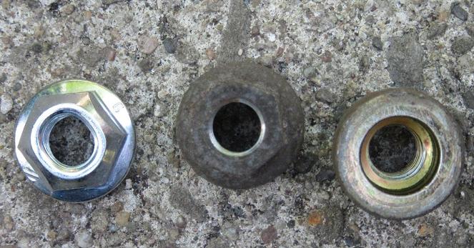

There have been reports that the studs of the front Quick-Struts are braking way before the specified torque has been achieved. I had a close look at the new nuts in the package and found them severely ovalized. Tightening these nuts will twist the studs. Apparently this twisting is too much for them. I used the old nuts that looked much better designed.
new ovalized nut and 2 original nuts
New Quick-Struts (2).JPG (81.15 KiB) Viewed 86003 times
The job was not too hard. It took me 3 hours for the rears and only 90 minutes for the fronts. The car runs straight but I will have the alignment checked anyway.
Ew, look at those nuts. (removed) were they thinking? Why didn't they do the OEM design?
lannvouivre wrote:Ew, look at those nuts. (removed) were they thinking? Why didn't they do the OEM design?
Ovalized nuts are self- locking. In principle it is not a bad idea. But the amount of squeeze has to be just right.
I prefer the nylon insert ones, but I've also never seen anyone but Monroe used locking nuts on the strut mounts.
Agreed. Nylon does the job better. When you tighten an ovalized nut you won't know where the torque was going to: is it friction and twisting the stud or is it stretching the stud? Ideally you only want stretching force in the stud. With nylon you get a little friction and mostly stretch of the stud.
