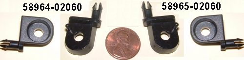

I broke part of my center console lid hinge, (the one between the seats) and ended up buying a new (used) lid assembly, since the GM dealer told me they only sold he whole lid, and not the hinges separately, but later I saw on here somewhere somebody was able to get some individual parts from Toyota.Here are the parts I broke, (new versions from Toyota, not broken ones)
These two parts are in each of the hinges, one on each side, and they are mirrors of each other.
(in the pic I acutally only took a pic of one of the parts, then mirrored it to get the other part, but the parts really are exact mirror images of each other.)
The interesting thing about this (the reason why I bothered to post about it) is that the although the parts are so similar, part number 58965-02060 costs $1.75 each, while 58964-02060 costs $4.27 each. I wonder what it is about the 4 that makes it three times more expensive than the 5?

Not sure, but I would think that because "Lefties" are a minority they would produce a smaller amount. So in order to recoup their losses they had to increase the price. I just calls it the way I sees it.

Quote, originally posted by joatmon »I wonder what it is about the 4 that makes it three times more expensive than the 5?seeing as the driver opens it more than the passenger maybe the left one has more stress.

Not sure on the Matrix, but the 03-04 Vibe center console also has a power outlet. When I was looking for a lid I ended up taking the entire console and wiring harness. The wiring is already there under the console, you just need the harness to connect it. I also bought replacement hinges from the Toyota dealer.

I can't remember whether my 08 had the hole there or not. I know I picked up a whole console w/lid out of an 04 from a junk yard but then had to buy a hinge for it from the Toyota dealer.
