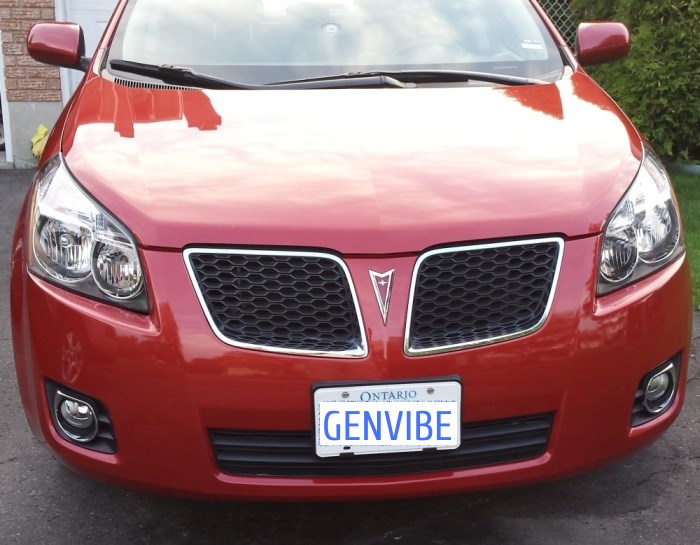

Former Matrix owner - Now joined the GenVibe community! I today drove home this exceptional 2009 Vibe Base with Convenience Package. Only 32,000km (20,000 miles) on the clock and I got it for a great price. It was owned by an older lady (found her name in the glovebox) that probably only drove it to church and the grocery store. Rustproofed for most of its life, OEM tires, GM even upgraded OnStar to 4G LTE in it. Sadly no XM as it was optional in Canada.
And of course the best part is that its RED HOT! I always wanted a red car. And I still can't get over how new this car looks and feels for being 7 years old.
http://i.imgur.com/kAuKruA.jpg

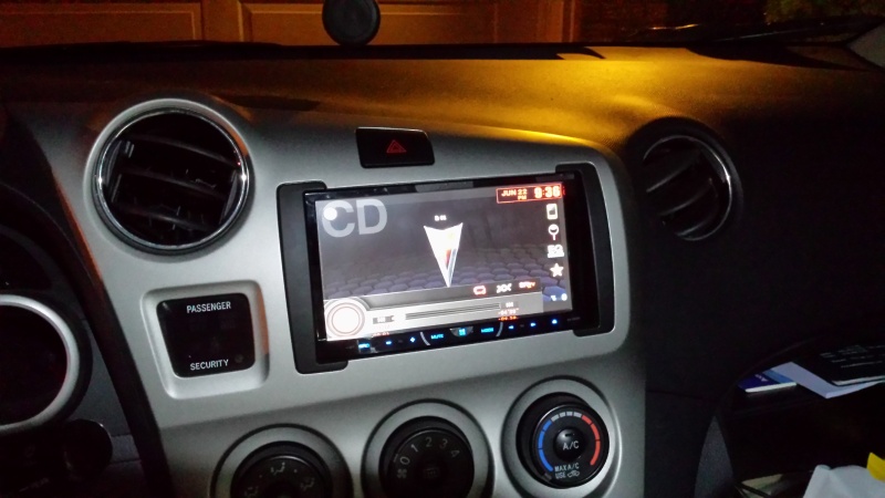

    Pioneer AVH-4200NEX head unit with Scosche TA2102B dash kit.

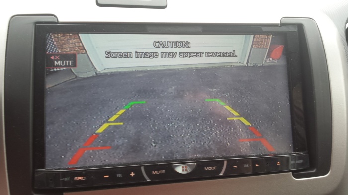

    Car Rover backup camera

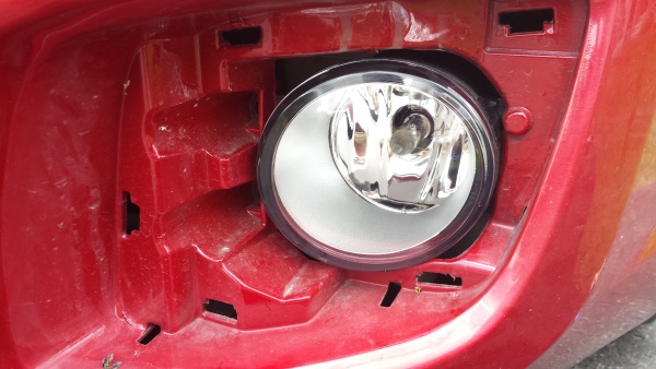

I ordered the bezels from gmpartsdepot.ca for $29.99 CAD a piece, and the lights from Amazon for $59.98 CAD. https://www.amazon.ca/dp/B00M12AKDW/ The amazon lights are NOT SAE/DOT approved if that matters to anyone, but they are glass. And the seller declared the value incorrectly so I had to pay slightly more import tax. :(
I ordered the relay from ebay and a dashboard switch from dealxtreme, which I wanted to wire up instead of switching out the turn signal stalk. But I got a great deal on a wiper and turn stalk off ebay so I'll use the switch for something else. Took me a while to find the relay after I had the dash apart.

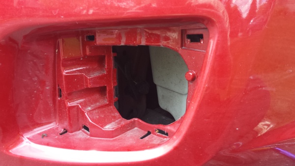

I installed the fog lights in my car this afternoon. Took me a while to figure out how to put them in, they have to go in from the back and one screw needed to secure the outside top corner from the back. Dropping the splash guard from the front bumper was a snap and I didn't have to jack up the car. I can't turn the fogs on yet, but they look great.
2009 Vibe Base
MacGyver
Posts: 340
Location: Ottawa (09 Base)
Re: MacGyver's - 2009 Vibe Base
Post by MacGyver »

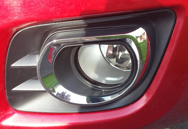

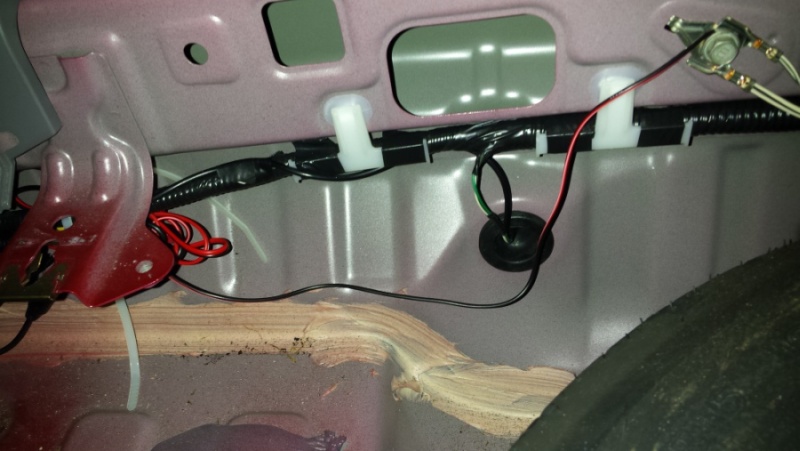

Here are some pics of the fog light install. I'm posting these because I didn't see them anywhere else. What it looks like when the blank cover is removed (can see the wire connector waiting in the shadows of the hole), and when the fog light is installed from the rear before the new cover goes on. The light itself has side tabs that insert into holes in the bumper, and is held in by a short screw that goes into the back side of that raised knob. I used a stubby screwdriver and some short screws in my parts bin. You need to move the lamp around until it sits on the back side of the knob, then you know it's positioned properly.

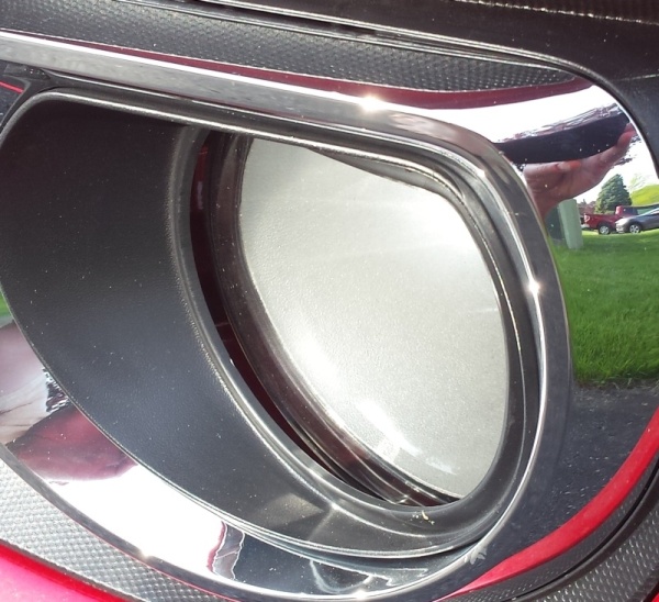

ElScotto wrote:How well to do the bezels fit with those fog lights?
There is a very small gap between the bezel and the lens. I'm guessing this is by design to allow moisture to shed off the lens and to make sure a hot lens does not melt the plastic bezel. Looks good!

MacGyver wrote:I'm guessing this is by design to allow moisture to shed off the lens and to make sure a hot lens does not melt the plastic bezel. Looks good!
You're right they do look good!
And I agree about the gap being by design for moisture and heat, I have seen a number of aftermarket fog lights melt or otherwise damage the plastic housing.

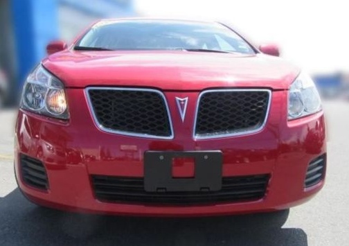

Looks real good ;) How about a pic of the entire nose so we can see the overall look? Too bad you didn't have a good before (maybe you do) and exact after so we can see the comparison. Nice work
2014 Silverado, 2004 Vibe GT
MacGyver
Posts: 340
Post by MacGyver »
tpollauf wrote:Looks real good ;) How about a pic of the entire nose
2009 Vibe Base
Definitely looks better with fog lights ;)!

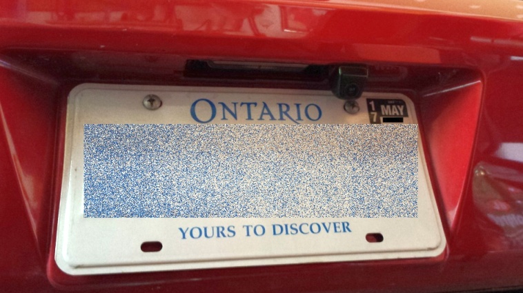

I want to change the license plate bulb to LED. The manual doesn't give a spec on the bulb (contact your dealer), but I pulled the bulb out and it's a W5W or T20 wedge. This contradicts many sources online, which have probably copied each other - it's NOT a 97 bayonet bulb.
Thankfully changing the bulb can easily be done from the exterior of the vehicle, unlike my 06 Trix which required going through an access door in the hatch and grinding knuckles until they bled. So it's not high on the priority list.

MacGyver wrote:I want to change the license plate bulb to LED. The manual doesn't give a spec on the bulb (contact your dealer), but I pulled the bulb out and it's a W5W or T20 wedge. This contradicts many sources online, which have probably copied each other - it's NOT a 97 bayonet bulb.
Yep, I've used a #194 LED bulb in the license plate light without any issues.
There are many incorrect bulb numbers online for the 2009-2010 Vibes. I have removed all the bulbs on my Vibe and added the correct numbers to the Exterior Replacement Bulb Guide thread in case you are wanting to replace any other bulbs with LEDs or something.

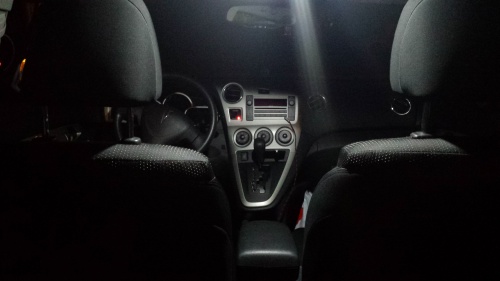

Also tried a Philips Vision LED lamp in the dome light, and it's pathetic. I'm a fan of Philips products, but not this one. It's not much brighter than stock.
2009 Vibe Base
Great to hear you got the fog light install finished up! If I had a Base without fog lights, I'd definitely have to install the turn signal stalk because I like keeping things OEM.
That's disappointing about the Philips LED bulb. For LEDs though, I highly recommend SuperBrightLEDs and v-LEDs. Both have great products, prices and customer service.
MacGyver
Posts: 340
Post by MacGyver »
I had some V-LEDs in my Trix and I never thought to take them out, probably because I figured I would buy something else. And V-LEDs doesn't make the bulbs I bought any more.
I ended up buying a Dome Litz 15 LED array from Walmart, and installed it in the front dome light. I had to cut the light housing to accommodate the LED array and drill a hole for the wire to pass around the back. Plenty bright. So bright in fact that I can't take pictures of my handiwork at night and have the photo be legible. I then moved the Philips Vision LED to the rear dome light where it does much better at lighting up the trunk area.

The Dome Litz LED array in the front is blinding and lights up the entire front of the car right down to the front footwells! Here is a pic at night.

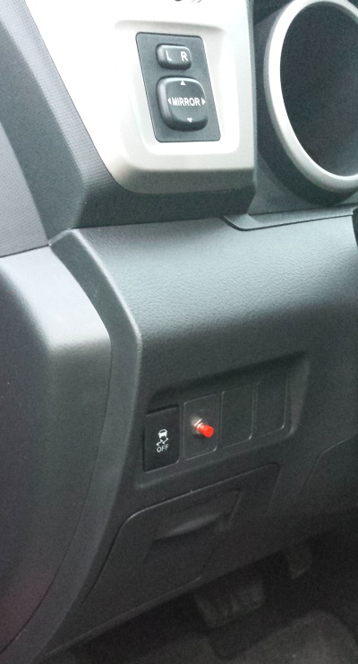

A red button, what does it do?
https://www.youtube.com/watch?v=ku2wFaaPAzI
Opens the garage door. My garage door opener was falling apart, it was big and clunky, the button didn't work any more, so I fixed all those problems by hiding it behind the dash. The best part - everything I needed came from the packaging of my Dome Litz, including the button.

MacGyver wrote: A red button...
Now it just needs a label, "Passenger Auto Eject"...
Always amazed what can be tucked into the dash.

Clever find on the fog light housing
Now can we find aftermarket LED or Xenon based ones with real projector lenses
MacGyver
Posts: 340
Post by MacGyver »
ctgottapee wrote:Clever find on the fog light housing
Here's some LED for 09/10: http://www.ebay.com/itm/OEM-Spec-15W-CR ... l%3AAvalon
Here's some "projector" type http://www.ebay.com/itm/High-Power-15W- ... bf&vxp=mtr
The Toyota fog lights are used in many different models so there are plenty of products available.

I finally got all the parts needed to install the Pioneer AVH-X4600BT head unit! The LED dome light was a great help in finishing off the install :D
I used the Scosche TA2102 dash kit and the fit is pretty good, although not perfect. I have yet to install the backup camera; I ran out of time.
For wiring harness, I used the Metra 70-2105 and relocated the red wire (the wire looks pink to me) as per this post.
The Onstar 4G LTE WiFi appears to still be working even though the factory radio was pulled and I didn't use any special adapter kits. Of course I can't talk to Onstar anymore, but I have a cell phone for that...

Backup camera was installed today! I used this https://www.amazon.ca/Car-Rover-Rear-vi ... B0140Y15QY which for only $20 was an absolute bargain. Solid metal housing; should last for a long time. EDIT: only lasted for a year before it rusted out.
I started by removing the license plate and the light above it, then drilling a 1/4" hole above the plate, so I could still take out the screws holding on the plate. The camera design is wonderful because the camera disconnects from the harness and the plug is only 1/4" in diameter, so that's as big of a hole as you need. Then placed the camera with the included double sided foam tape, and reaching in the license plate light opening, installed the nut hand tight to secure it, and replaced the license plate light. Then removed the trunk deck and the storage compartment holding the tire irons, giving access to all sorts of space. Then ran the camera wire through a rubber gromet in the back of the trunk. To do this I used a stiff piece of metal rod to poke a new hole in the grommet, down below the bumper, where I attached the camera wire and then pull it into the interior of the vehicle.
The camera wires for power are very fine, so I used soldered joints with heat shrink tape instead of but connectors.
The camera came with a wiring harness which allows the camera, video and camera power plugs to be connected and disconnected. The video wire also had an extra red wire embedded in it, which allowed me to power the camera from the front of the vehicle, so it's always on when the vehicle is on, and I can view it any time I wish. The alternate method is to power the camera from the backup lights, which I might change to in the future if camera life becomes an issue being constantly powered. This harness I bundled up and zip tied in the trunk area (photo attached).
I then ran the video cable along the passenger side door sills, which was a bit tough since the washer line also runs through there, so you have to be careful not to puncture it. Once at the front of the vehicle, the rest of the way was easy behind the glove box and up to the head unit.

You're a wonderful resource here at Genvibe! I really appreciate all the detail and pics you include in your posts explaining how you do things. Very valuable help for many of us DIY'ers here. Also, great find on the Amazon rear cam. Thank you for being here.
Since adding a rear cam is one of my planned upgrades I'm curious to know your thoughts about adding a rear cam to a 2006. I'm wondering if you would go about it the same way as you did on your 2009. As you can see there is space to add the camera you used but it will not be as well hidden and would also be further offset from the center of the lic plate because of two lamps instead of one (and the hatchback latch is center where your lic plate light is located).
On the 2006 there is no indentation in the hatchback to create a "well" for the plate and the only recess for the cam is the trim that houses the latch handle and lic plates lights. So the cam will be much less recessed from weather and a much more visibly noticeable feature. Not sure if rain on the cam lens would be an issue distorting the picture or how much of an issue being further off-set from center vehicle. An alternative would be license plate frame/cam. Or even drilling a hole in the hatchback itself just below center of the latch above the lic plate (a small dark anodized rectangular metal plate could be added so its not so noticeable a cam has been added).
I haven't figured out how to effectively search this website yet to check and see what others here might have done for adding rearcams to my vintage. But I will be figuring out how to do that.
In the meantime I'm curious to hear how the optics are on your new backup cam and any ideas you have for a 2006.
2006 Two-Tone Frosty AWD with Sunroof
Purchased June 2016 in Loxley AL
Steve41337 Tucson Arizona :D
MacGyver
Posts: 340
Post by MacGyver »
I owned a 1st gen 2006 Trix before the 2nd gen Vibe. I agree that above the license plate on the 1st gen is the best location, albeit off center. Drilling through the metal door would be a mistake and an invitation for rust to start at the hole or water to get in.
If you want to install a backup cam in a 1st gen, you'll need to take the inside panel off the rear hatch. This thread from MatrixOwners has some great pics. http://matrixowners.com/index.php?/topi ... a-install/ Also some good pics from this thread: viewtopic.php?t=43614
Fishing wire from the back of the plate up to the top of the hatch door and through the flexible conduit will be a challenge.
I attached a pic of my cam's video feed. The overlay lines are generic, built into the camera, and cannot be removed. The primary purpose for me of a backup cam is to make sure I don't run over any objects or kids. So having it aligned perfectly in the center of the vehicle is not important to me because I don't use it to align the vehicle while backing up. And it's not mounted exactly in the middle, an neither is the factory cam in our 2012 Odyssey. I haven't had any inclement weather yet, so I don't know how quickly it will get dirty, but it's quick to wipe off with a finger.
In retrospect, I thought about an alternative that you may wish to consider - a full time dashcam mounted in the rear window. The front A118C dashcam I have has an 3.5mm AV out, so installing one of those in the rear window to serve as a backup cam, with lens in an area of the wiper swath, would be much simpler to install and give you the benefit of a full time dashcam.
2009 Vibe Base
Steve41337
Posts: 28
Joined: Sun Jun 19, 2016 12:50 pm
Post by Steve41337 »
Maybe you can help me understand something about having a full-time rear cam used with one of these new touch screen radios. I like the idea that when I put my vibe in reverse the rear cam will automatically show-up on the screen and override whatever was previously displayed there. Maybe there’s no problem and a full-time rear cam can still automatically show up when the vehicle is put in reverse but I’m guessing that a full time rear cam will be overridden by other radio and app functions and the rear cam will have to be selected when needed? I strongly prefer to have to do nothing but put the vibe in reverse to view the rear cam.
Thank you for the ideas and links.
MacGyver
Posts: 340
Post by MacGyver »
The cam feed displays automatically when I shift into reverse, and goes away when I shift out of reverse. Head units use a reverse wire to pick up 12V from the backup lights circuit to toggle the camera.
The Pioneer head units also allow turning on and off the camera feed at any time, but only if the camera is powered continously. Any audio continues uninterrupted. Holding down the mute button will turn off the camera feed if in reverse, if for some reason it isn't wanted.
