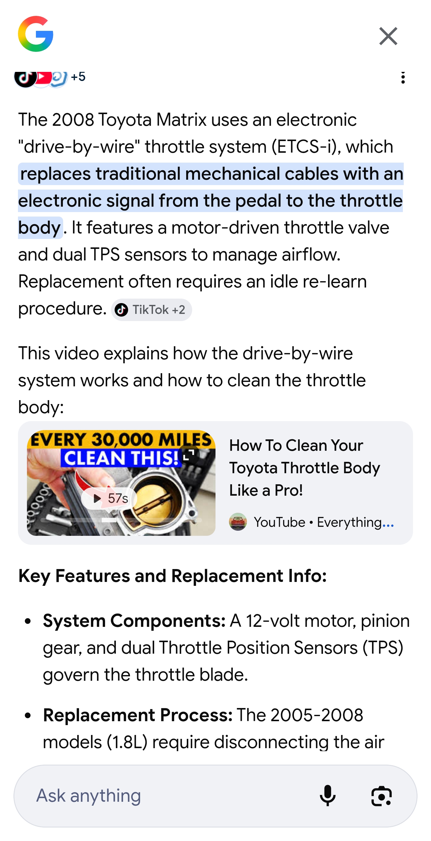

I jist asked a google Ai about drive by wire throttle system on our cars. I wonder if you have a poor commection to ykur throttle body.
As cars age the wires weaken. Corrosion can form and causes resistance which restricts current. Perhaps theres a way to perform a diagnostic between your gas pedal and throttle body. If you could measure the voltage of going to the throttle body while pressing the gas pedal with the engine running... make sure its in neutral. I suppose it should be receiving 12v all the time. A voltage drop occuring as the throttle body control flap is moving could indicate trouble.
The car is all computer controlled. Some weak signals between your gas pedal and throttle body may be causimg some glitchy behavior..
All that said, I'm really just taking some educated guesses.

vibedrivermatt wrote: ↑Sun Apr 26, 2026 3:09 pm Screenshot_20260426_185517_Chrome.jpg
I appreciate it. I'll run this by the new mechanic when I have the funds. I've been suspecting something purely electrical at this point, as everything else under the sun has been ruled out.
