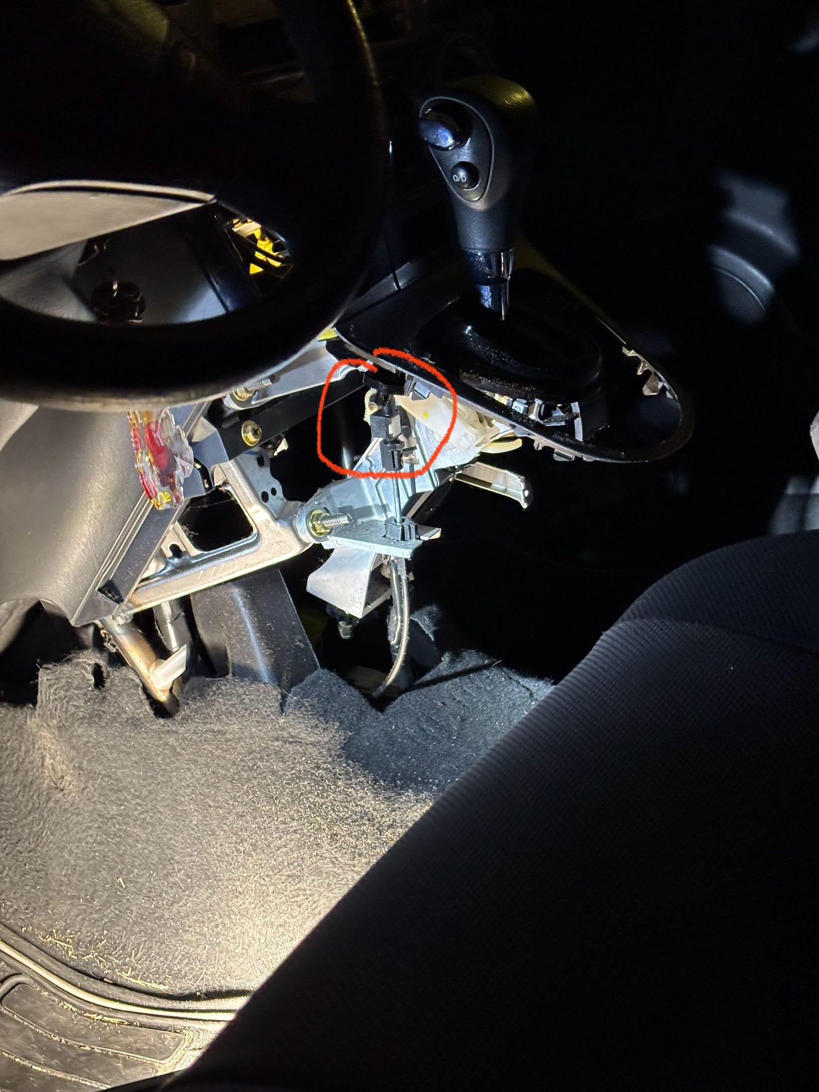

Also, here are some pictures of where the repair needs to happen, along with the bushing having been replaced:
This is the location of the linkage (did the fix in a lower level of a parking garage so it's a little dark! Sorry! :D )

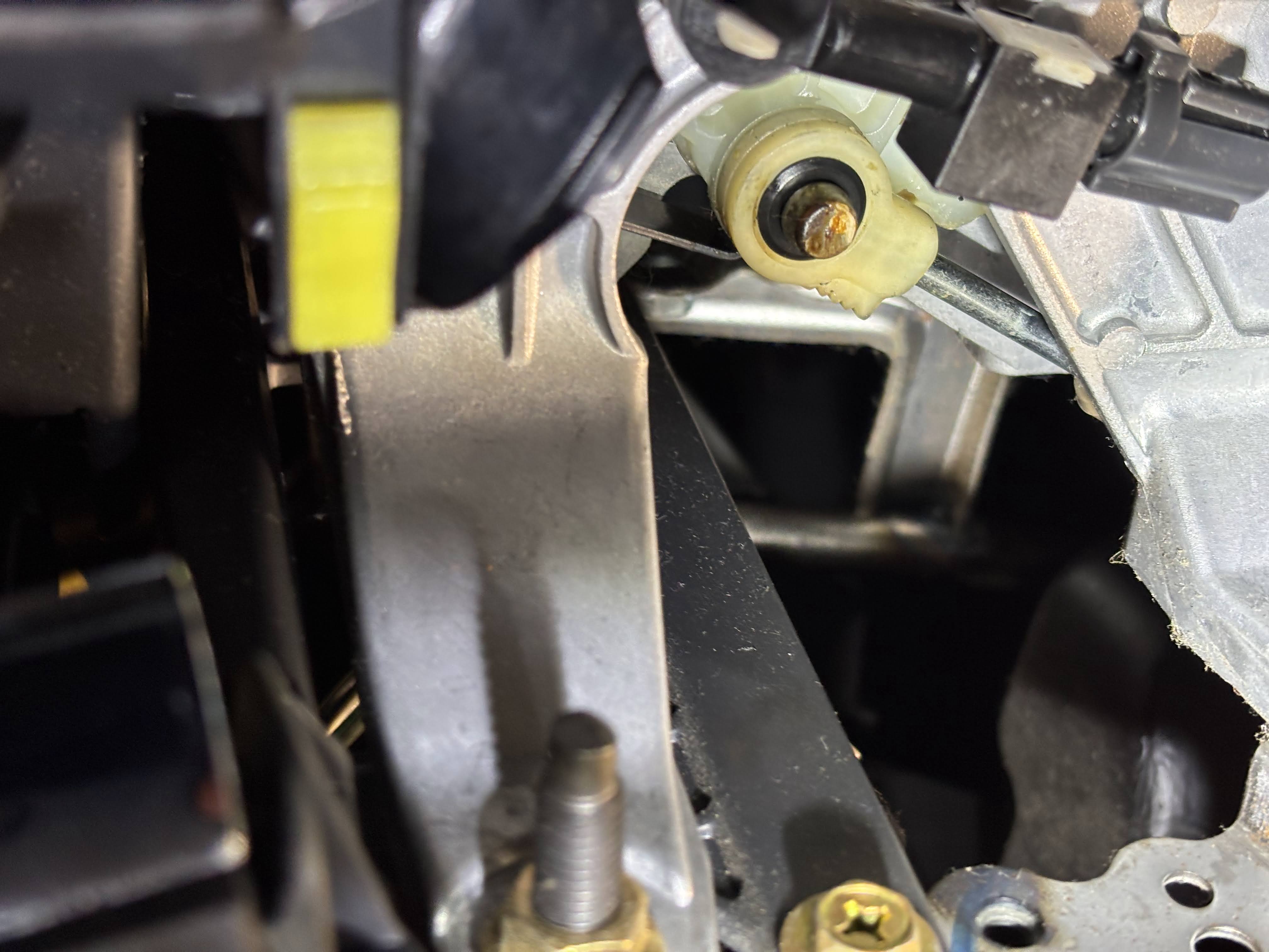

And here is the gear selector stud seated back inside the bushing at the end of the cable:
Worth noting that I didn't see a spot for a retaining clip on the stud. It may have been a bad angle and low light, but I didn't see a spot for a clip to go. Not sure that a kit with a clip in it from Amazon would have made a difference. I hope this helps someone else with the same issue!
