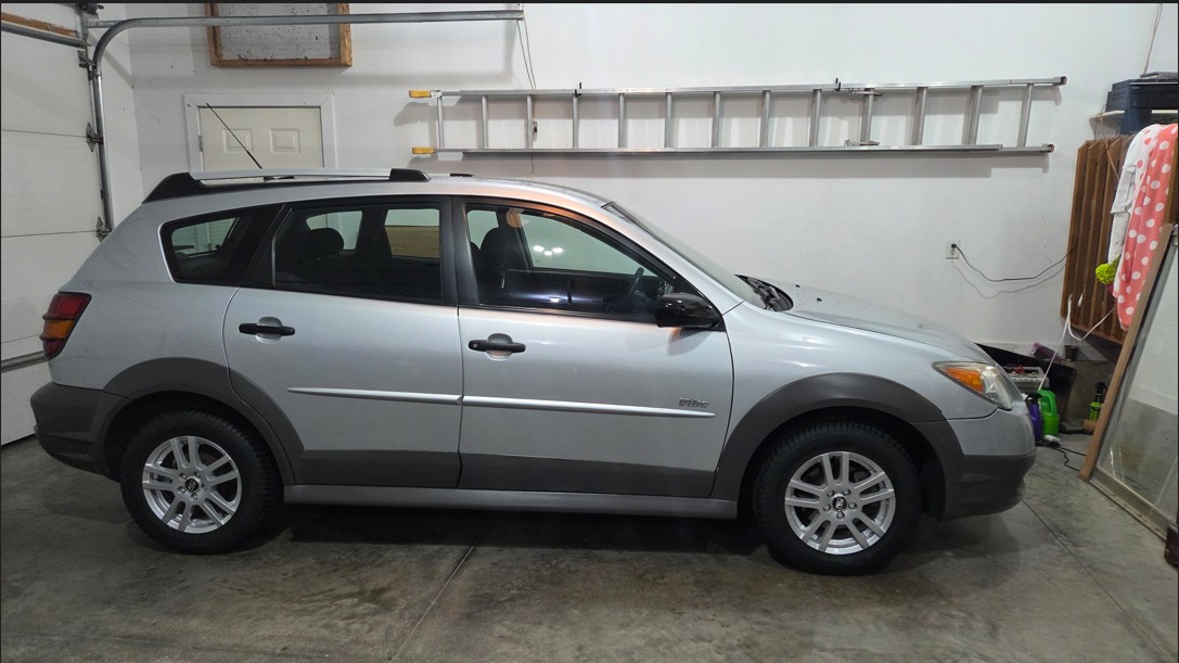

I will second the tires! I just replaced my Vibes wheels and tires (wheels were corroding and flaking badly). I went with a Minus 1..195/65R15 vs the original 205/55R16. (went Minus 1 for a number of reasons..wheels and tires are cheaper, ride is better and winter traction is better with a narrower tire)
Night and day difference in the ride. Feels like a new car. Even my teen daughter with a drivers permit immediately noticed the difference in ride.
