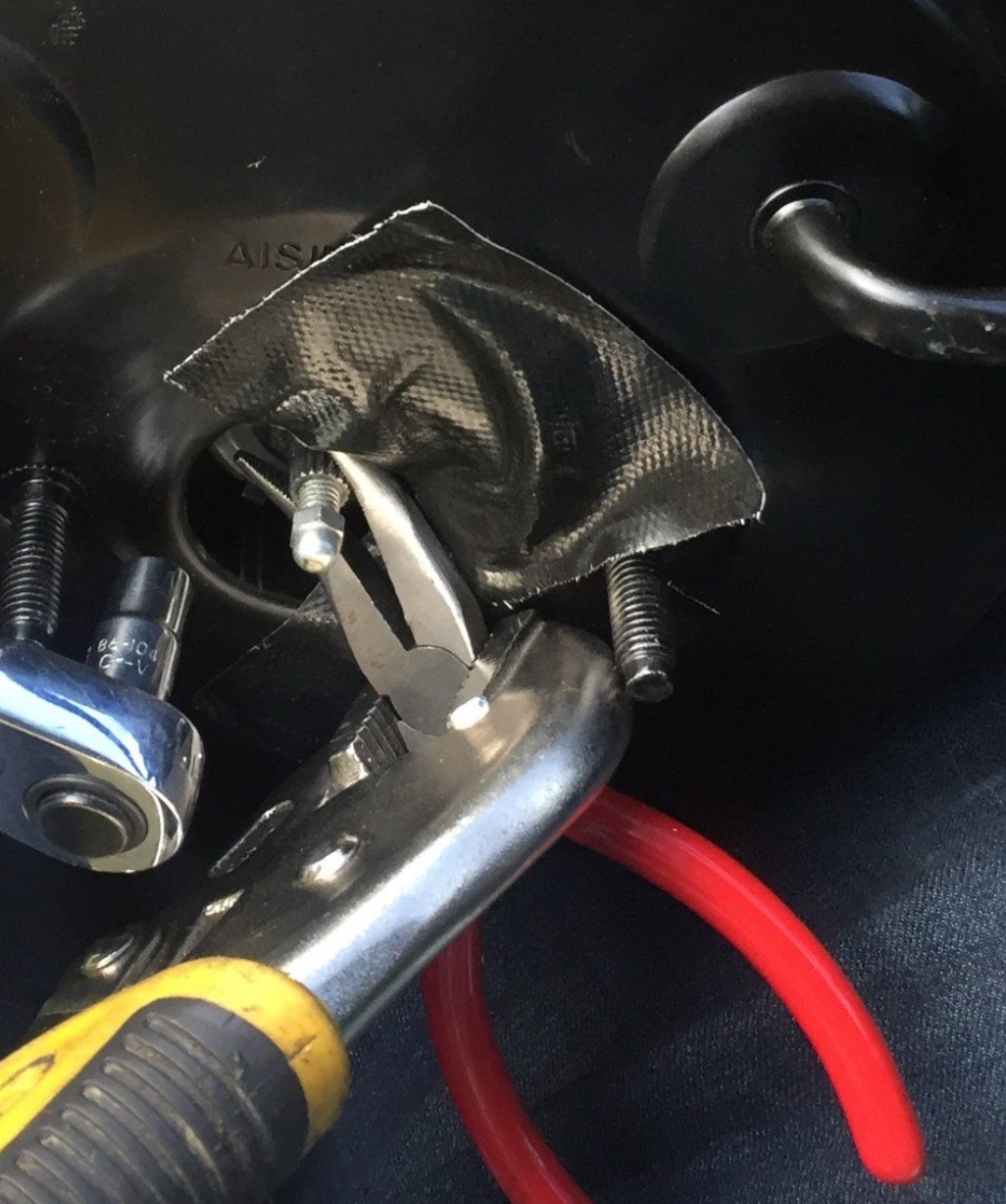

With a change of master cylinder, you have to check the depth of the brake booster rod--using a metal gauge included with the new cylinder--and adjust as necessary.
The rod has a 7mm head which you adjust, but you have to hold onto the brake booster rod (or it just turns).
I have tried various things, including this from a public website:
One way of trying to hold the brake booster rod!
The problem is that the serrated portion is deeper than in this photo and the hole is ≈2‐1/4" in diameter, so getting even a boxed-end wrench, etc., in there and not blocking the tip doesn't work. I was able to recreate a set-up like the photo, but the rod kept slipping.

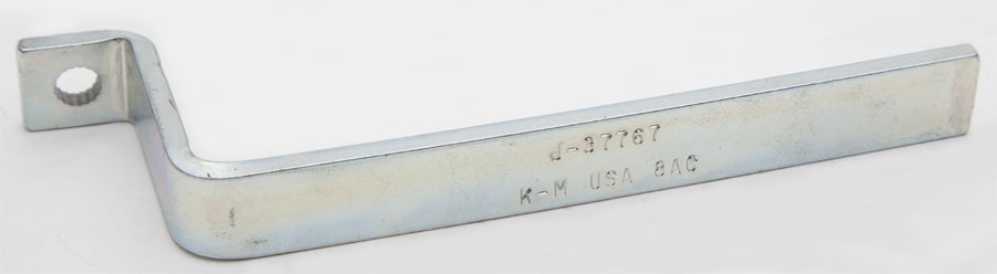

So I ordered the tool--a discontinued Kent-Moore tool, J-37767 - Brake Booster Piston Rod Adjuster, which looks like this
KM J-37767
KM J-37767
and of course is meant to hold that rod.
But have you ever successfully adjusted the brake booster's piston rod withOUT that special tool?
I'd love to know how!
