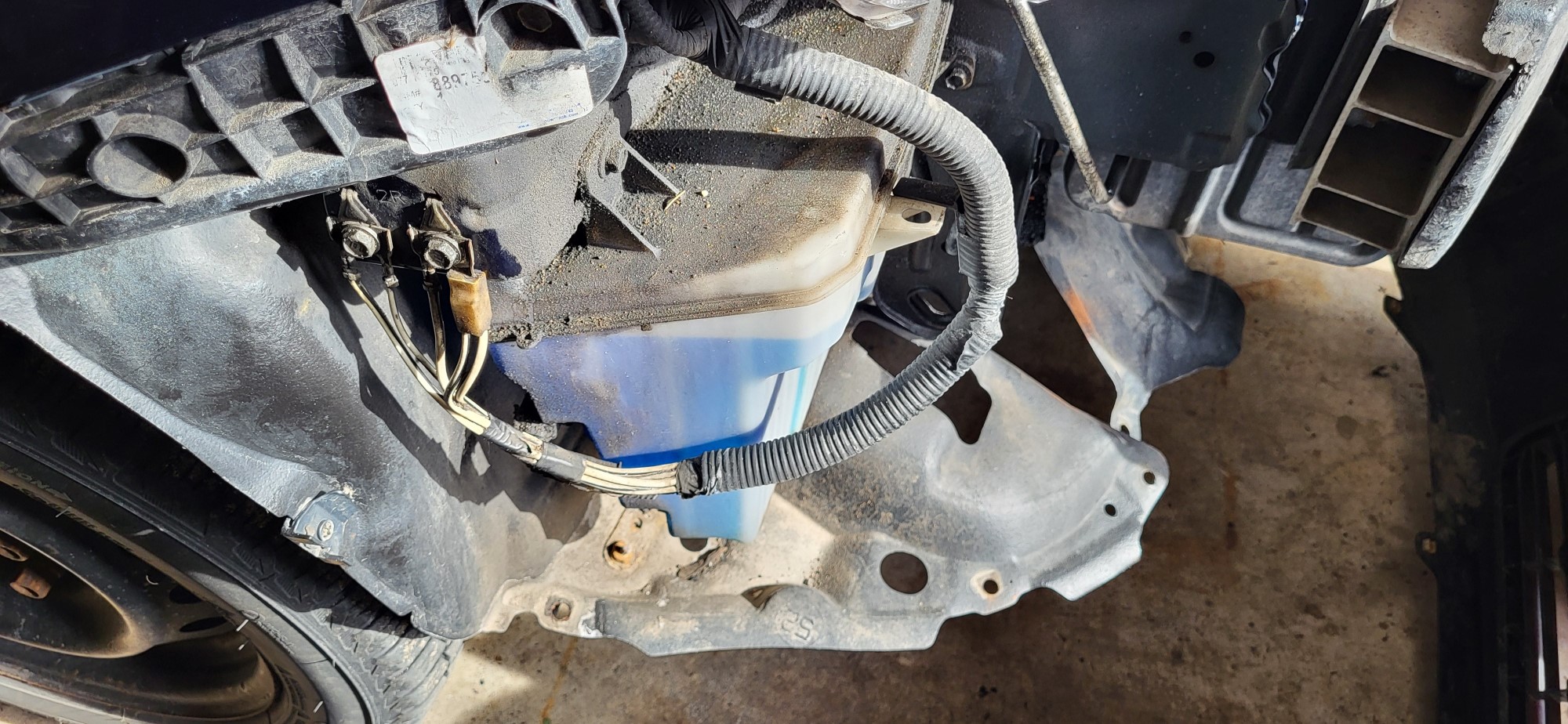

For anyone interested, I discovered that the grounds (G107) are on the passenger side under the bumper skin. I.e. you have to remove the bumper to get at them.
It may be possible also by removing the inner wheel house but, removing the bumper in my case was actually easier in terms of those plastic fasteners. To each their own.
In my case, the grounds were excellent and not the source of the problem.
