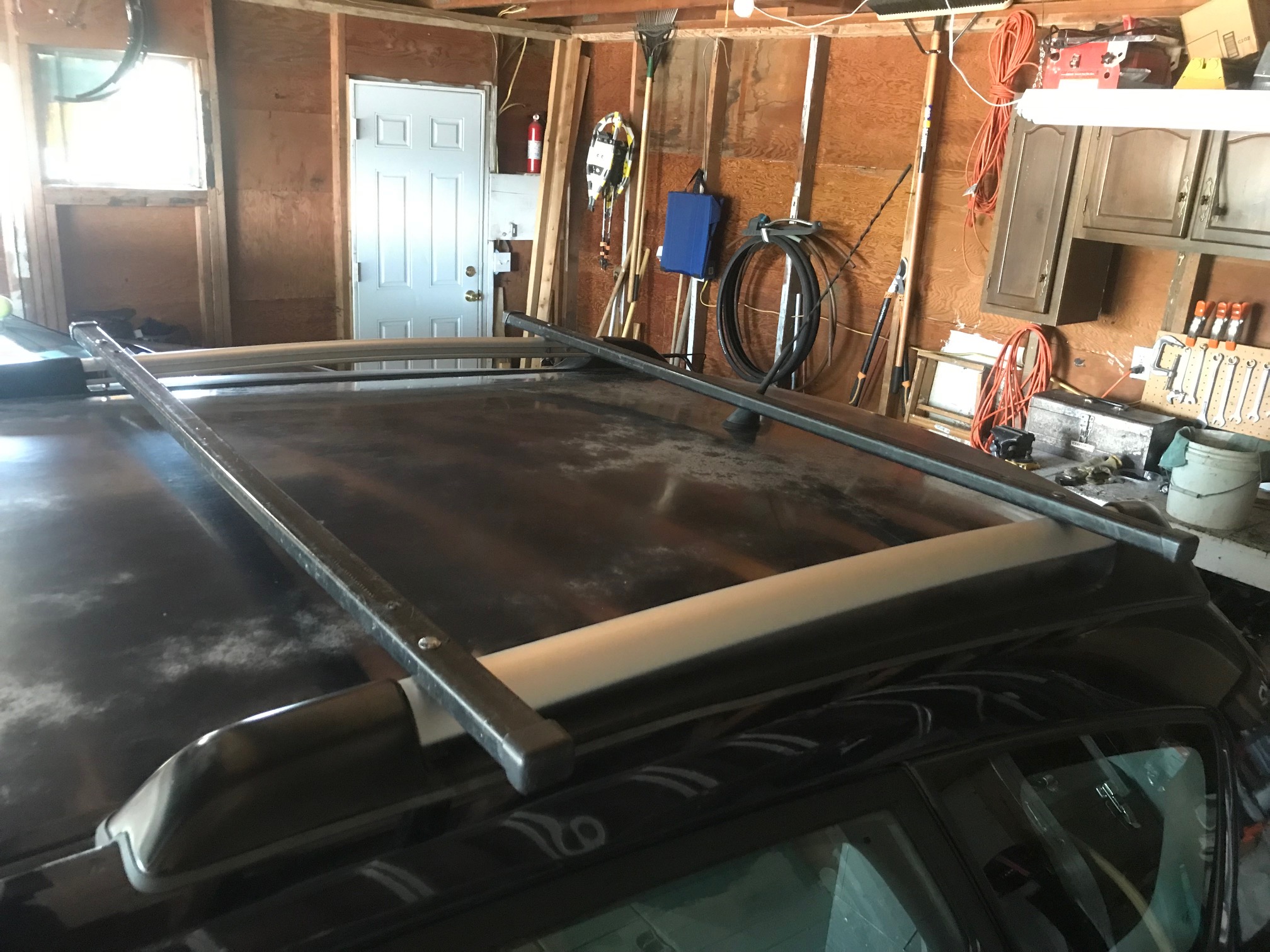

I just inherited my wife's Vibe to use as a work vehicle, for limited handyman work. I need a roof rack. I have some old Thule bars. So I got some hardware and a drill and attached them. There's just enough room at the front of the rack to fit a 1/4" hex nut and tighten it with a open-end wrench. I drilled 5/16" holes in the bars and racks, which gave plenty of tolerance to fit with somewhat careful measurements. The bolts are 2" carriage bolts, exactly the right length. They're 50" long bars, so I can carry a little lumber or drywall (with the antenna unscrewed).

Looks great and should be very strudy! Way to reuse the Thule racks. Thanks for sharing.

looks nice! and if you ever need some custom fitting, such as for skis or a kayak, it will be a lot easier to find something designed to fit the thule cross bars than the 03/04 factory cross bars

Thanks. I have some Thule bike racks and ski racks, so that function is nice.
I've seen the 75# number before. I will not carry 3/4" sheets of OSB on that rack--maybe one sheet of 1/2' drywall with 2x4 supports, maybe push it up to 100#. I've worked with structural engineers and have seen their factors of safety, never less than three.
I mainly carry my extension ladder, some 10' sticks of pipe, a hollow core door once in a while. I'm getting too old to do the heavy work.
