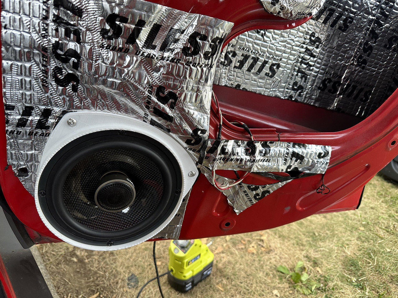

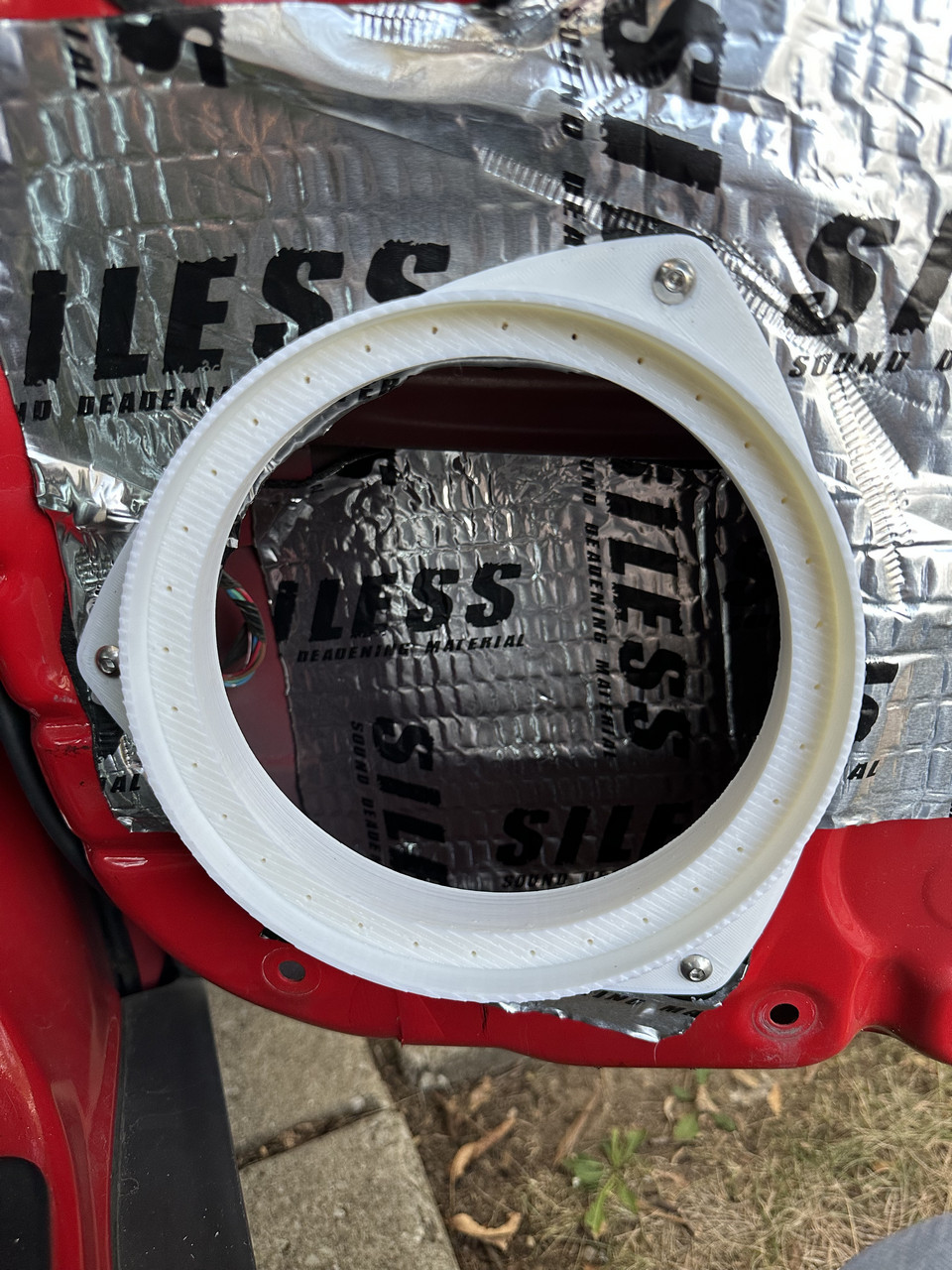

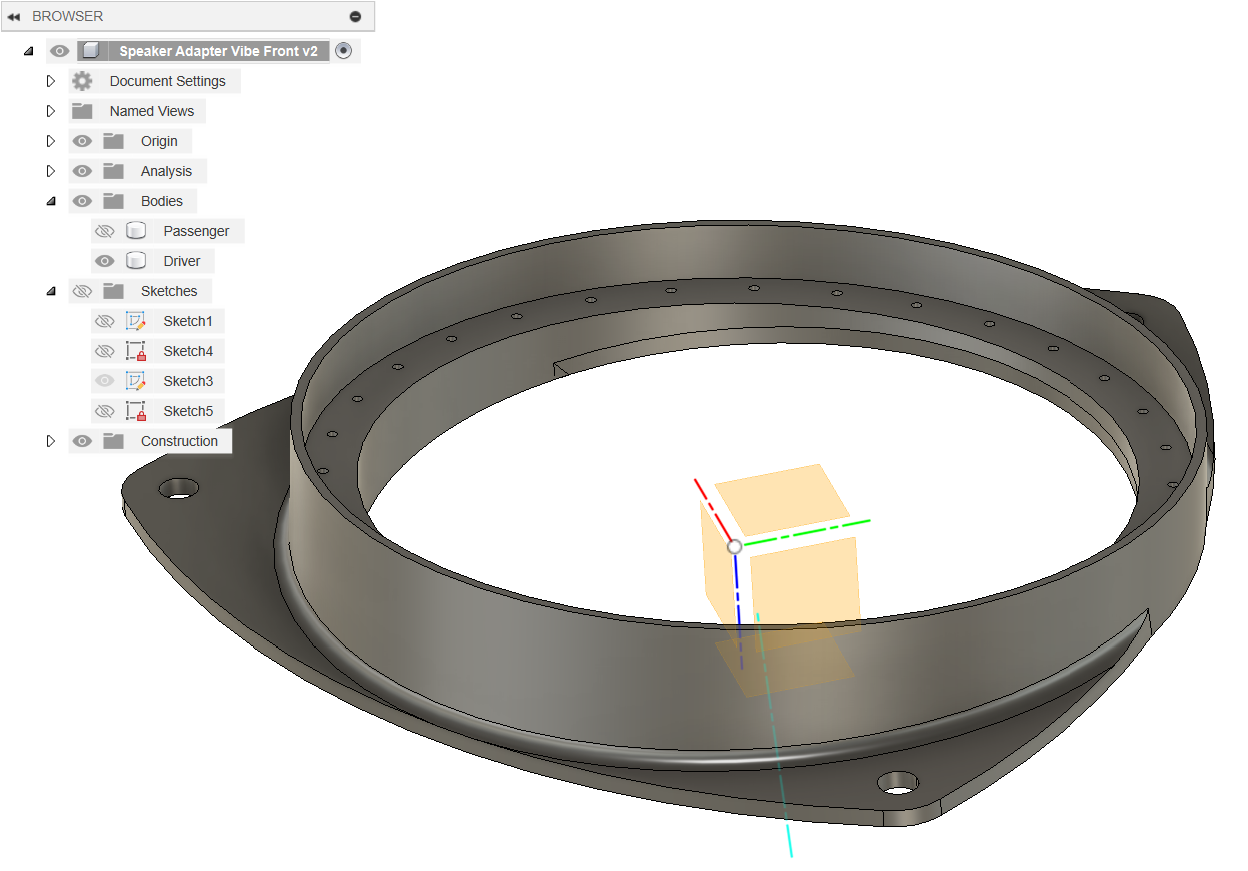

I'm starting a thread to journal my progress on my daughter's 2003 GT Base stereo upgrade. I'm keeping to a small budget and not going overboard (easy for me to do). So, let's begin. I removed the stock speakers and noticed they are the cheap bracket/speaker combo; those gots to go! I designed and 3d printed some brackets. I managed to put in a 5.5deg tilt for imaging. Here's an example:
They fit perfectly.

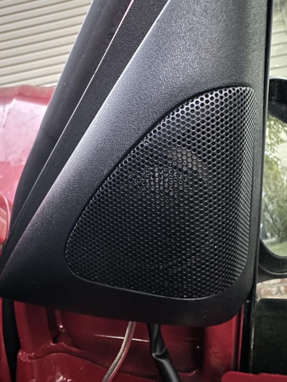

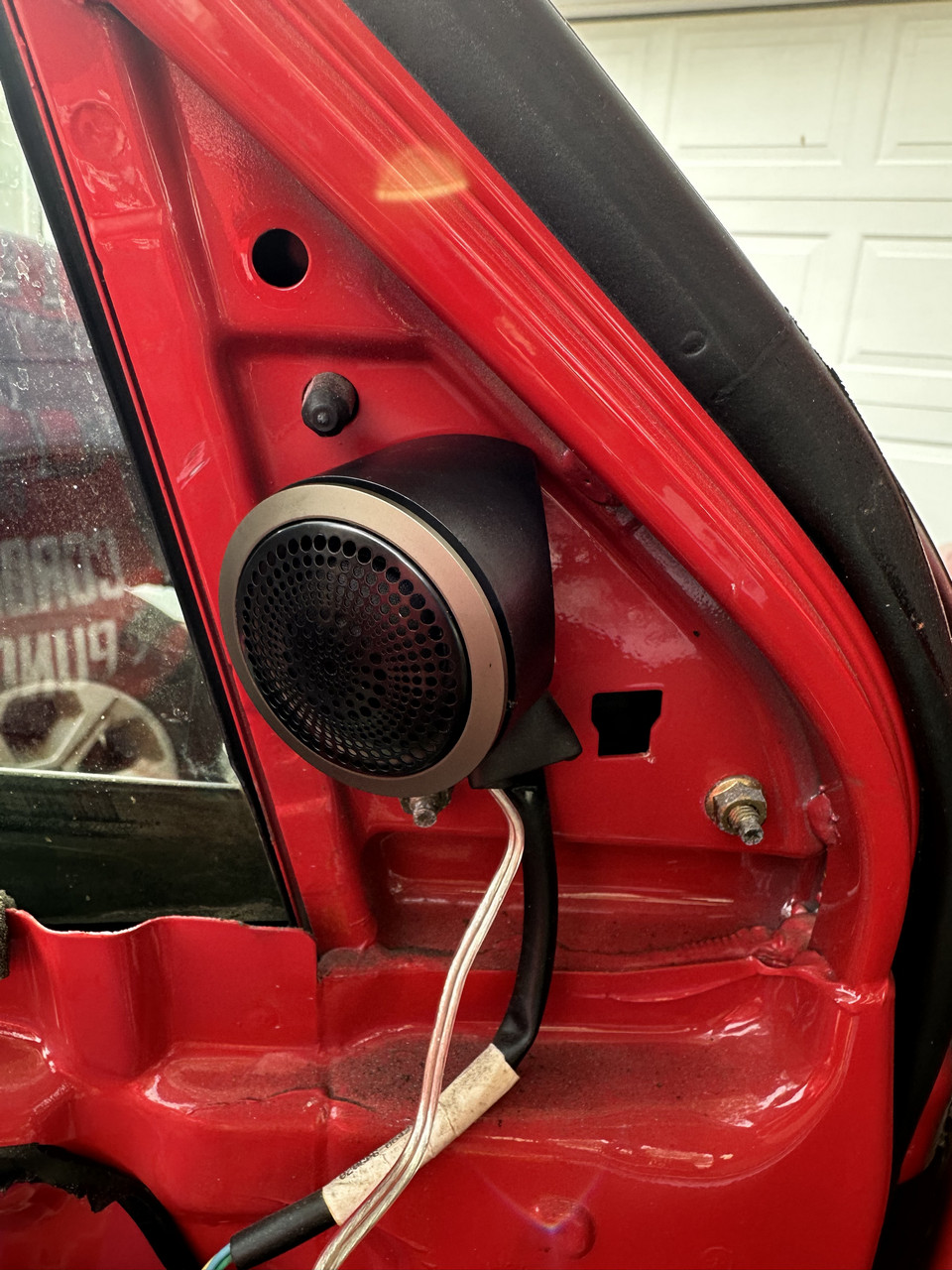

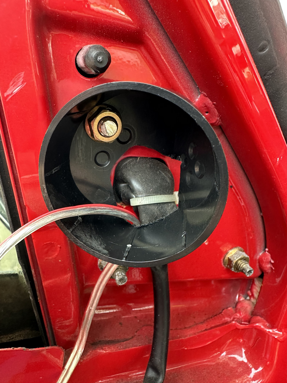

Going to the junkyard, I scored some tweeter pods and the subwoofer. I'll post updates regarding the subwoofer. The tweeters in the component set are much larger than the factory ones. I didn't like their angle positioning either, so I removed the grills and dremeled as much I felt necessary to keep structure to hold the grill and allow me to improve the position of the tweeter.
I managed to use the pillar pods with the set to hold the tweeter in place with some basic dremel modifications; I'll post a pic when I finish the other side. After repainting the grills with satin black and reinstalling them, I'm very happy with the results and new angle.
I'll post the STLs for the brackets. Now, if someone doesn't have access to a 3d printer and would like a set, DM me and we can work out the logistics. Hopefully, I'll get more done to share.

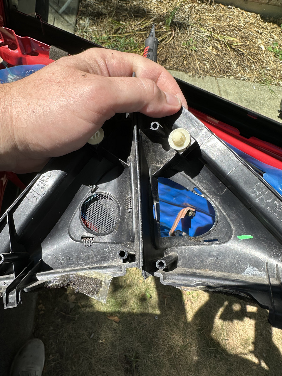

More progress today. I have a road trip Wednesday and hope to get this done sans the subwoofer. Here are some more pictures of the tweeter bracket that came with the components I fitted behind the factory bracket.
I designed some brackets for the rear door panels as well.
I can't believe the grill is the size of a 6.5 on the face, but it only has an open to support a 5.25. Seriously?! I may go to the junkyard and grab some door panels for the upgraded stereo just to have the true 6.5 support. The window buttons can be fidget devices. :lol:

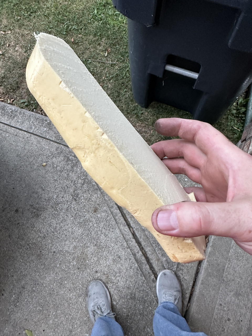

I'm also concerned about the front door panels. The brackets are tall enough to rest against the door panel in the bottom corner. That could cause vibration or excursion collision, so I may print out some shorter ones to be on the safe side when I return from my trip. I installed the crossovers on the panels that cover where the power window controls are located and didn't realize there is a block of foam that fills the area. Welp, that got chopped in half.

  • The speaker brackets are fine, with no rattle or distortion from excursion collision, so I'm leaving them as-is, but I will release the STLs with shorter options since all speakers are not created equally.

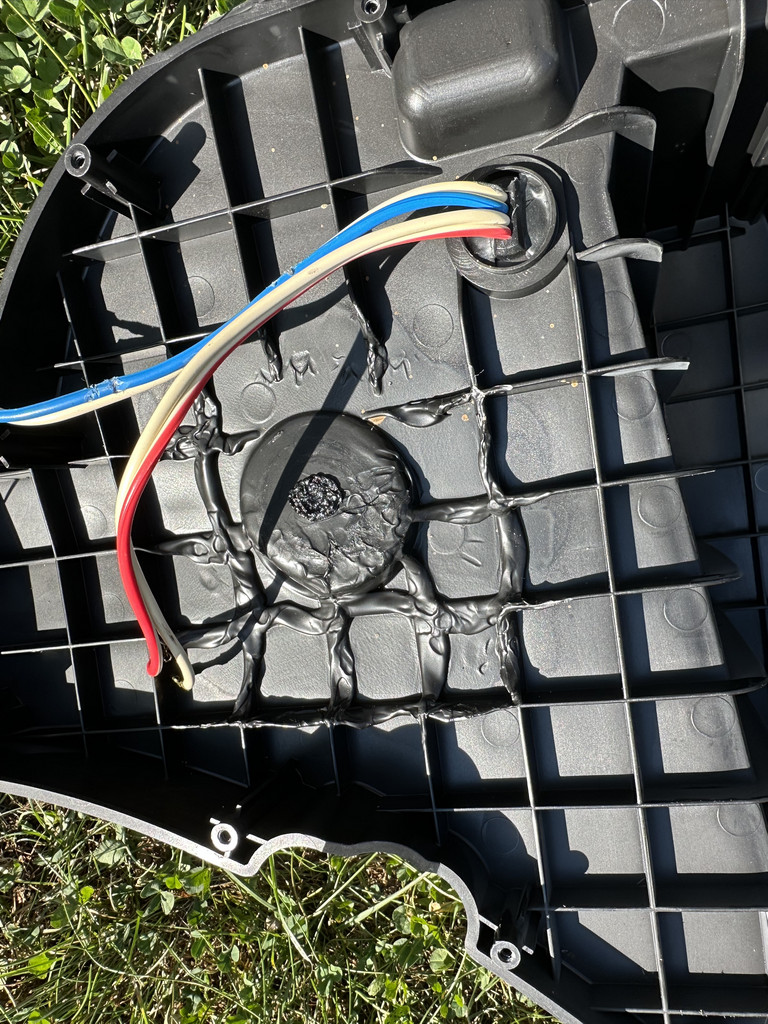

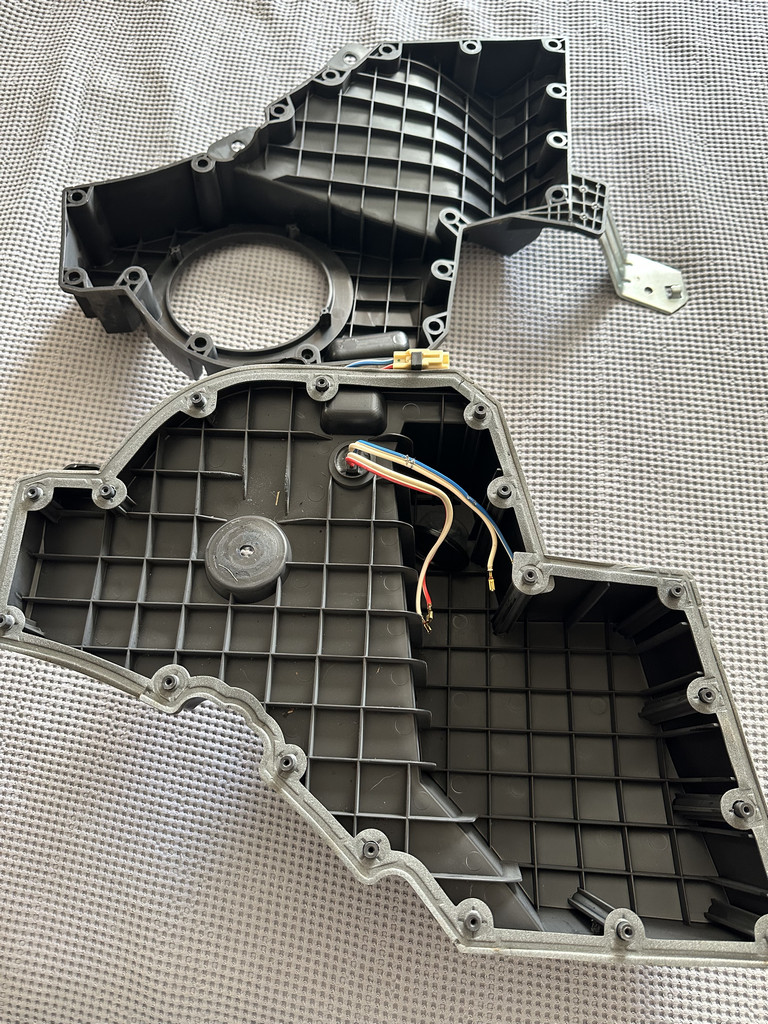

I should have taken a few more pics of the subbox, but this should be enough to get the point across. The box itself is held around the perimeter with many screws and one bolt through the back of the speaker. You definitely want to remove the bolt on the speaker before removing the screws around the speaker surround. The speaker is surprisingly not that bad, and shocked it's a dual voice coil.

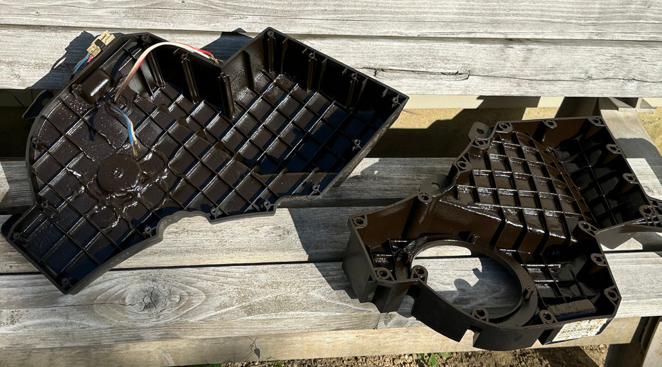

I picked up a Skar Audio EVL-65 in hopes I could fit it, but that definitely was NOT going to happen! So, I spent some extra pennies and picked up what now I believe is the BEST replacement choice, a Kicker CompRT 6.75" DVC 4ohm. The speaker touches the back, so I would say the MAX mounting depth in this enclosure is 2-3/4". The cage and magnet on the Kicker is wider than most speakers and happens to be vented. I used a hot gun to flatten the fins and a 3d printing pen (using ABS) to fill in the bolt hole.
Happy with the fit and preparations, I sprayed the inside with underbody spray.

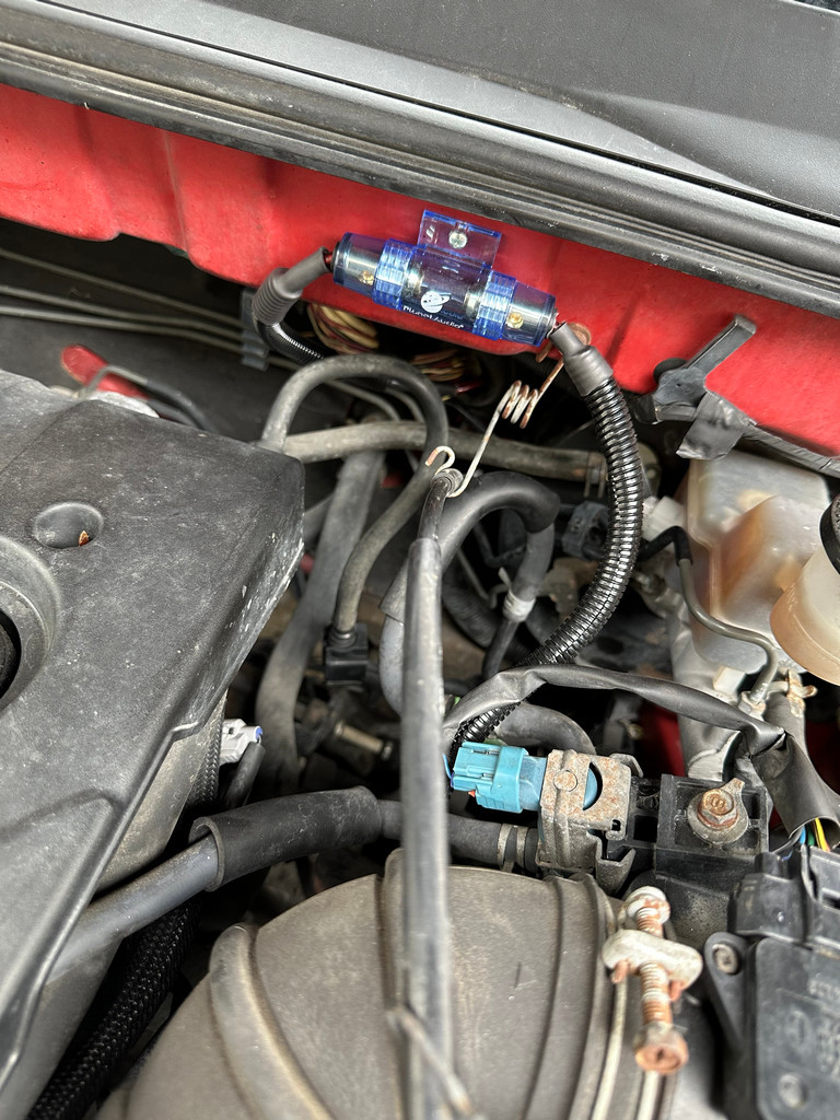

It doesn't work! Do'h!!! Cause I forgot to put the fuse back in the fuse holder under the hood!! Which, btw, you can't tell except for the holder mounted on the firewall.

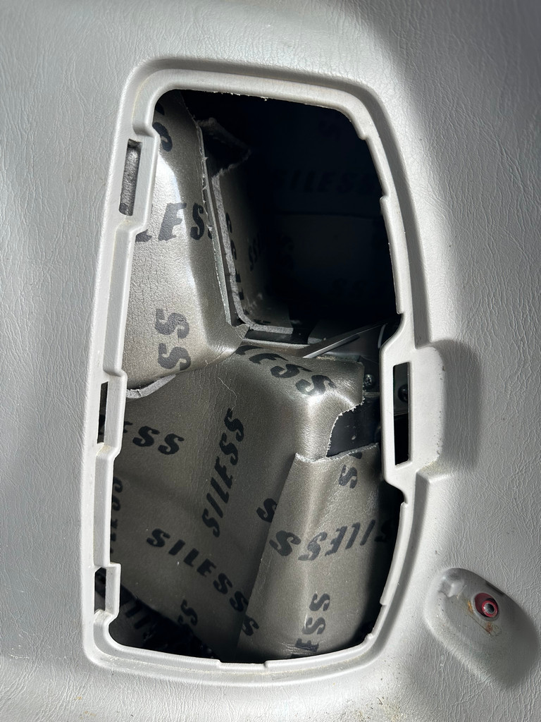

How does it sound?! Well, I haven't spent the time to tune it, yet, HOWEVER, I am thrilled with the performance out of all the budget components (Kicker being a budget component is subjective). What's next, you might be wondering? The headunit I purchased has a sub out, but it's nothing more than left channel out with zero bass controls in the head unit. I purchased a budget bass knob with frequency adjustment and will use proper L/R outs. I'm considering installing it through the coin holder under the parking brake. Stay tuned!
