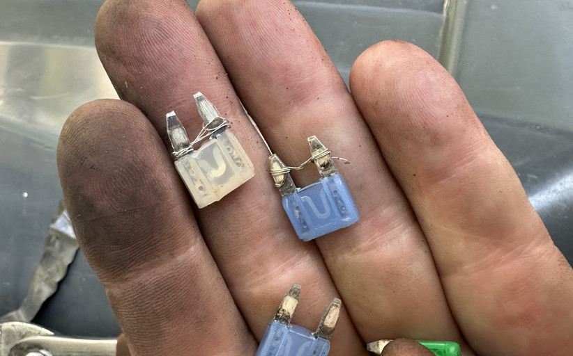

I picked up (daughter says, rescued) an '03 GT Manual for my daughter's first car for a fair price. But as issues keep cropping up, it's turning out to not be a good deal. As I was driving it to the BMV for plates, I lost all power to the cluster, no turn signals (only hazards and lights work), no climate controls and dashlights. The car is driveable, and while I had my truck in the shop, I've been driving it. Of course, I metered the fuses. Figured I would be fine until the weekend when I had more time. Well, it's the weekend, and I actually didn't make it. The car died (actually, I killed it in drive-thru, do'h, been awhile since I've driven a stick), and it was completely dead - battery drained. Fortunately, clutch-popped back to running again. Now, I removed, dremel wire brush, electrical contact cleaner, etc.., the ground points after giving the battery a day to charge. Car is starting again and driveable (maybe until the battery dies again. πŸ€”) Now for the (removed)'d off parts. I rechecked all the fuses by pulling them out (hey, maybe some corrosion in the contact since I used the test points on top of the fuse the first time), and how be damn, most of the fuses were jumpered.
I'm about to seek out a cluster (I prefer the red/white over the red anyway) to see if that's a prob and rip out the POS aftermarket stereo that doesn't work anyway (may reveal a shady wiring job behind. πŸ€·β€β™‚οΈ). Am I on the right track? Or, is there something else I should be taking a look at?

secondly, what kind of idiot wraps wire around fuses?

Wow. Welcome to GenVibe and thanks for sharing this nightmare with us. That's a first that I've ever seen and pretty disgusting to say the least :o You're lucky that the cars wiring hasn't melted or caught fire yet with those fuses being jumped. Hopefully someone GAVE you this poor Vibe as it sounds like it needs a lot of TLC. Definitely get it up & running as these early Vibe GT's are becoming rare and when running great, are a fun reliable source of transportation :D

Make sure each fuse block has the right fuse! Don't trust what is in there now.
Anyone who would jumper fuses like that would also happily put the wrong ones in, also.

Oh, for sure, you can see others in my hand. I purchased a kit and am pulling all the mini fuses out and replacing them according to the manual with no regard for what is in there for both under the hood and dash. My replacement gauge cluster arrived, so I will likely tear into that as well, starting today, hopefully.
