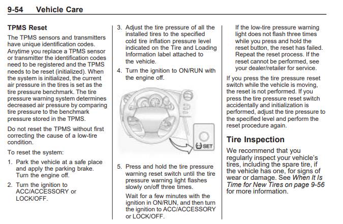

Could be one of the sensors was damaged by the new tire install. Did you try to reset the TPMS system? Found this in the 2010 owners manual (from viewtopic.php?t=755 )
If that doesn't work, then maybe go back to where you had the tires installed and tell them they screwed up.
Then, of course, as long as the tires are at proper pressure and you check it regularly, you should be ok to drive

Awesome find J-mon. I had no idea this reset button even existed and I've owned my 2009 Vibe GT for 13+ years! :o
