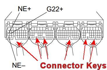

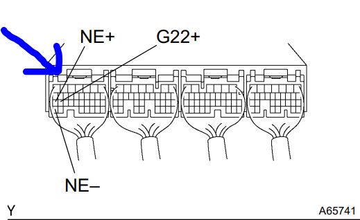

I attached the 03 matrix PDF for P0340, shows the ECM pinout for NE+, NE- and G22+. Pretty good chance it applies to your 07 Vibe

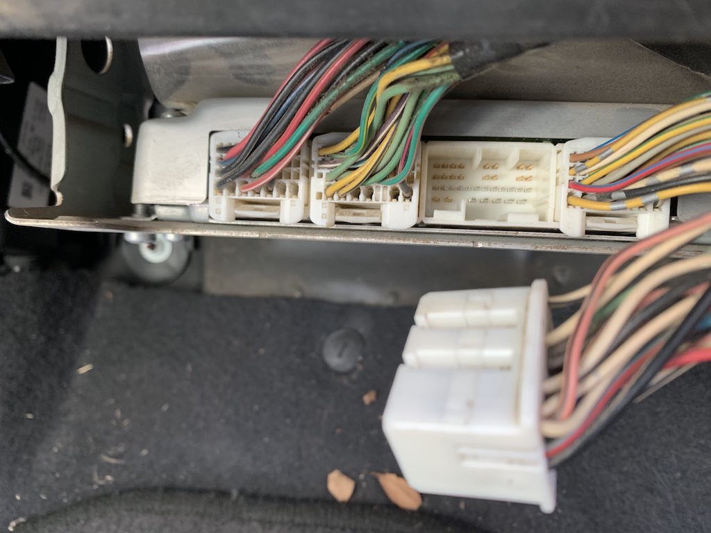

Thanks for the diagram. So when I look at my ECM it appears that the connectors are upside down from the picture below. Is there some way to verify I am testing the right connector? I guess I can measure and then disconnect the camshaft sensor and see if it's open (assuming it's not open to begin with). I'll try and take a picture of the ECU with the connectors. Based on the picture the tabs are all I have to determine which connector to pull?

Orient the picture using the locking tab, and the larger set of contacts along the "top" row. And when you unplug the connector to look at the contacts, everything will be mirror imaged. You'll also notice that the four connector bodies are slightly different--each has a different number of contacts. You can use that feature to be sure you have the right connector body.

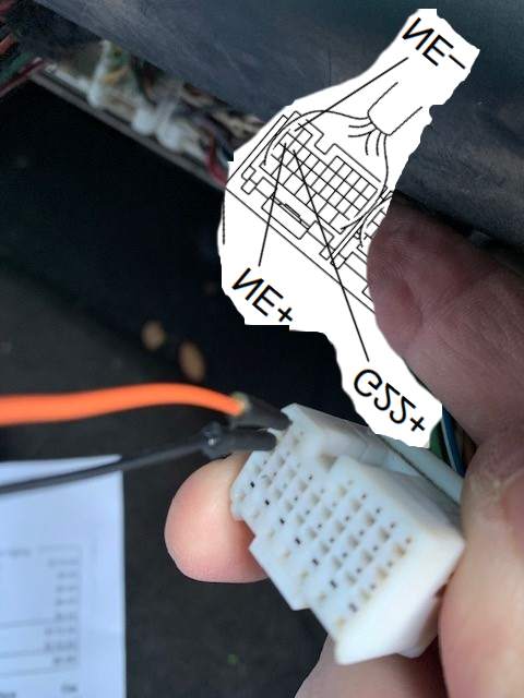

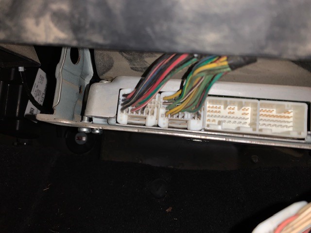

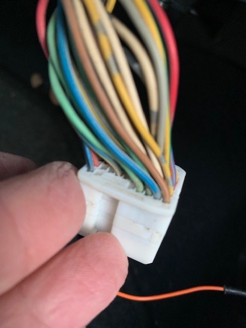

OK, so I finally got some time to try and troubleshoot the wiring. It appears that my ECM is upside down from the picture.
I thought I pulled out the right connector and measured the resistance between NE+ and NE-. However when I went to measure between NE- and G22 and nothing. I then noticed there are actually no wires where I thought G22+ should be.
I wish there was a better way to verify the wire connector and pins. Am I looking at the wrong connector or pins?
I am tempted just to replace the ECM since. Maybe I'll try and unplug the battery for a while to try and reset things and then try to restart.

You can tell that you are testing the right connector because of the connector keys, the notches in the connector plastic bodies that prevent plugging them into the wrong spot
You can see that only one of the four has a wide notch next to only two pins (the leftmost connector in the pic above) That diagram is of the connectors on the ECM, the cable end connector is a mirror image
I cut out that part of the pic, mirrored it, rotated it some to line it up better with your pic, and put it on the pic you posted showing which pins you were testing.

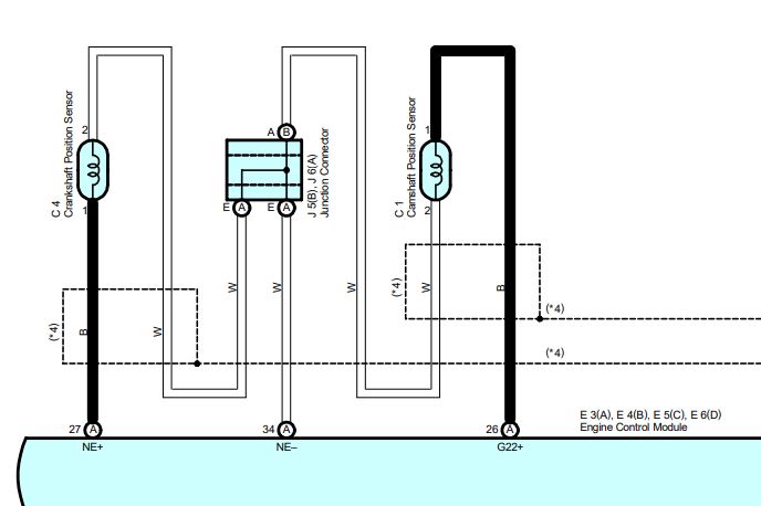

Pretty sure you have the orange wire in pin NE- and the black wire in pin NE+ According to the wire diagram you posted, that would be testing the crankshaft position sensor, to test the camshaft sensor, you'd need to measure between G22 and NE- (move the black lead one pin to the right)

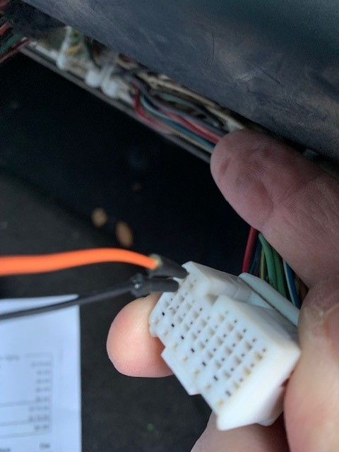

Yes, I tried moving the wire to the right but got nothing then I looked at the back and there were no wires where I thought G22 should be.

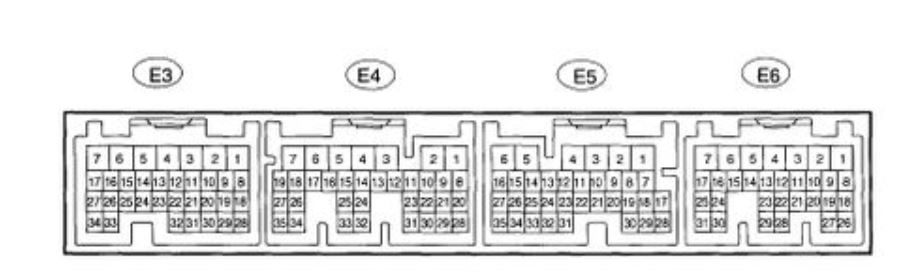

The wiring diagram you posted in your first post above matches the 2003 Matrix wiring diagram. I also have an official paper service manual for a 2003 Pontiac Vibe, and the connections for the crank and cam sensors match the diagram above. Connector "A", with cam between pins 26 & 34, crank between 27 & 34

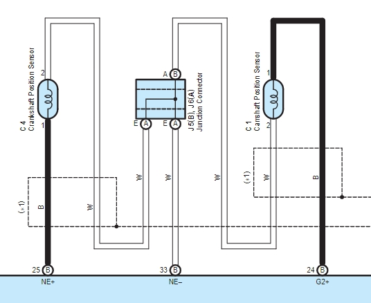

However, I found a Toyota Matrix wiring diagram for 2004-2007 at cardiagn.com and its different
shows crank between pins 25 & 33, cam between 24 & 33, but on connector B
Your picture shows no wires on pins 25, 26, or 33 for connector "A" . Also, both Toyota diagrams and my Vibe diagram indicate that the common return for the sensors is a white wire, and the other wire for each sensor is black.
Maybe its different between the 03's and 04-07's Does it look like there's black wires in pins 24 & 25 in the wire bundle for what your pin number diagram calls "E4"?

OK, so I have now verified the camshaft sensor wires are OK. I also verified that the 2004-2007 wire diagram for the matrix is the correct one. The wire color at the computer does not match but the wire color at the sensor is black and white. I verified wiring is correct by disconnecting the sensor and then connecting it again. ECU connector pins 24 and 33 were open circuit with the sensor disconnected.

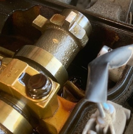

That code does not indicate a timing fault, rather a position sensor low input. If you trust the sensor and the harness and the ECM, the only thing left is the reluctor ring on the intake camshaft. I'd remove the valve cover and check that out before giving up.
Re: 2007 Cranks but no start
Posted: Wed Feb 01, 2023 11:43 am
by joshbk
I did take the valve cover off initially cause I was hoping it was just the ring as you said however when I saw there was no ring to adjust, just a camshaft with a knob for the sensor. I did not go further when I saw I would have to deal with camshaft timing.
I did not want to mess with the camshaft. I should have checked the timing however it was hard to see the crankshaft mark. I don't feel comfortable doing anything with the timing chain so I will probably just get rid of the vibe. Hate to see it go but its been sitting since October.
