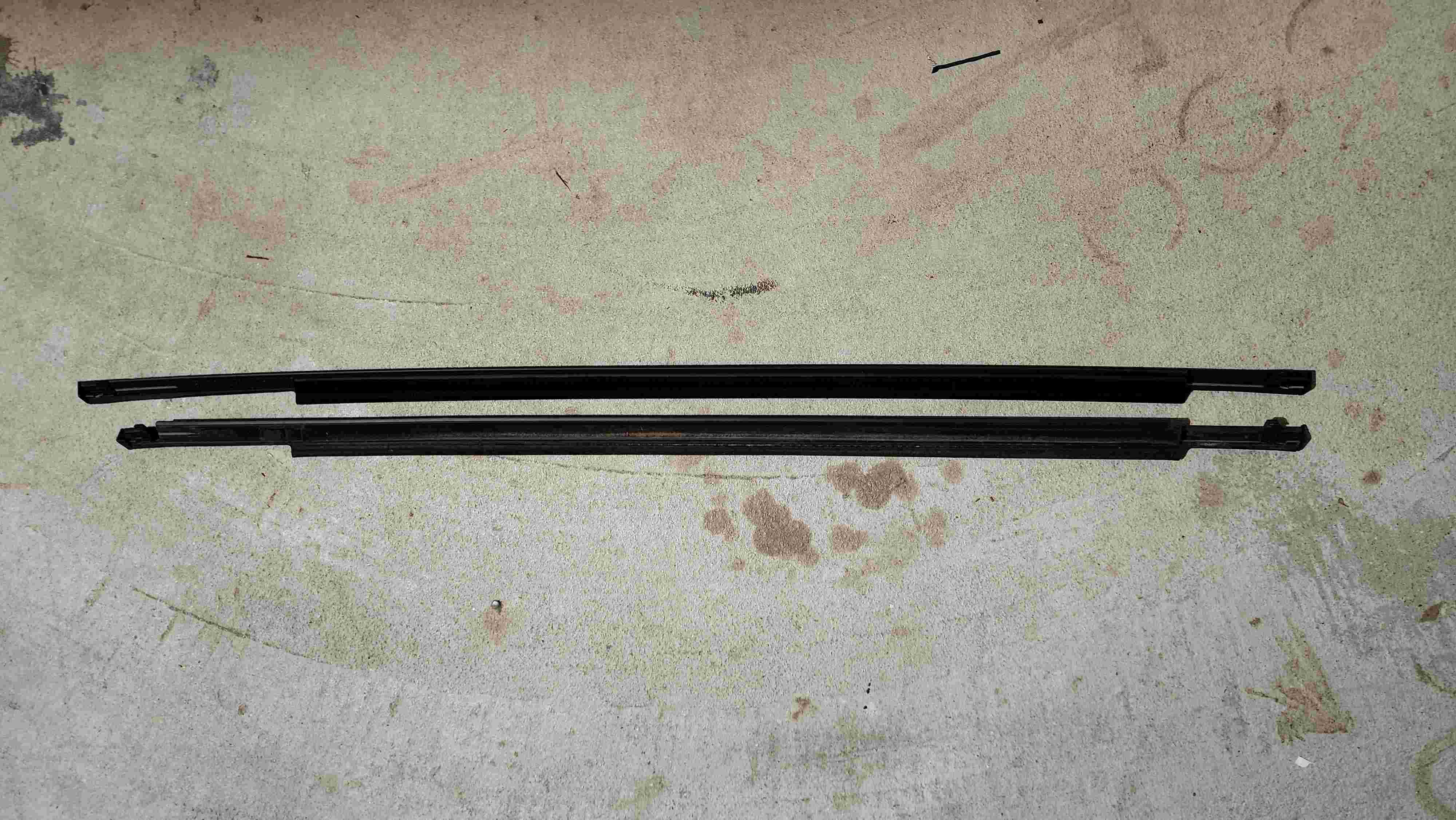

I just replaced the four belt mouldings on my 2009 Vibe GT with the Toyota Matrix mouldings. The front mouldings are an exact fit. The rear mouldings are a bit over an inch too long so need to be trimmed at the back end, which is relatively simple with a box cutter. Replacing all four took me maybe 45 minutes total. A few notes:

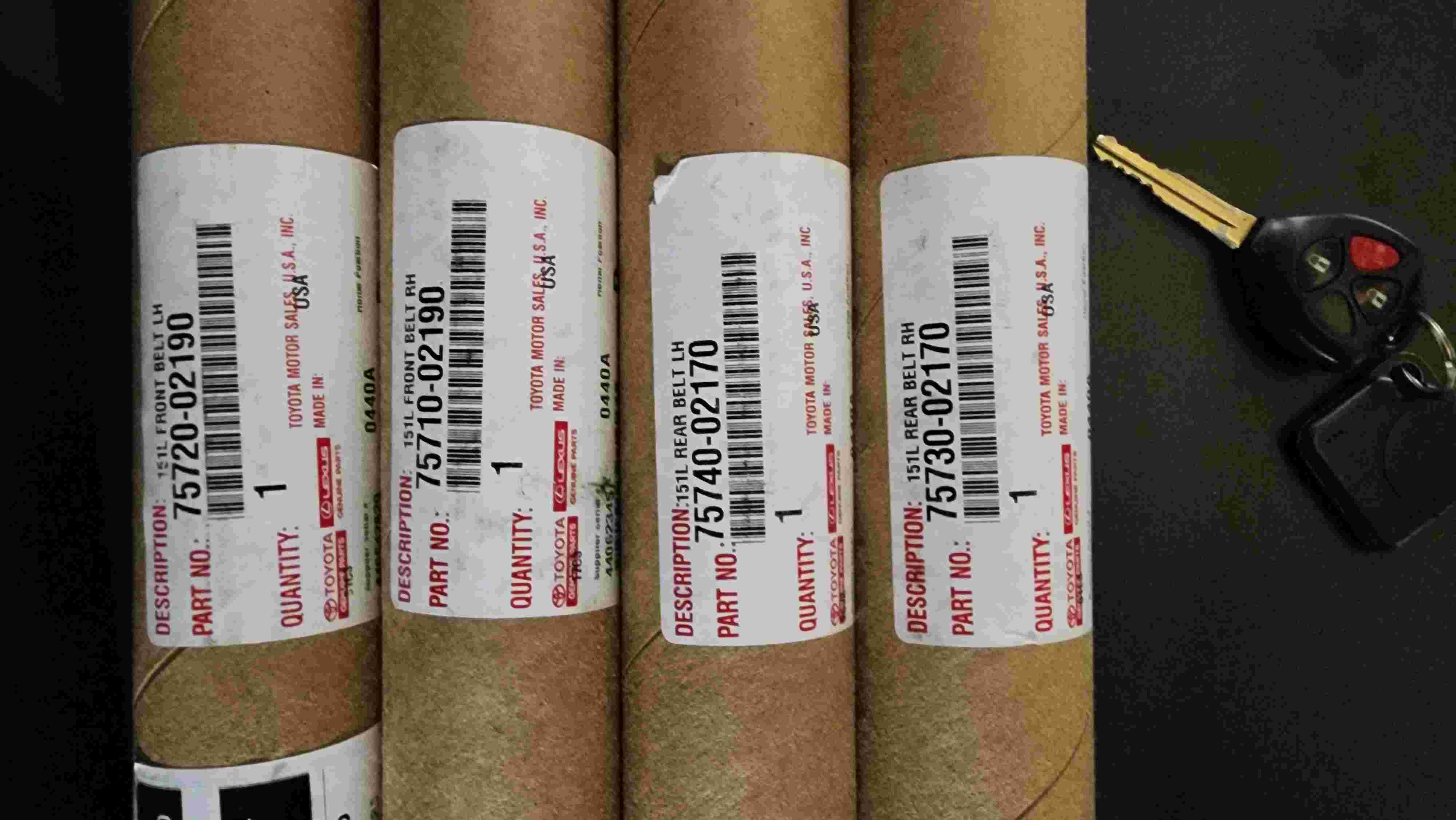

Here are the Toyota mouldings that I used:
Toyota Belt Mouldings for 2010 Vibe GT.jpg (205.67 KiB) Viewed 5730 times
I found it helpful to roll the windows down. The front mouldings come off and go on just like the one shown in that 2011 Toyota Corolla belt moulding replacement video on YouTube. There's just one clip, at the back. The rear mouldings have two clips, one at each end.

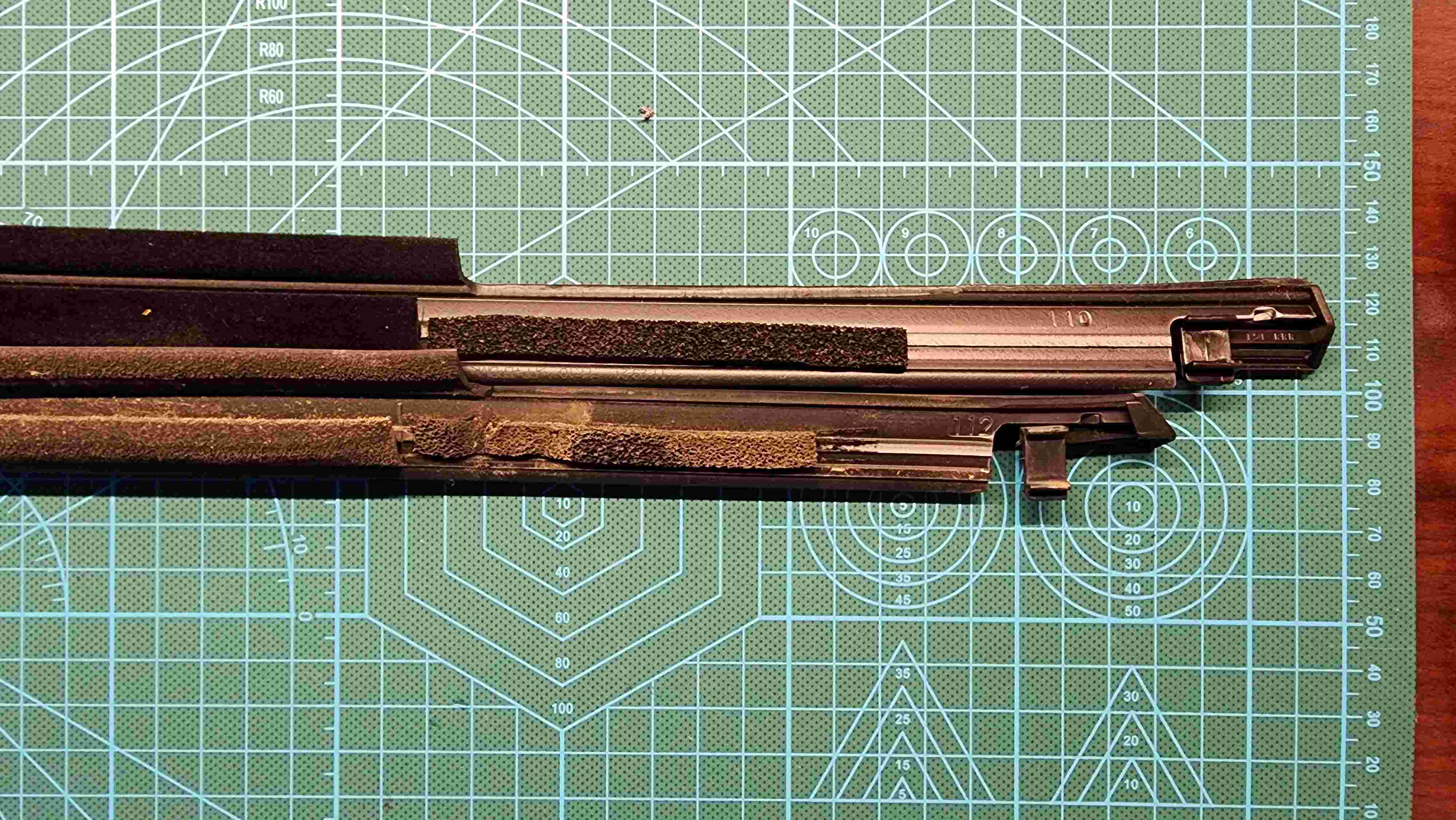

The rear Toyota belt mouldings are bit over an inch too long.
Rear Belt Moulding Length Comparison.jpg (346.19 KiB) Viewed 5730 times
I found it easy to use the old moulding as a guide to trim the new one.

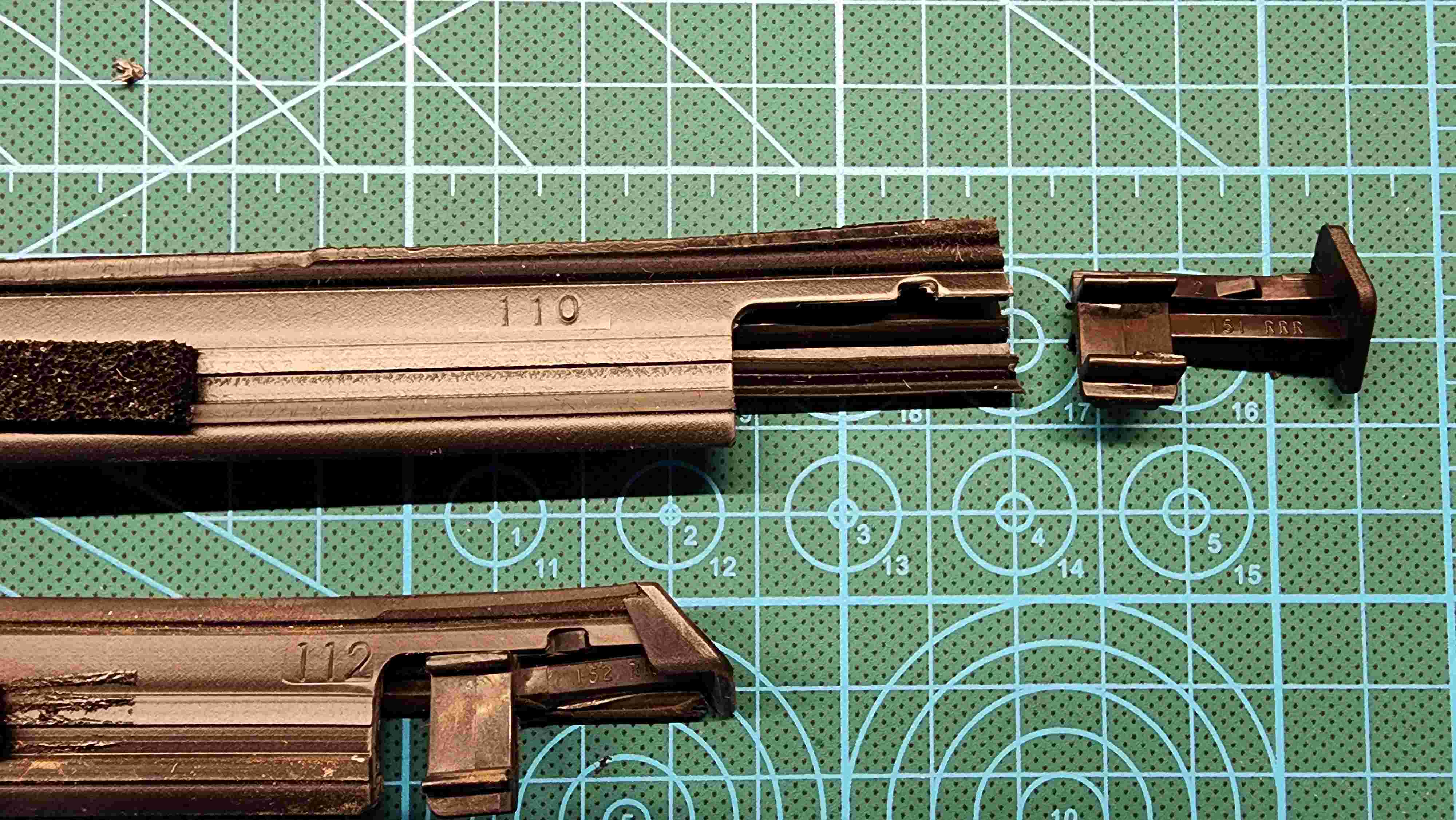

Before you trim, remove the clip from the back end of the belt moulding, them trim to match the original. Note that the Toyota clip has a slightly different angle than the original. I decided to use the Toyota clip, so trimmed the angle accordingly. To get the cleanest look on the outside of the moulding, its best to trim it from the inside by first cutting the big notch to match the original, then shortening the moulding by making the angle cut. Note that little notch that holds the clip in. You can easily cut that out with your box cutter.
New Rear Moulding with Clip Removed Before Trimming.jpg (374.15 KiB) Viewed 5730 times

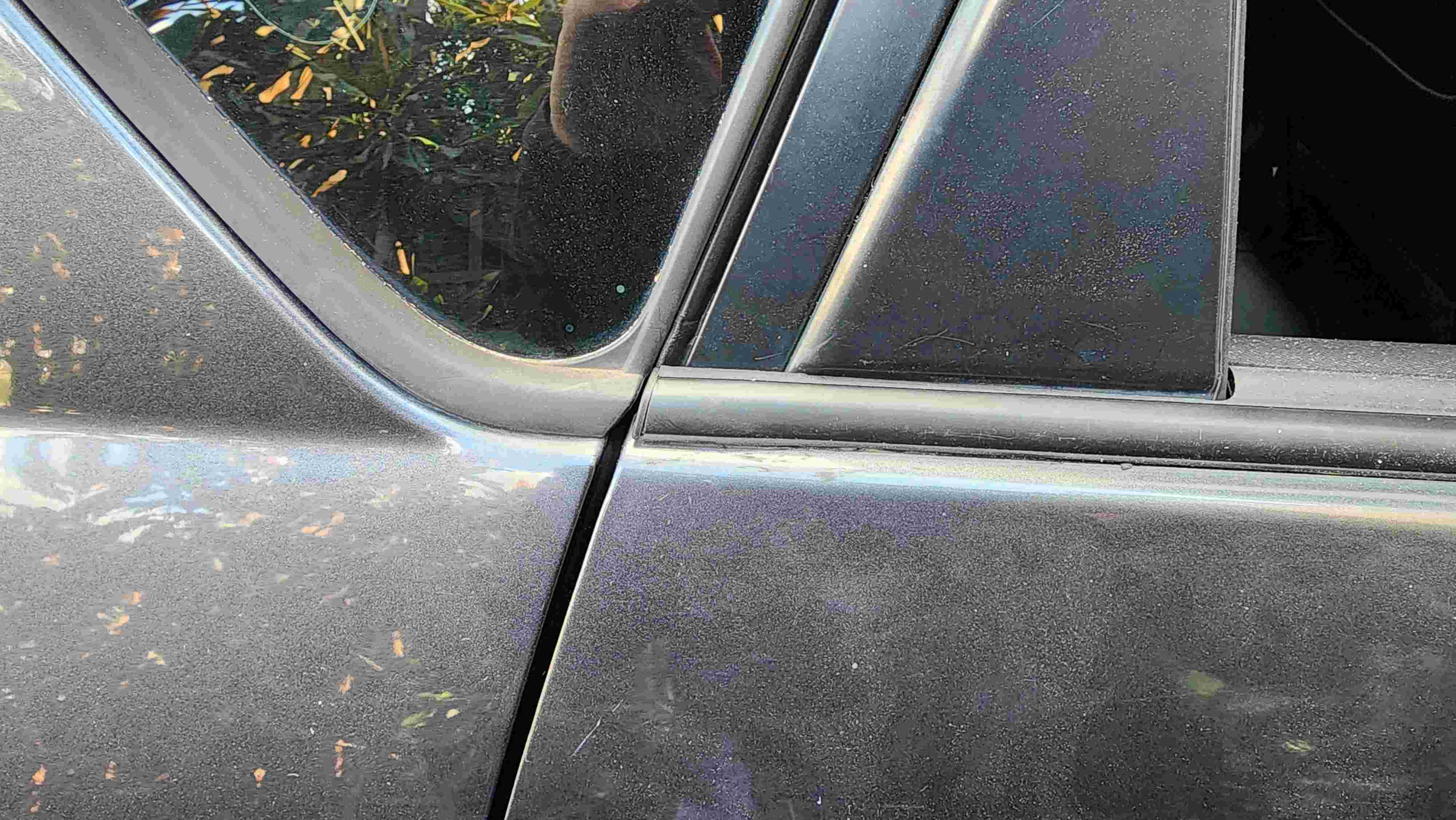

Here's how the final trimmed version came out on the right rear window. Note that the angle is slightly off because I used the Toyota clip.
Rear Belt Moulding on Car.jpg (352.35 KiB) Viewed 5730 times

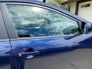

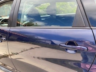

Here are the photos of the window belt moulding install... left rear and right front....
vibe window 2.jpg (23.76 KiB) Viewed 5478 times
Left rear
vibe window 1.jpg (25.11 KiB) Viewed 5478 times
Right front.
As was described by previous poster Spider the right front was easy peasy. Both of the original belts had been glued in with something so had to take a plastic putty knife and scrape but came off very easy... Then cleaned both areas with household cleaner to get any dirt, oil and grime off.
The left rear was a bit more challenging.... I used a fabric mat cutter to measure but still didn't get cut exactly right the first time. Recommend use a brand new blade on box cutter and be very careful. I ended up not getting the angle for the end clip exactly correct but nothing that a bit of silicone couldn't fix.
Very happy with the way it turned out.
With the extra cleaning steps and my struggling with the new left rear strip took me about 2 hours to install both new strips.
