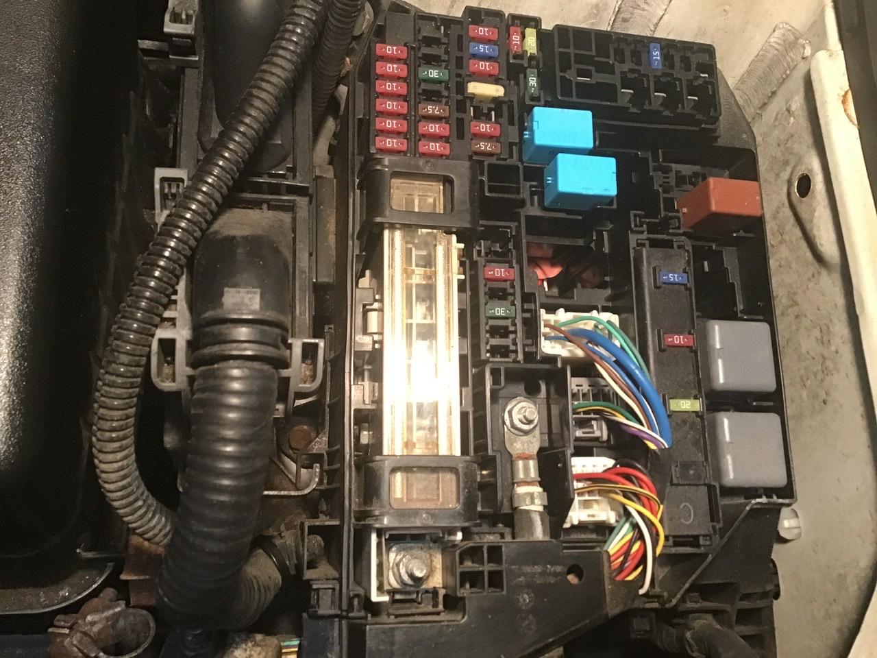

Hi everyone, This is my first post ! I bought a 2010 Vibe last week and have 2 lights on the dash , one is the ABS light and the other is the VSC OFF.
I have scanned the OBD and there are no codes for either of these and pushing the switch for the VSC on and off does nothing.
The one thing that I have found that is puzzling is my fuse box under the hood. Looking at it and comparing it to the pic in the owners manual they are different. The manual shows there is supposed to be a couple 50 Amp fuses on the left side of the box and mine has a clear plastic cover over this area and appears to be no fuses or anything under the cover.
I have searched images of the fuse block online and have seen none that look like mine ?
I am including a pic of my fuse box and maybe someone will understand what I have ?
I cannot find how the clear top panel is removed and don’t want to break it forcing it with a screwdriver.
Thanks in advance for any help on this or if I am barking up the wrong tree with the issues I have. Jedman

to me it looks like the picture of the 2010 Corolla fuse box, as seen at https://community.cartalk.com/t/2010-to ... -on/118587

You need to have a good reader that does the C (chassis) codes, not just a cheap reader that only does the P (power) codes. The codes you are looking for will start with C-xxxx.
With both lights on, VSC and ABS, I would start looking at the wheel speed sensors. The '09-'10 models also had a Technical Service Bulletin (TSB) out about the rear speed sensor extension cables connections getting corroded and need replacing if that is the issue. First thing is to have the thing scanned to get the chassis codes. A good reader will show you the signals from each wheel speed sensor.
