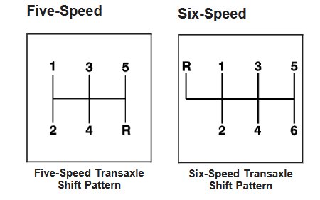

3200 rpm @75 mph is a closer match to the 6 speed, but I don't understand you only having 5 speeds
When you walk through the gears (say with engine off) which shift pattern matches your car? (ignore the diagram on the shift lever if you still have the one for the 5 speed)

Hi Joatmon,
Thanks for responding. When the engine is off, the shifter goes like the first pic you have (5 spd original). So, I’m just confused because there’s a stamp of c60 on the tranny casing when I bought it. What do think that happened or done wrong? Thanks again. 🙏🏼🙏🏼

Trix04 wrote: Thu Apr 02, 2026 5:35 am Hi Joatmon,
Trix04
Just to confirm, reverse is to the right and down?
It sounds like you got a 5 speed, which might be best anyway. The 6 speed is geared lower with an extra intermediate gear to help the 2Z engine to rev high enough to hit lift more easily, but since it's geared lower, cruising down the highway the engine will rev higher than in a 5 sped, so there's be a small hit to gas mileage.

Hi again Joatmon,
Thanks for the response.
My question really is, the new tranny swap it has c60 stamp on the casing, but it is only shifted like 5 spd ( your first pic pattern). Do you think there’s something wrong during the installation since I don’t do it myself? Do I need to change the shifter mechanism inside the console with 6 spd one? That’s where I’m confused.
Thanks again.
Trix04

Posted: Sat Apr 04, 2026 10:18 am
by joatmon
The shifter is free floating. It has two cables attached, effectively one that controls left to right, and another that controls forward and back, limited in movement only by the levers on the tranny. If the shifter was disconnected from the tranny, you could swing it in a circle.
There is nothing an installer could do to change a 6 speed to a 5 speed. It would require swapping a bunch of transmission internals, which, if possible, would be a ludicrous amount of parts and labor. Might be an interesting project for someone with too much time and money on their hands.
My best guess is that the transmission came out of something like a Celica or a Spyder, and not a Matrix or VIbe. Apparently 5 speeds that are stamped C60 exist - see
https://www.jdmcalifornia.com/product/c ... gbH2haqV5o
There's also mentions of such a thing on wikipedia and in some mr2 spyder forum threads
You got the transmission from somebody, ask them exactly what car it came out of
I can't find clear definition of the gear ratios for such an animal, and some of the internet hints at a chance that some of those might have a limited slip differential, which would be cool to have
