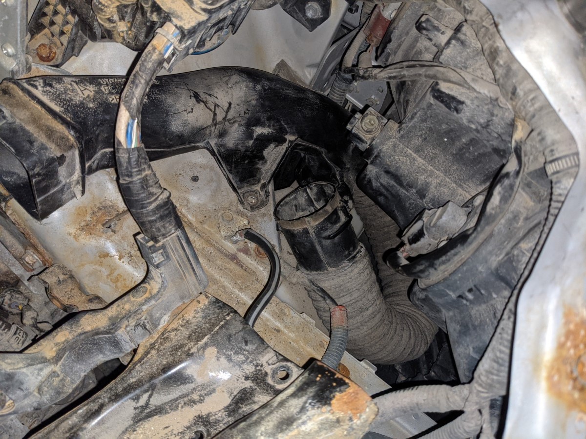

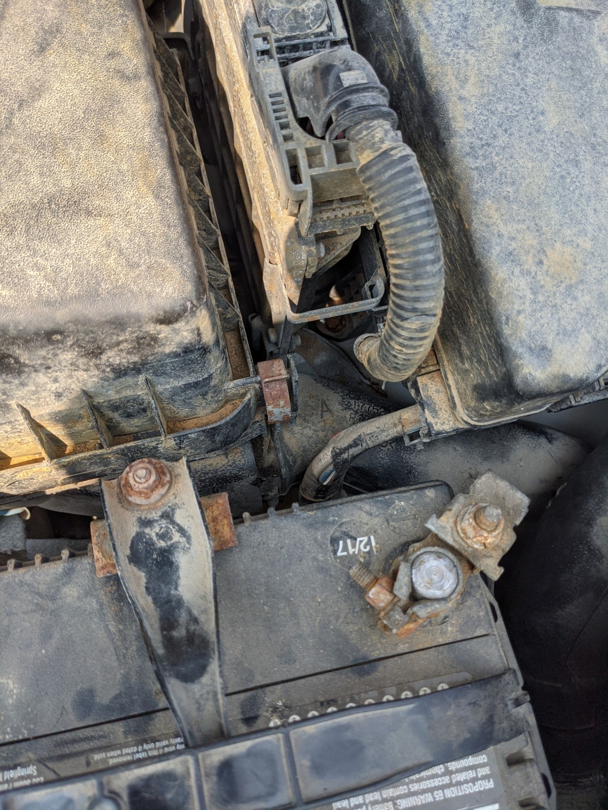

I've recently become the owner of a 2009 Pontiac Vibe for $900, with 153k miles. I plan on fixing her up a little bit before giving the car to my younger brother.

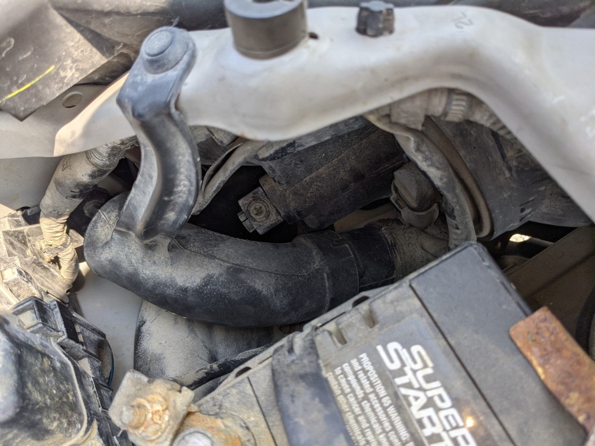

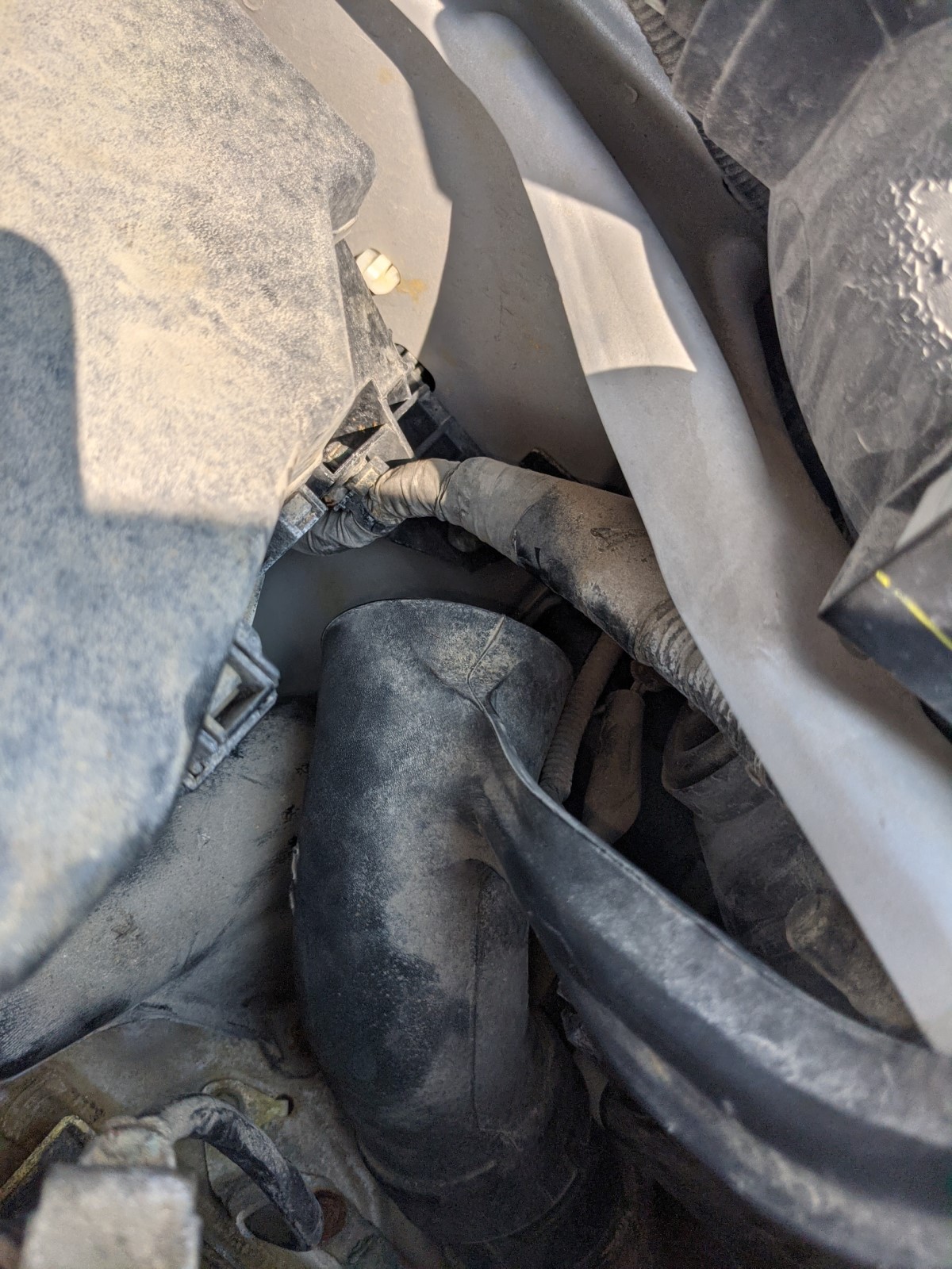

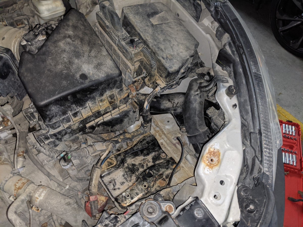

It appears that my intake system seems partially broken, as the intermediate duct doesn't seal completely against the filter box.
Would I need a new intermediate duct here? Is this setup correct? See the attached images.

you don't need that snorkel piece. it helps direct additional air to the airbox, but the car will operate perfectly fine without it.
