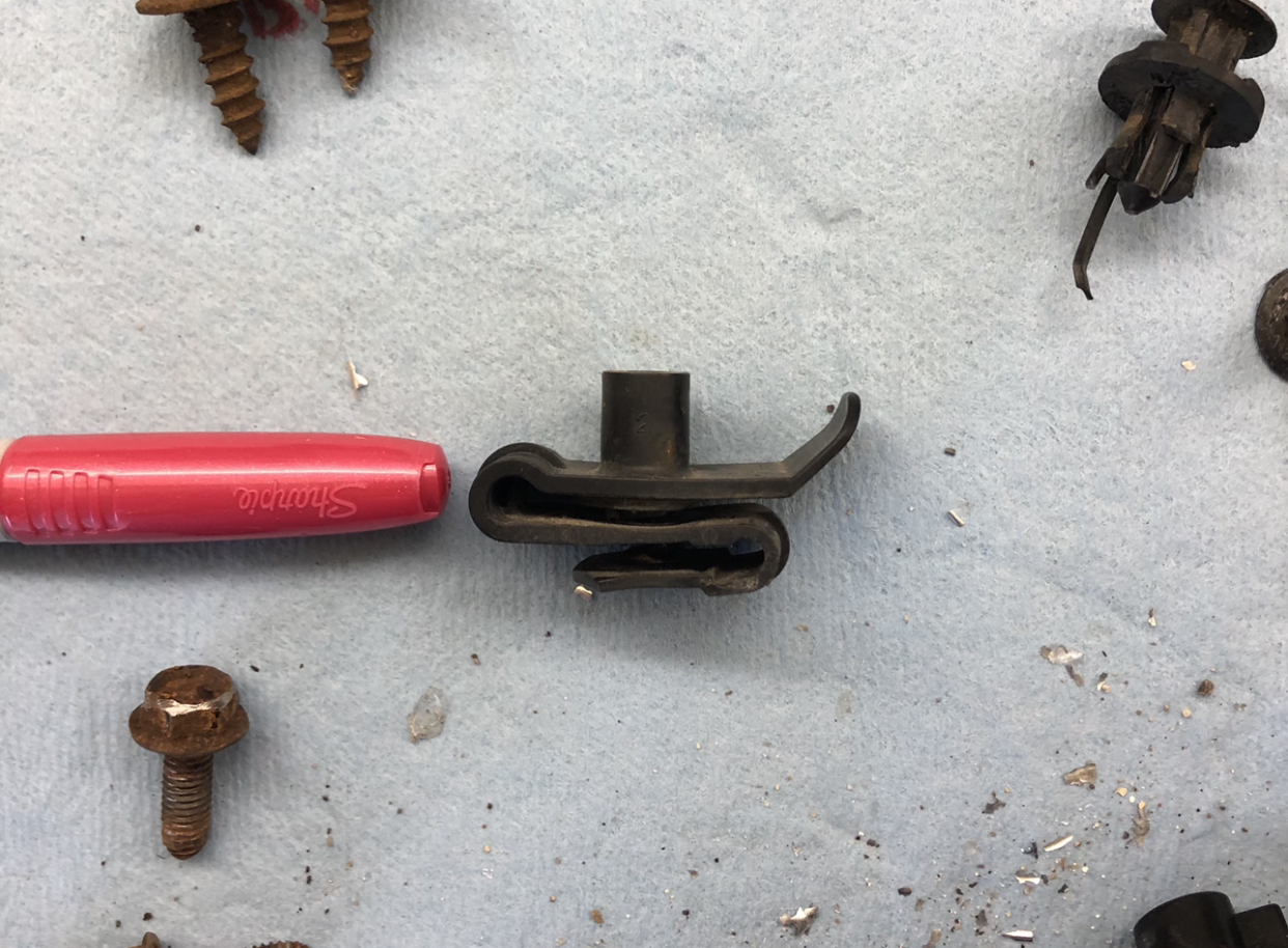

I just did a headlight removal that included taking the front bumper mostly off. While I was working on the passenger side, this piece came off. Does anyone know where it goes?
I’m sure it’s pretty pointless but knowing me, it will be a couple weeks down the road and some annoying rattle will pop up. And it will be this thing’s fault lol.
Bracket
Bracket
Sharpie cap for scale

Ha, ha.... I have one of those pieces in my tool box from my Gen 1 Vibe. It just sits in there taking up space. I'm guessing it might be a bumper-to-wheel well liner clip. Very nice work on the headlights. I just had Sam's Club do mine given their generous warranty.

Lol guess I’m not the only one who got this little part dropped out of the sky. Thanks for the tip, something to hold the wheel well liner sounds just about right. I’ll clip it around some different places and see if I can find a good home

Caretaker wrote: ↑Sun Mar 28, 2021 12:25 pm Ha, ha.... I have one of those pieces in my tool box from my Gen 1 Vibe. It just sits in there taking up space. I'm guessing it might be a bumper-to-wheel well liner clip. Very nice work on the headlights. I just had Sam's Club do mine given their generous warranty.
Found it, turns out you're spot on! If I had kept my mouth shut until I put things back together, I would have figured it out sooner.
This little bracket makes a nice little sandwich: clip, bumper flange, clip, wheel well, clip with post. Then the screw goes through it all and tightens into the post part. Really is a pretty smart way to hold it all together with a screw when you don't have anything to screw into, it's a nut and washers all in one.

Just an FYI ... and some photo proof. Below are good snapshots of that clip and what it holds. Enjoy :D
