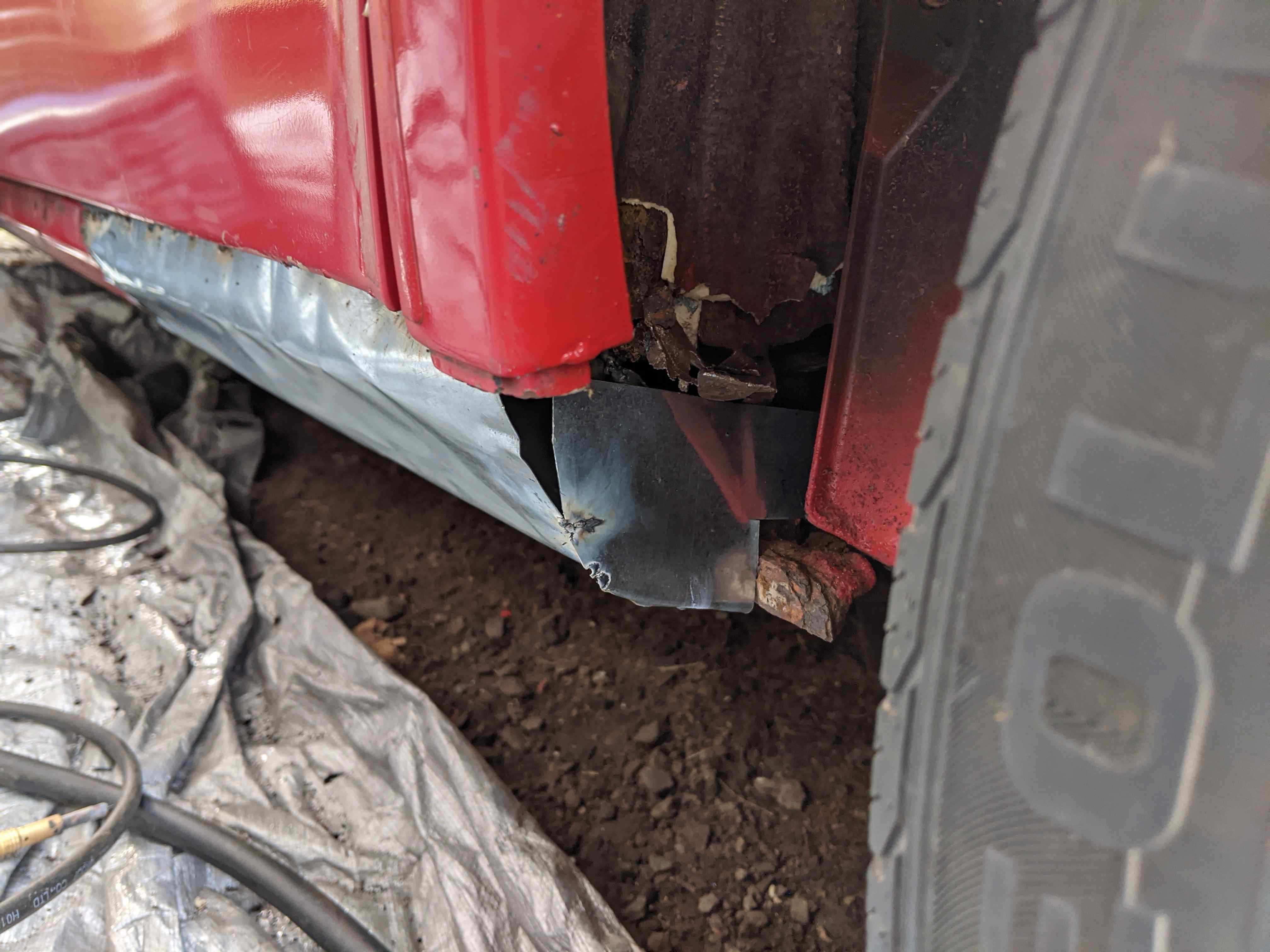

With today being a nicer weather day, I decided to start on my rocker panel replacement. I have some questions, but first I'll start off with the information I have. Replacement/aftermarket rockers don't seem to exist, and from the rocker cover/lip on the rear in the wheel well they seem to be an issue in the saltier places of the world. I was quoted over $2000 to have them replaced at a garage, so I'm tackling it myself. Here is a picture I took, to help visualize the structure and measurements I have taken.
From the inside rail to the outside-most point of the rocker, just under the door, is 4".
From the pinch weld at the bottom to the same point, is 3.5".
From the bottom of the pinch weld to the point just under the door is 6" in height.
The outer rocker is pretty thin metal, while the inner rocker is about twice as thick.
Front to back, the rockers are 72".
As for my questions, I'm trying to decide what the best route is for replacement. I could clean it up and weld a layer of sheet metal as an inner and another as an outer, which is the least expensive and quickest option. Another option I am looking at, due to my offroad background and goals for the car, is to use rectangular tubing. I can get a 72" section of 6x2 tubing for $50. If I double these up and weld in these sections on both sides, am I correct in assuming this will stiffen the body as well as adding some extra protection? I am not too concerned about weight, unless it will be putting to much strain on some of the surrounding metal. My last question, is if there is anything around/behind the rockers to be careful of or remove prior to welding, such as the fuel filler neck. Open to opinions, thanks in advance!

Honestly, I'd go for the first option. Quicker, easier, and your second idea isn't really necessary for all the car is.
Can you CAD or draw up some dimensions for the rockers you make? Angles, bends, etc. I also need to repair some. I wish we could find some that were readily available. I would have been able to save 4 Vibes we've owned that way.

zbyers wrote: ↑Mon Nov 02, 2020 5:38 am Honestly, I'd go for the first option. Quicker, easier, and your second idea isn't really necessary for all the car is.
I picked up some 18 gauge sheet metal today, turns out it's a little thinner than the inner rocker and a little thicker than the outer rocker but it'll do to get me on the road. The plan is to prep the surfaces, tack weld the top of one sheet to the top of the inner rocker, then tack it to the start of the first bend in the inner rocker. With the rocker support still in place as pictured, the tack and the support should allow me to bend the sheet around the first corner. At that point I'll line it up with the factory pinch weld and tack it before finishing up the rest of the welding. I'm planning on following these steps for the outer rocker as well, but I have to wait for some warmer weather this week. For longevity I'm planning on hitting everything in reach with some rustoleum before and after welding. The end of the rockers towards the rear wheel wells are going to be capped with a section of the 18 ga as well, cut to shape with some shears. As I go I'll try to make some measurements and CAD up a sheet metal section that should be useable.

CanadianYeti wrote: ↑Tue Nov 03, 2020 8:26 amI picked up some 18 gauge sheet metal today, turns out it's a little thinner than the inner rocker and a little thicker than the outer rocker but it'll do to get me on the road. The plan is to prep the surfaces, tack weld the top of one sheet to the top of the inner rocker, then tack it to the start of the first bend in the inner rocker. With the rocker support still in place as pictured, the tack and the support should allow me to bend the sheet around the first corner. At that point I'll line it up with the factory pinch weld and tack it before finishing up the rest of the welding. I'm planning on following these steps for the outer rocker as well, but I have to wait for some warmer weather this week. For longevity I'm planning on hitting everything in reach with some rustoleum before and after welding. The end of the rockers towards the rear wheel wells are going to be capped with a section of the 18 ga as well, cut to shape with some shears. As I go I'll try to make some measurements and CAD up a sheet metal section that should be useable.
Awesome. Keep us posted on the outcome and progress pictures.

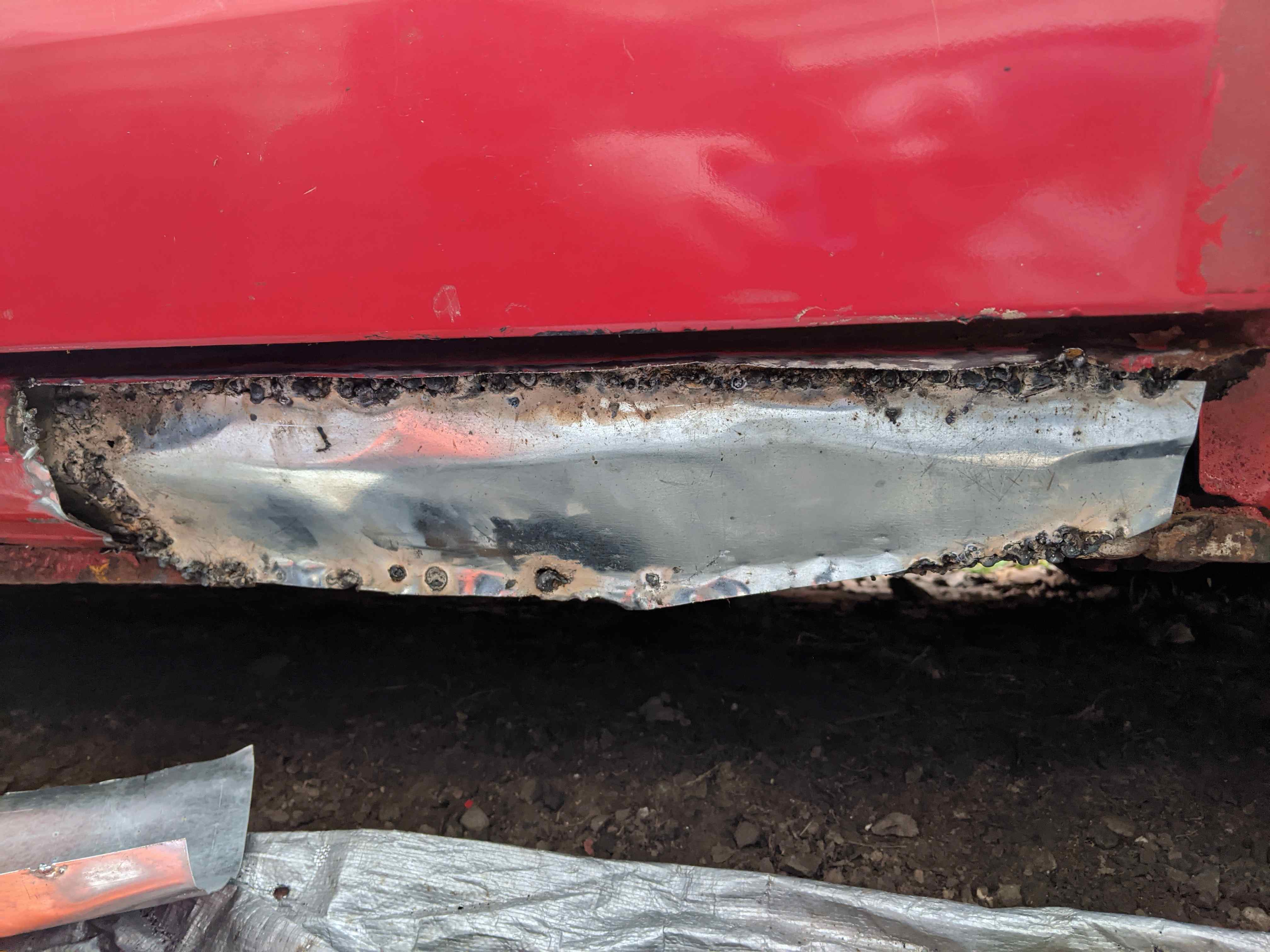

Started welding in the inner rocker today after patching the rot above the pinch weld. It's my first time really welding so the whole process is a new experience (Go easy on my boogery welds :lol: ). I have the sections of rocker I cut out to make measurements and the CAD file as requested, any tips for posting those files or where I should post them? I can tell this might be a bit of a slow process due to weather, but I'll update as often as I can.

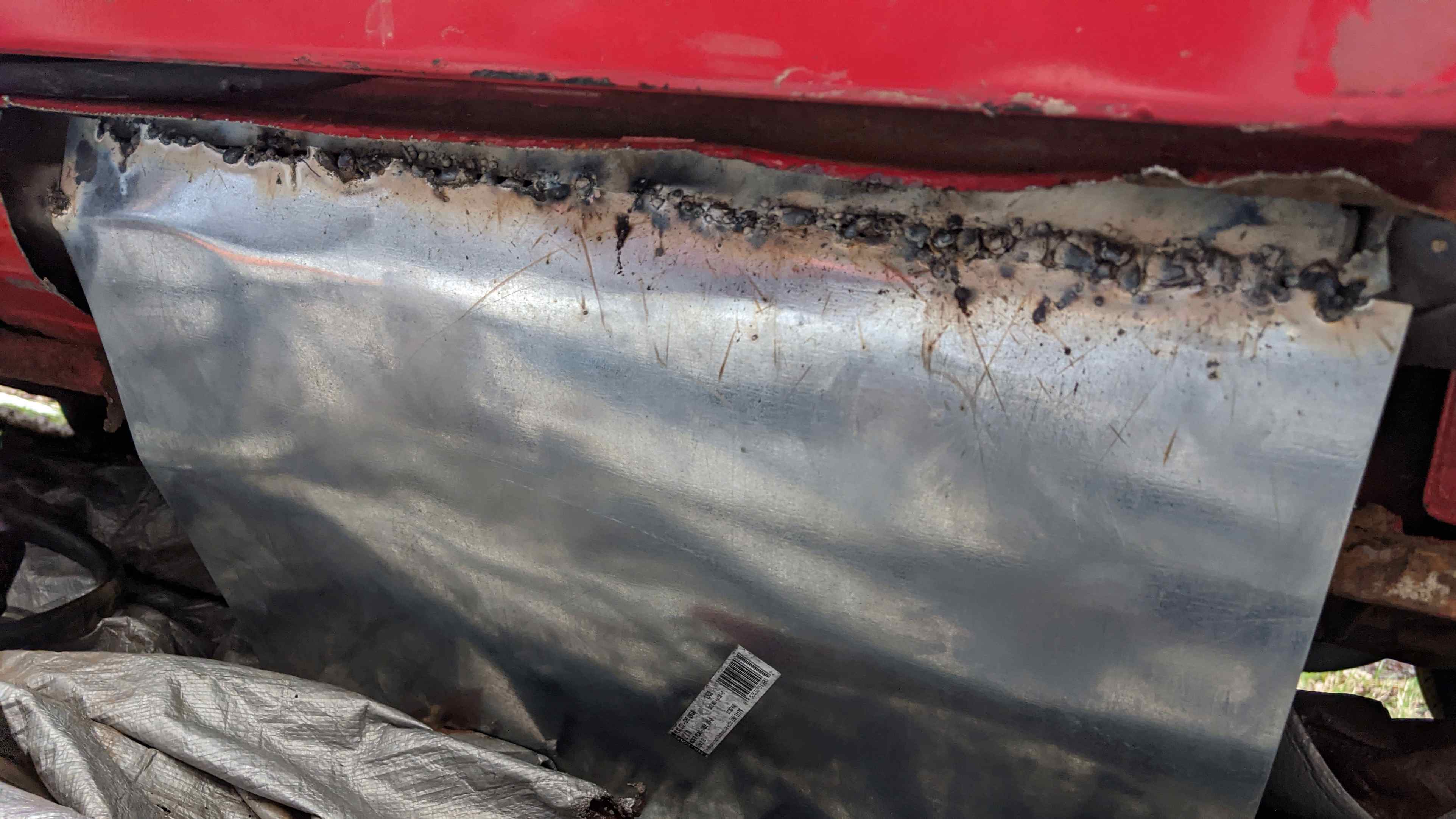

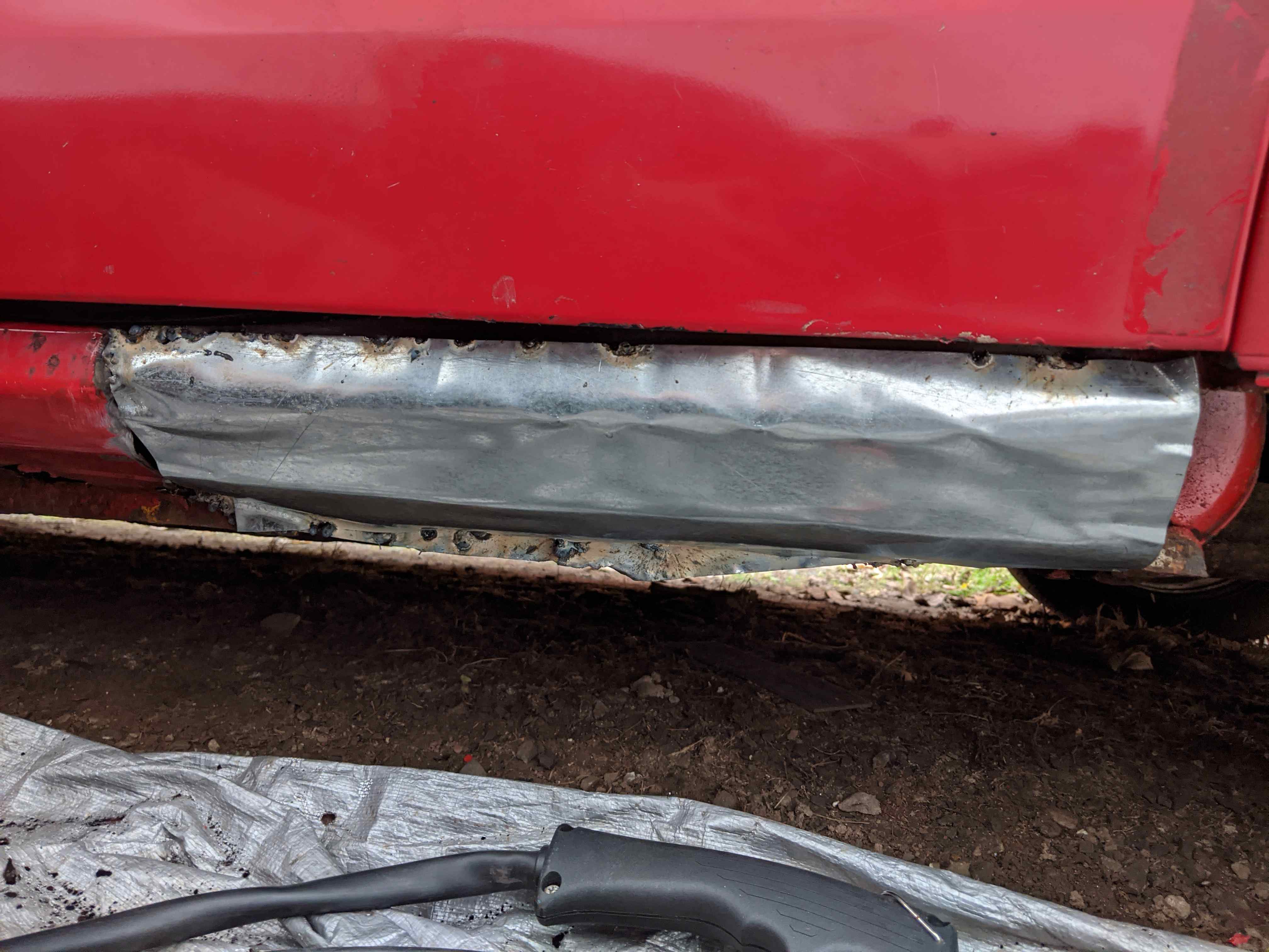

The rocker saga continues! Found some nice weather and got the welding on the driver's side finished up. It's not pretty, but bondo and paint make me the welder I ain't!
For a first time really doing any metal fabrication and welding, and without many of the proper tools and doing it outside, I think it turned out okay. I also took dimensions and made some CAD sketches for anyone looking to have replacements made. I can also add the 3d files and measure for the rocker cover holes if there's demand for it, right now it's just the solid bent sheets with a bent over end cap in the drawings.

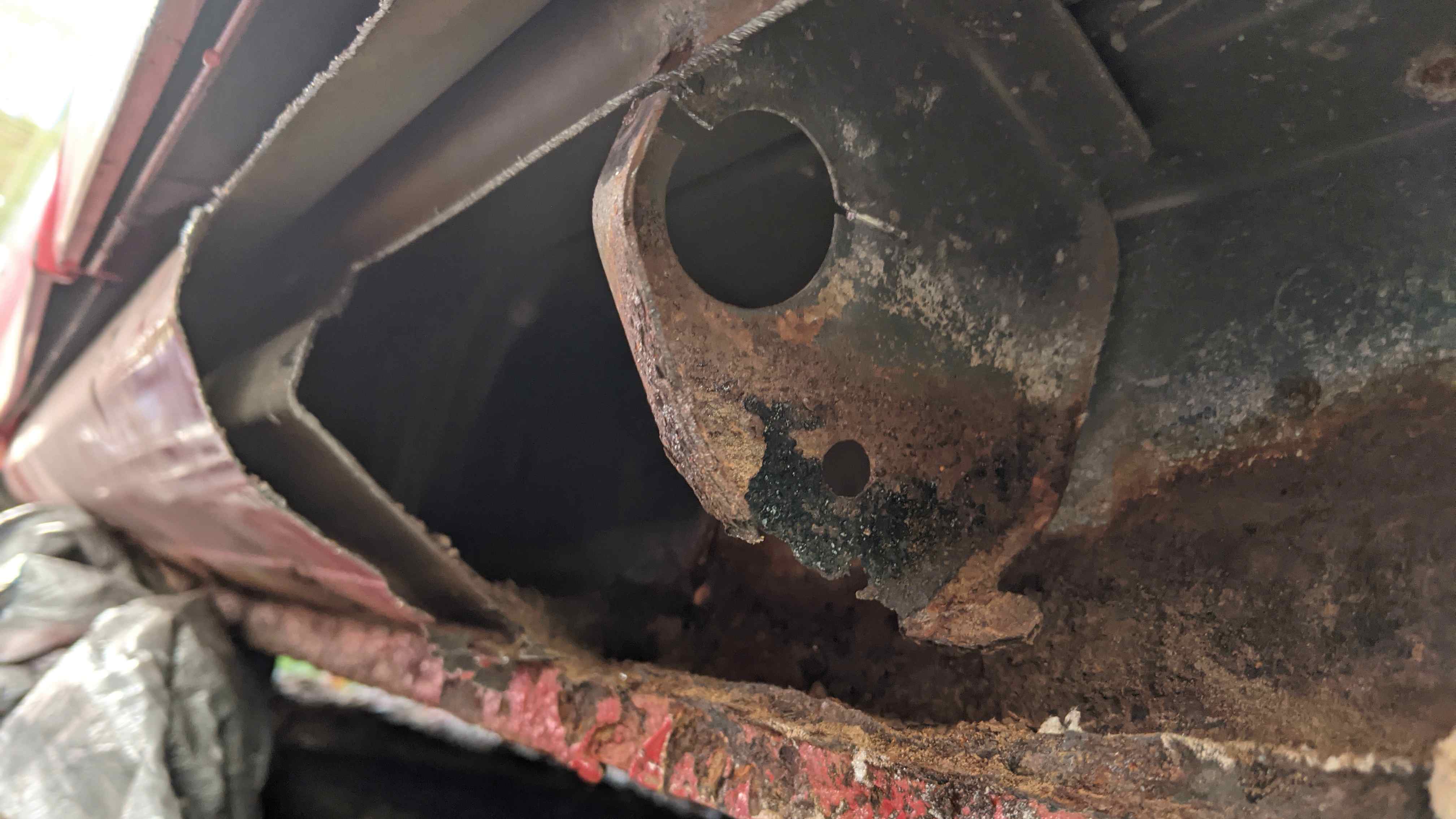

Upon starting the passenger side, initially it didn't look as bad until my fingers slipped off the pinch weld and went through the body just inside of it and into the rocker cavity. Some more feeling around and it runs almost the length of the car. Without a hoist it's nearly impossible for me to weld, so the plan there is to 3D print some custom dimensioned "angle iron" to JB weld to the pinch weld and other side of the hole, then bondo and undercoat it so it blends in with the rest of the car. As much work as there is still to be done, the end is almost in sight!

Now that the weather is warming up, I'm getting ready to finish up the other side and finally get this car on the road. I have run into a slight issue, however. Just inside the pinch weld on the passenger side of the car, there's about a two inch gap rusted between the metal of the underside and the pinch weld. This gap runs almost the full length of the car. Any ideas on how to patch that one? I don't have access to a lift or even much of a jack, so welding is going to be a last resort and fairly difficult to reach.
