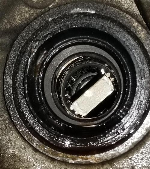

https://i.imgur.com/OS1My2i.jpg

What I see in that pic looks normal to me. There is a bar that runs across the interior that acts as the shaft for the side gears in the differential stage of the tranny.

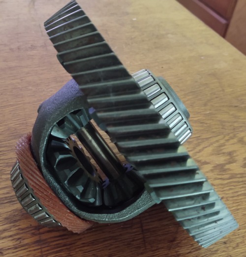

For example, here is a pic of that, this is from a dead 5-speed manual tranny, but the one in your auto tranny is nearly, if not completely identical

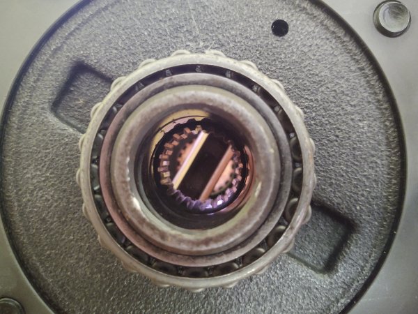

Here is another pic of that looking in where the splined axle slides in, pretty much the same view as in your picture

Thanks for the pics... I had thought about the pin originally, but what is obstructing mine is square (or rectangle) but more importantly it's sitting just on the opposite side of the female splines in tranny so the driveshaft won't go in far enough for the split ring to engage... the drive shaft at full insertion is still at least 1" of where it would be fully seated.
Is there anyway that pin could move closer to the splines?
Could the differential have moved closer to the opening?

There is nothing in your picture that screams to me that there is an obstruction.
One of the easiest ways I have found to get that circlip to compress and go through the splines is to center it using some grease, and put the open end of it downward. You should then be able to slide it into the trans with relative easy.
Once it's in the trans, are you able to lightly tap the end of the axle with a hammer to finish getting it seated?
The object in your picture looks to be as joatmon described, and looks to be far enough into the trans that it wouldn't stop the axle from fully seating.
