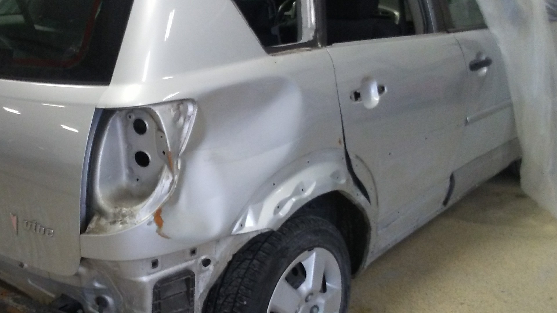

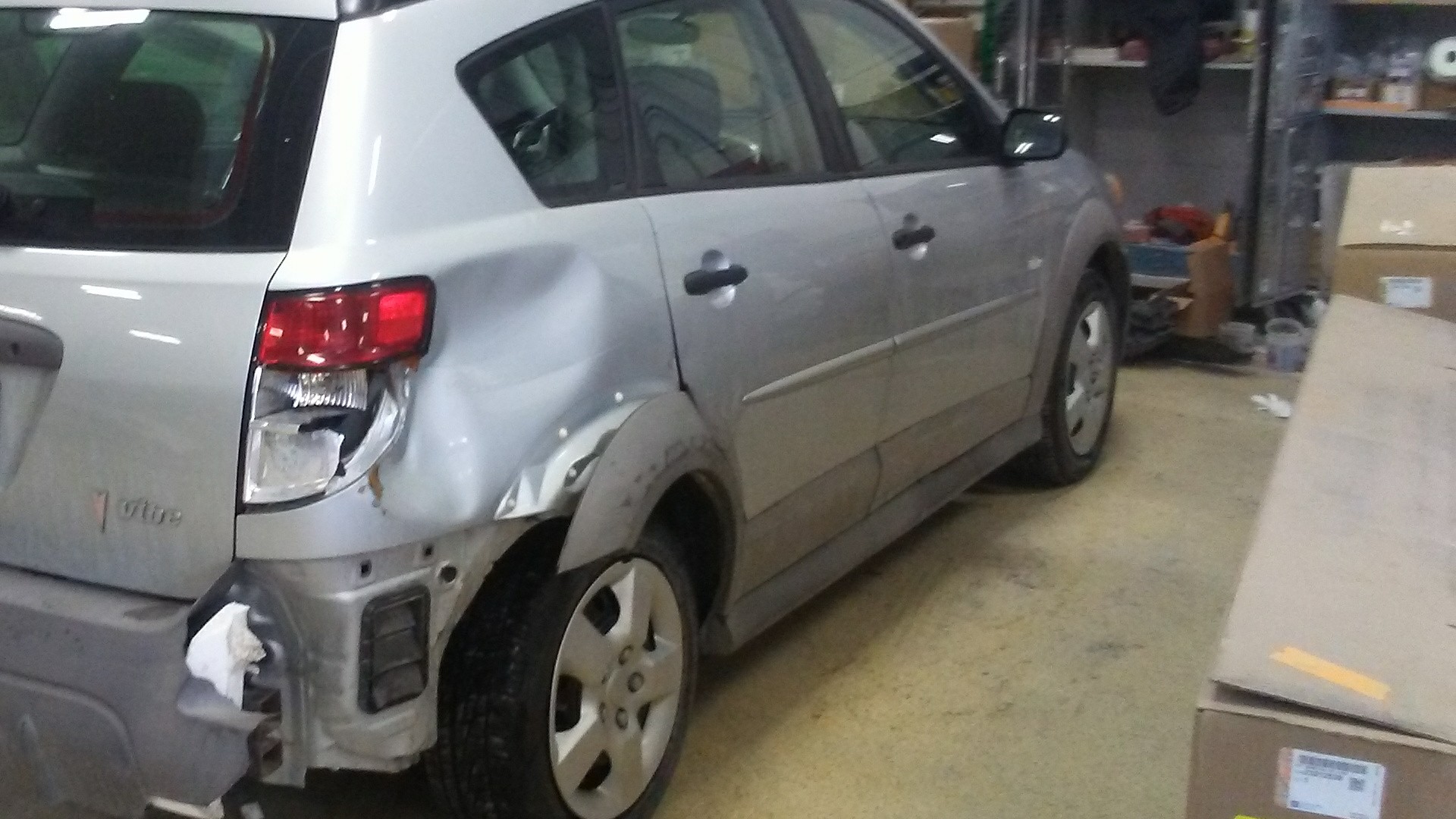

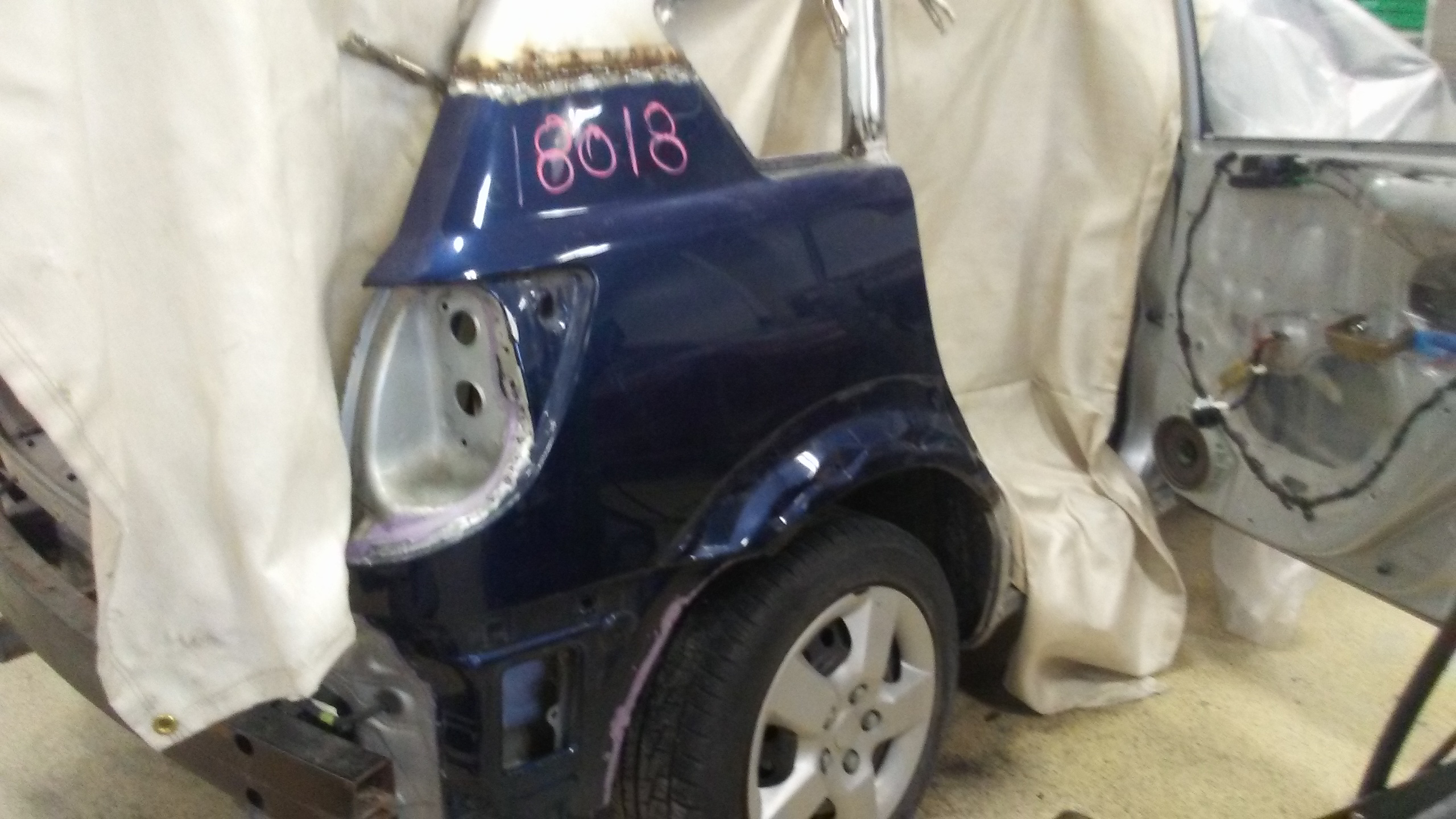

07 vibe I repaired at work
Posted: Wed Jan 08, 2020 4:28 pm
by lavaman

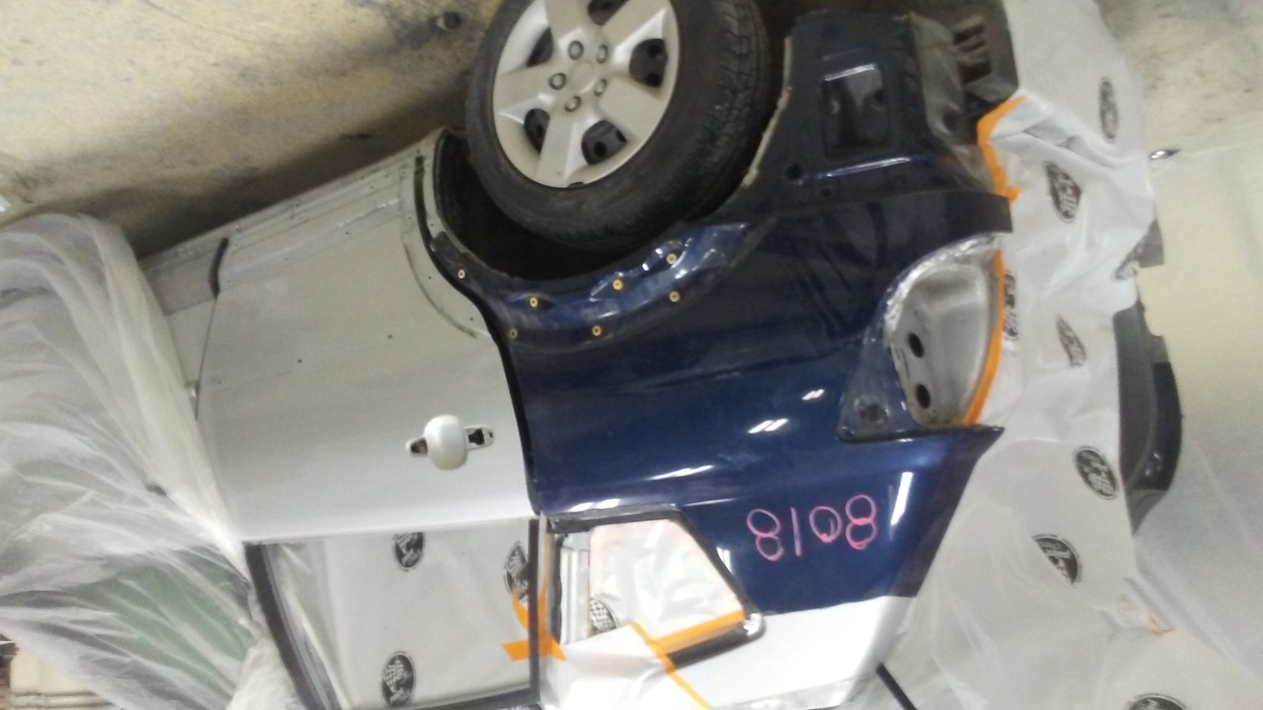

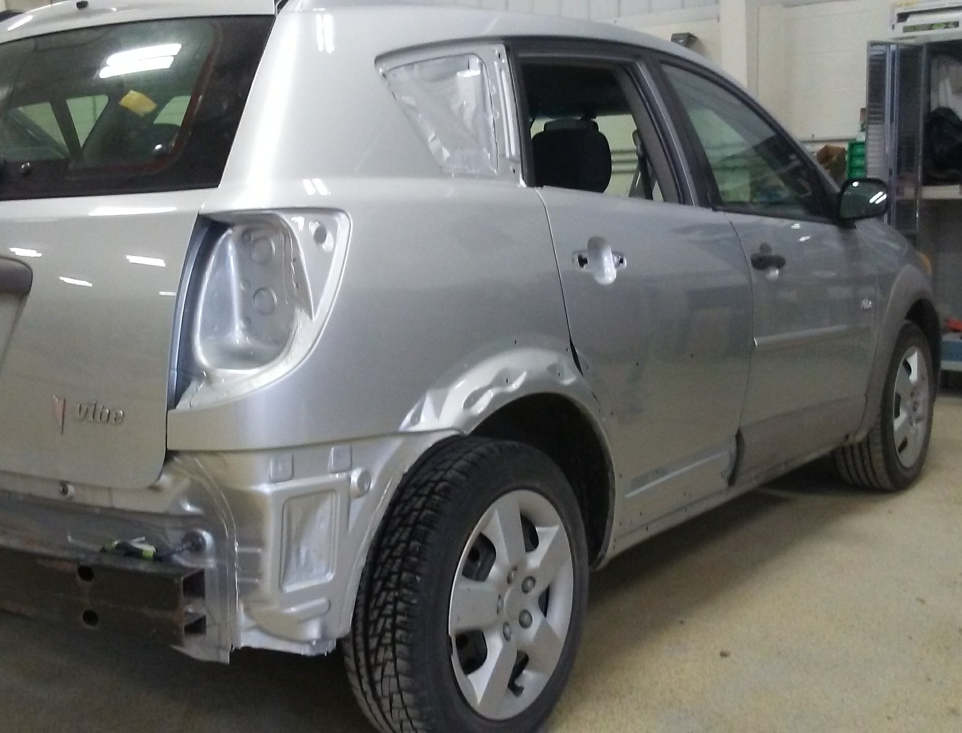

The damaged vibe
The damaged vibe
Re: 07 vibe I repaired at work
Posted: Wed Jan 08, 2020 4:32 pm
by lavaman

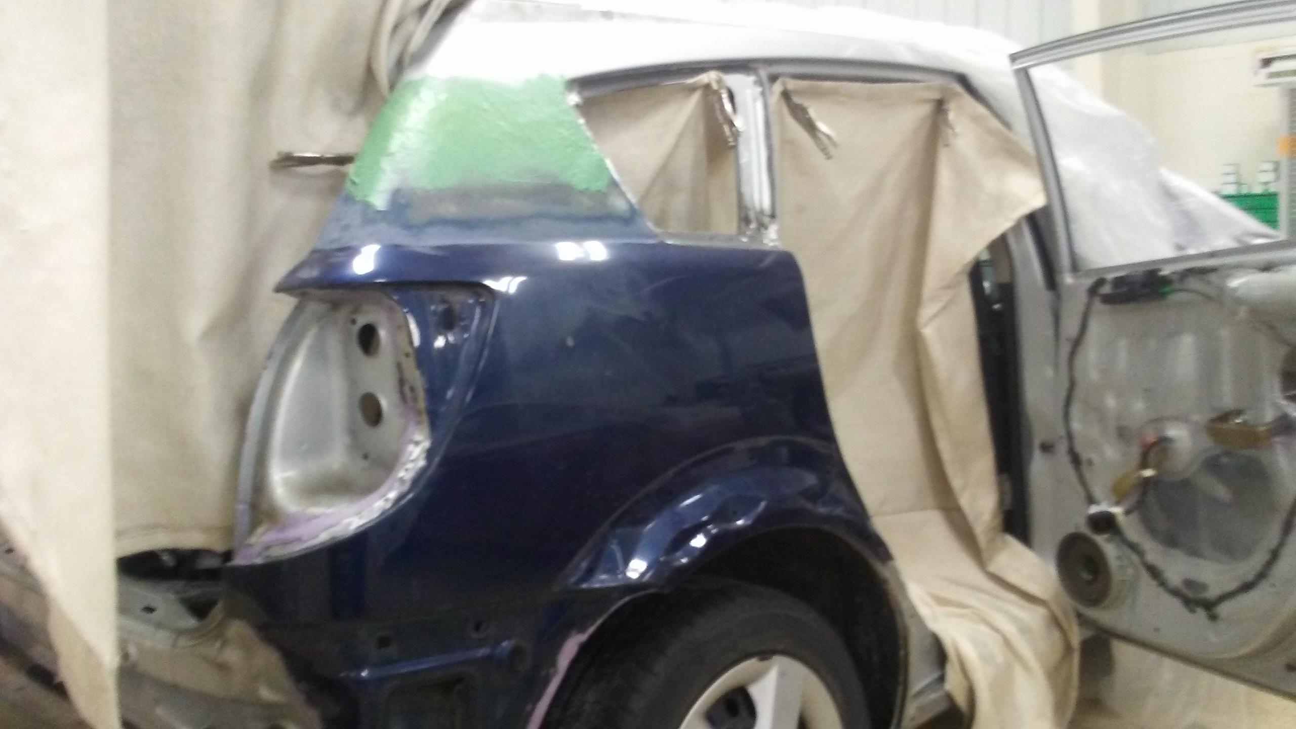

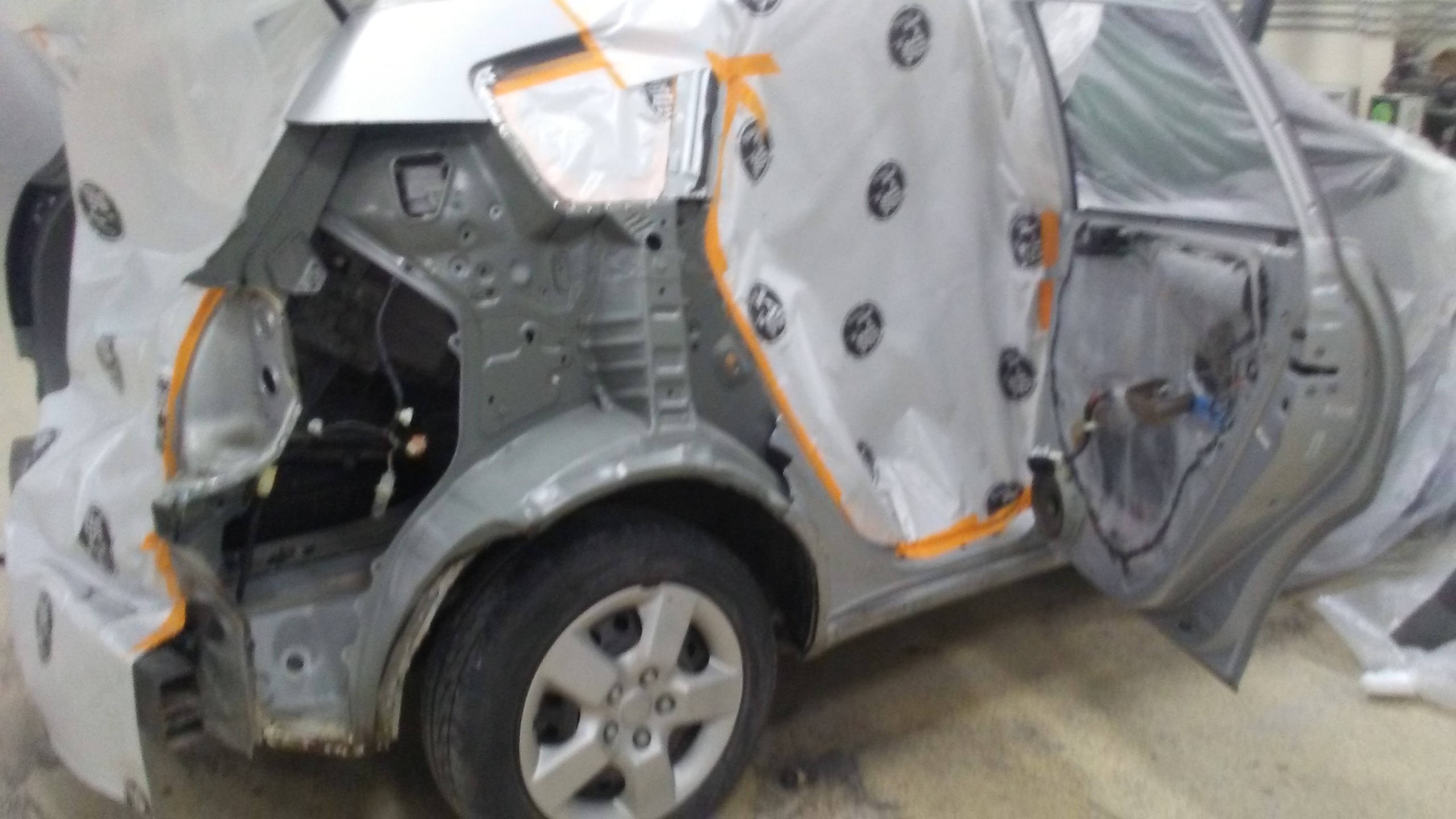

Initial disassembly
Initial disassembly
Posted: Wed Jan 08, 2020 4:34 pm
by lavaman

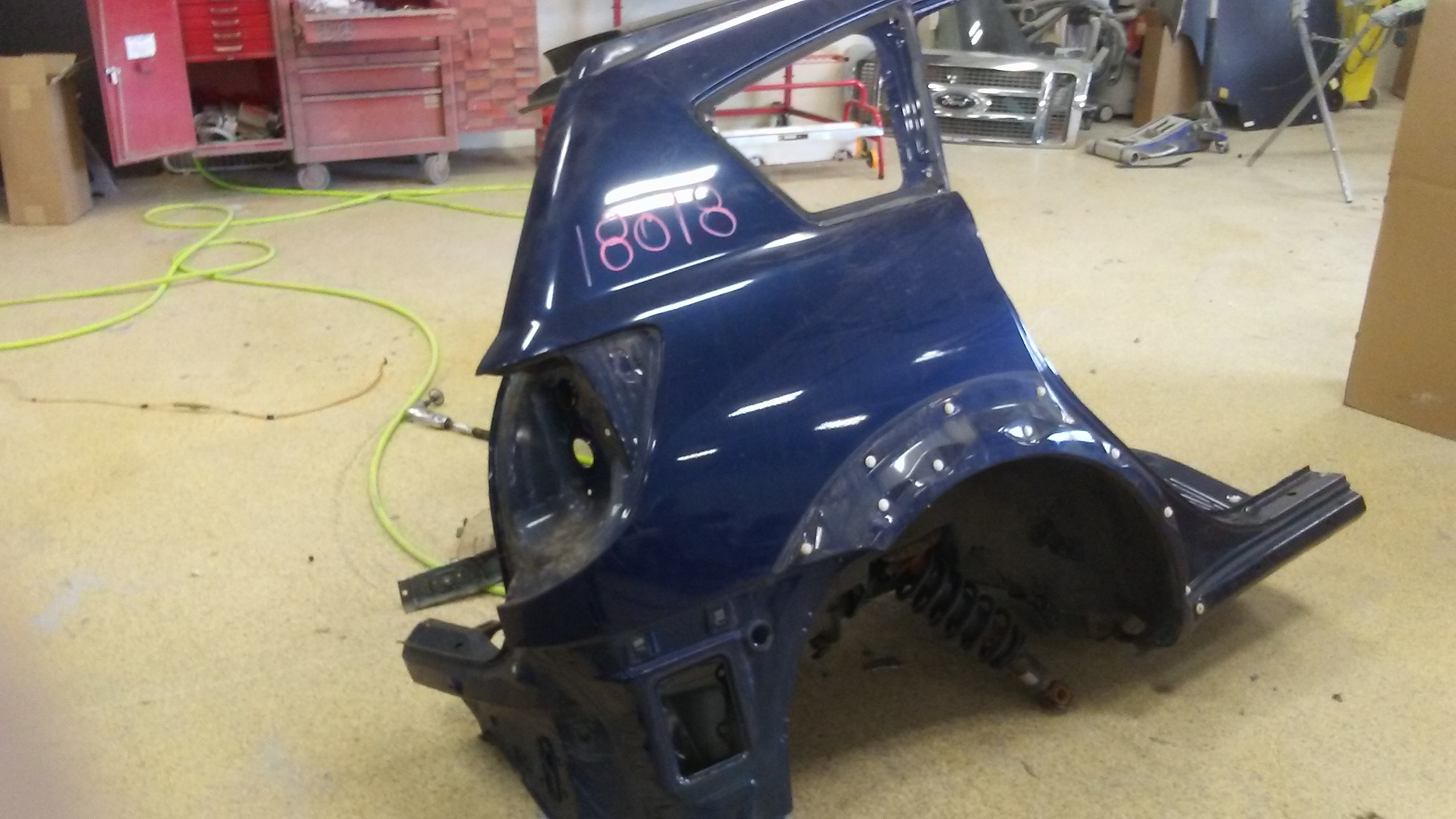

Used replacement section
Posted: Wed Jan 08, 2020 4:41 pm
by lavaman

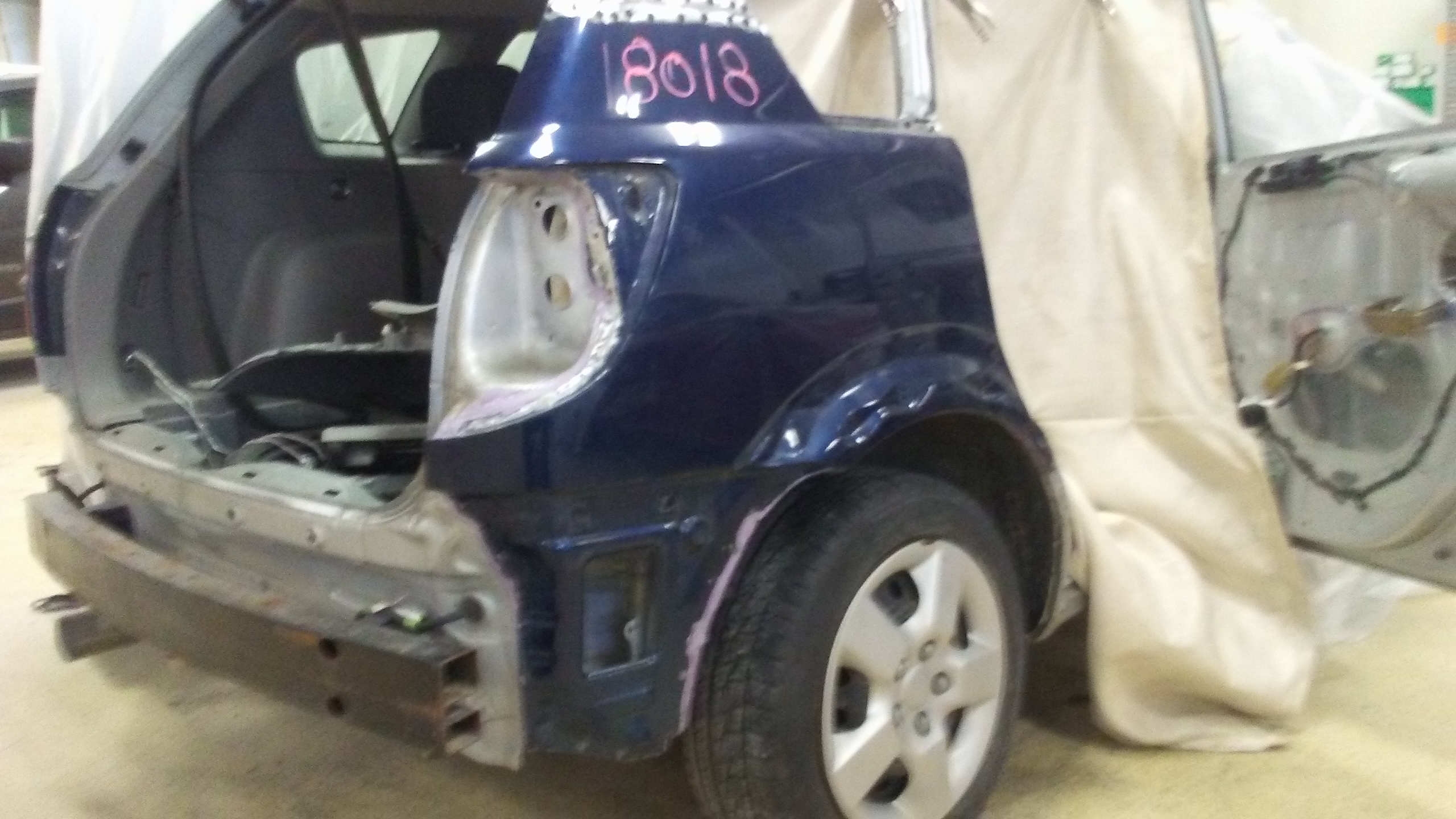

Damaged panel removed
Posted: Wed Jan 08, 2020 4:52 pm
by lavaman

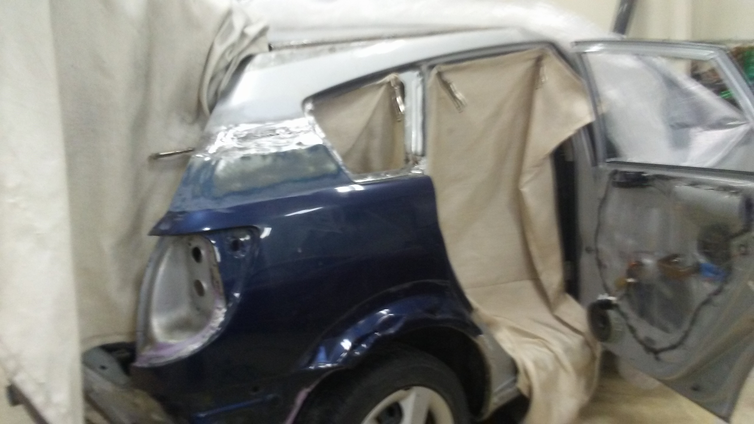

Initial test fit
Initial test fit
Posted: Wed Jan 08, 2020 4:56 pm
by lavaman
Adhesive applied & panel screwed into place
Posted: Wed Jan 08, 2020 4:58 pm
by lavaman
Joints welded
Joints welded
Posted: Wed Jan 08, 2020 5:01 pm
by lavaman
Welds finished
Welds finished
Posted: Wed Jan 08, 2020 5:04 pm
by lavaman
Filler applied
Filler applied
Posted: Wed Jan 08, 2020 5:08 pm
by lavaman
Filler & other surfaces finished
Posted: Wed Jan 08, 2020 5:10 pm
by lavaman

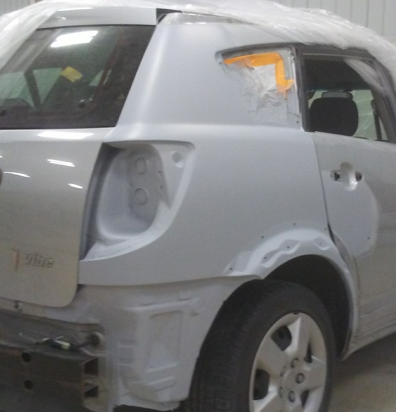

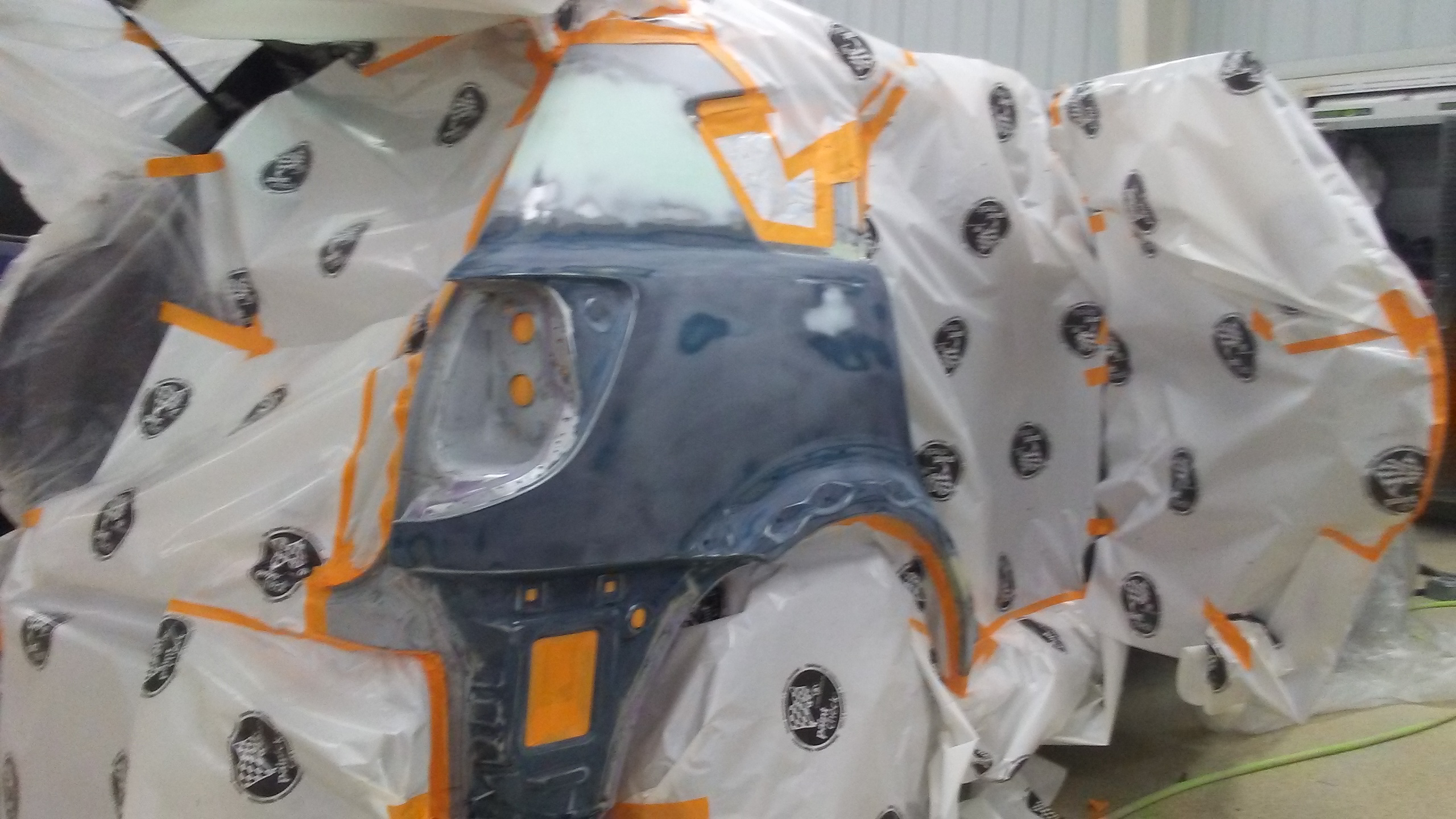

Primer applied
Primer applied
Posted: Wed Jan 08, 2020 5:13 pm
by lavaman

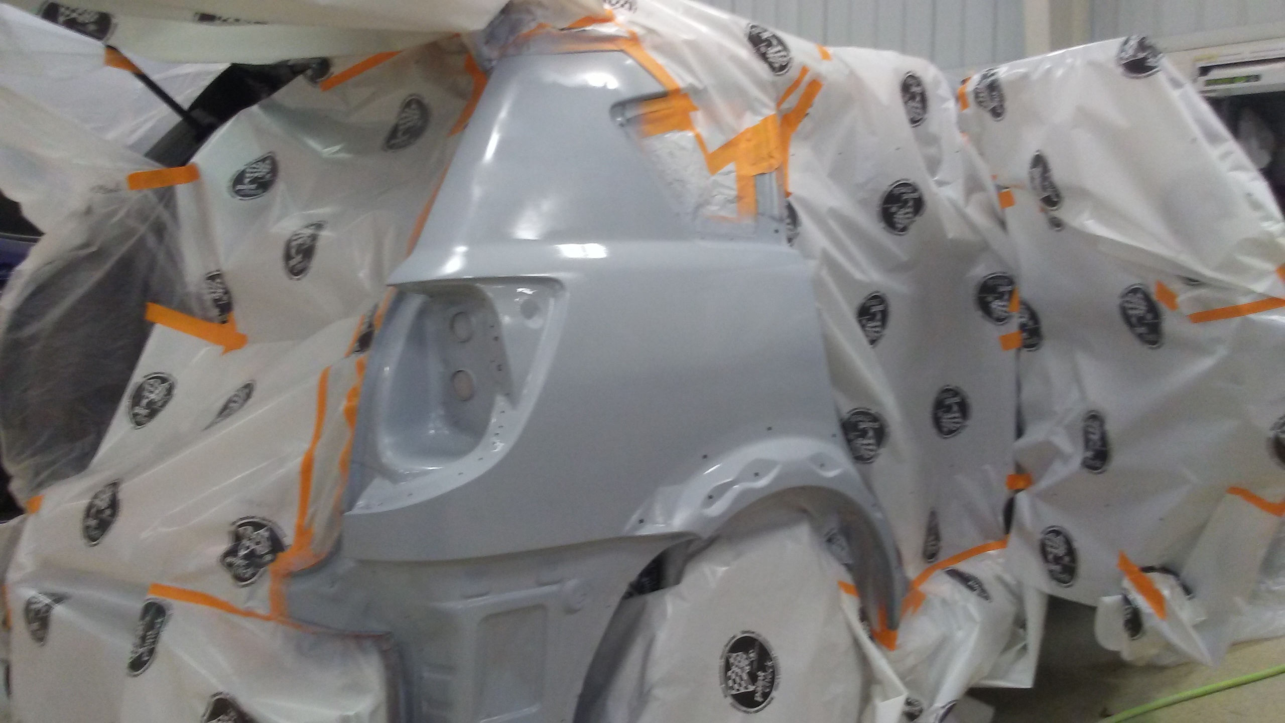

Headed to the paint shop
Posted: Wed Jan 08, 2020 5:16 pm
by lavaman
Back from the paint shop
Posted: Wed Jan 08, 2020 5:19 pm
by lavaman
Another vibe saved
Another vibe saved

Thanks Jeremy, I grew up in a body shop. I've been doing this since I was about 10 so I guess that's been about.......47 years. I actually tried to buy this super clean 93,000 mile 07 before I started on it, but the owner loves his vibe as much as the rest of us love ours. I get assigned all the vibes that come through our shop because of my love & knowledge of them

SlammedNiss wrote: ↑Thu Jan 09, 2020 1:37 pm So lavaman, how long did this repair take from start to finish?
It's been over a year ago, but if I remember correctly it took me a little over a week, along with working on other smaller projects
Posted: Thu Jan 09, 2020 6:21 pm
Also, in addition to that question, what would this have cost the average consumer?
Posted: Thu Jan 09, 2020 8:02 pm
by lavaman
tpollauf wrote: ↑Thu Jan 09, 2020 6:21 pm
I don't remember the exact amount, but I do remember that I found scuffs in the wheel flare & the lower rear door molding which were in the neighborhood of $600 & $800 respectively from G.M. -- yes that's right, for anyone who hasn't priced these pieces -- & since I had already begun repairs, the insurance company went ahead & bought them. Had it been noticed during the initial estimate, the car would have totalled. I'm guessing the final bill was between $3000 & $4000
