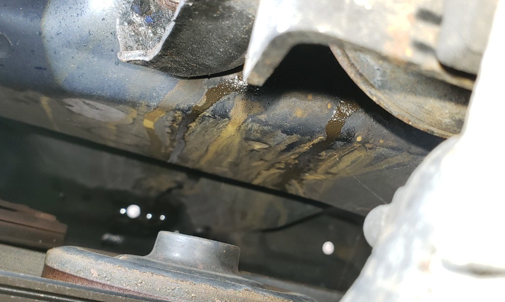

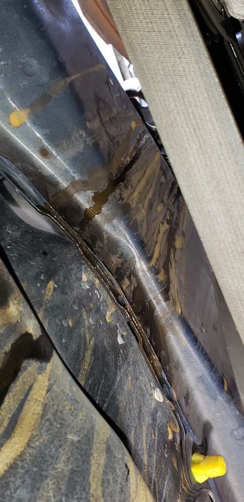

The starter died on the Vibe. As I was crawling underneath to check some things out, I noticed a lot of fluid on the passenger side splash shield running down from above. Really nasty looking fluid. :shock:

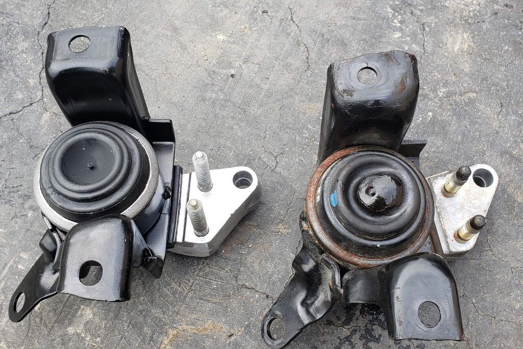

Traced it up to the right engine mount. Sure enough, I could squeeze the rubber piece underneath the mount and fluid would leak out of it. I've never seen one of these die before, it was interesting...

Apparently these mounts are "liquid-filled" to absorb vibrations. And just like everything else on this car, the rubber that holds the liquid in has deteriorated, so it can't hold in its liquid. :D

Looking at replacements, the right front mounts say "Hydraulic" in some of the descriptions. Looks to me like the mounts for the other locations might just be rubber, idk. It's definitely busted and leaking *something* on this one. ¯\_(ツ)_/¯
Ordered a Beck Arnley mount, the few reviews of it I found were generally favorable. I'll post pics of the broken one when I'm done changing it out.

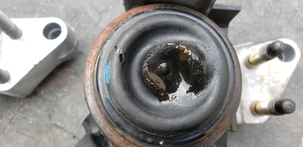

Finally replaced that mount today. That thing was smoked!
Closeup of the tear and fluid leak. I later ripped it open further, there was no fluid left in there.

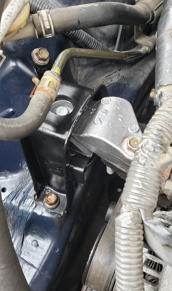

Done! Piece of cake.
The Beck Arnley mount (P/N 104-1736) seems to be of good quality and the fit was perfect. Took her down the road, so far so good. I *think* that even resolved the clunk I was hearing when accelerating from a stop. Haven't driven the car for a month because of this broken mount, it's nice to be behind the wheel of the Vibe again. 8-)
